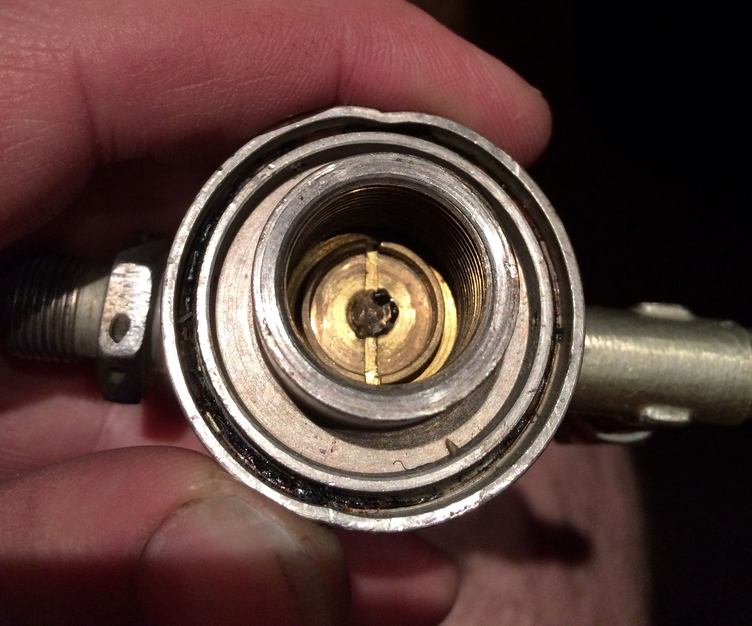

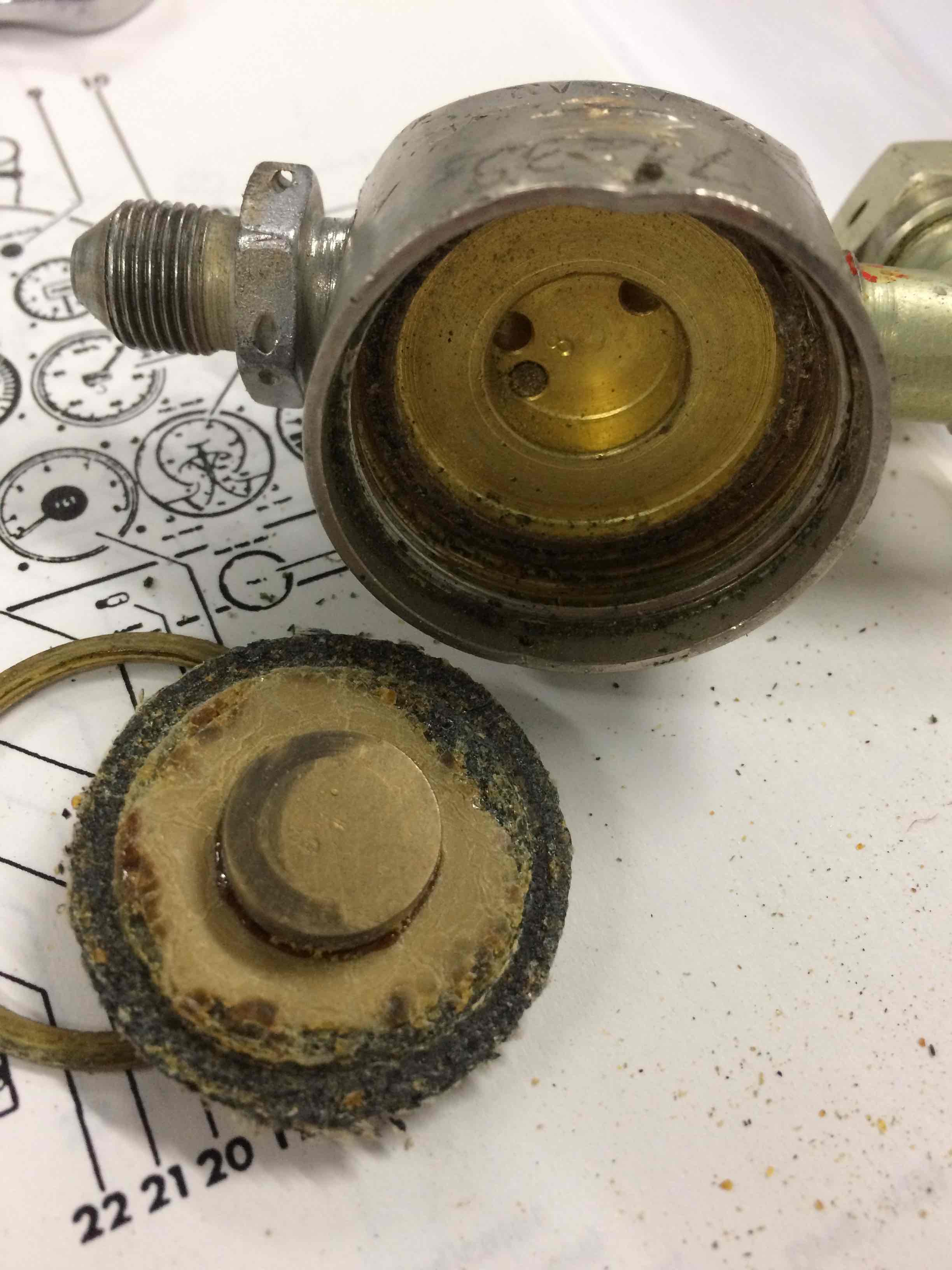

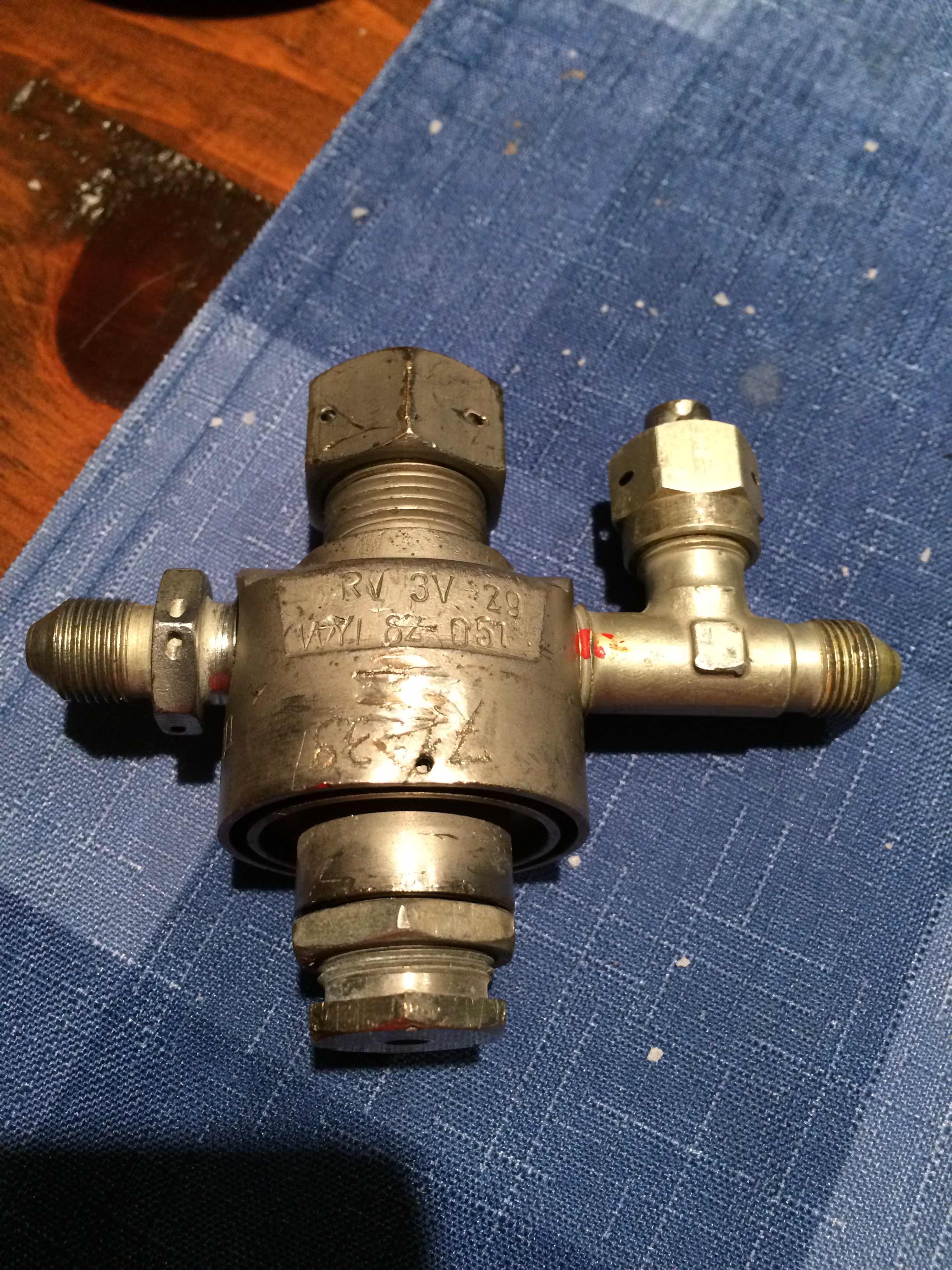

fougapilot
Joined: 20 Jul 2007
Posts: 89
Location: Flat on my back with minimum airspeed
PostPosted: Thu Mar 23, 2017 4:29 pm    Post subject: Re: Reduction valve Reply with quote
Here you go.
Picture of the valve... don't tell my wife I had it on the kitchen table Wink
Picture of the open and dirty part that is leaking.
D

PostPosted: Sat Mar 25, 2017 9:12 pm    Post subject: Re: Reduction valve Reply with quote
Mine leaked also, would lose all pressure within 2 hours. You can open it and replace the round diaphram with rubber from a raft patch kit. Mine was hard and flaking apart inside. Take lots of photos, there 2 pins inside that have to go back in the same way.

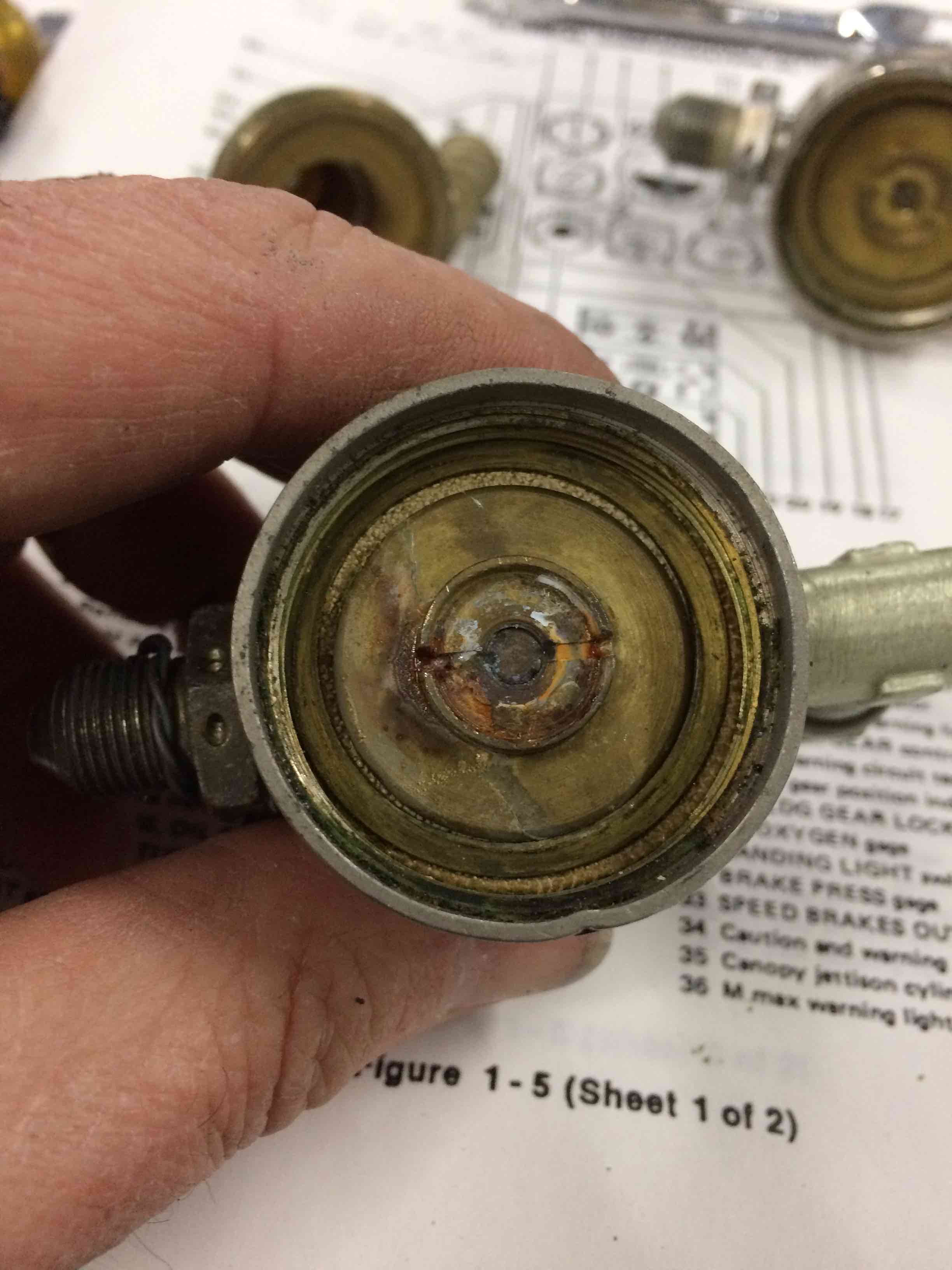

fougapilot
Joined: 20 Jul 2007
Posts: 89
PostPosted: Mon Mar 27, 2017 9:00 am    Post subject: Re: Reduction valve Reply with quote
That is exactly what is happening to me. The "seal" is all dried out.
I am glad to know it can be changed. Would you remember any details that could help out? More specifically the thickness of the rubber you used? And how did you remove the current seal?
I will definitely take many pictures to make sure I can rebuilt the proper way.
Here are a few ones of the actual seal when you open the valve.
D

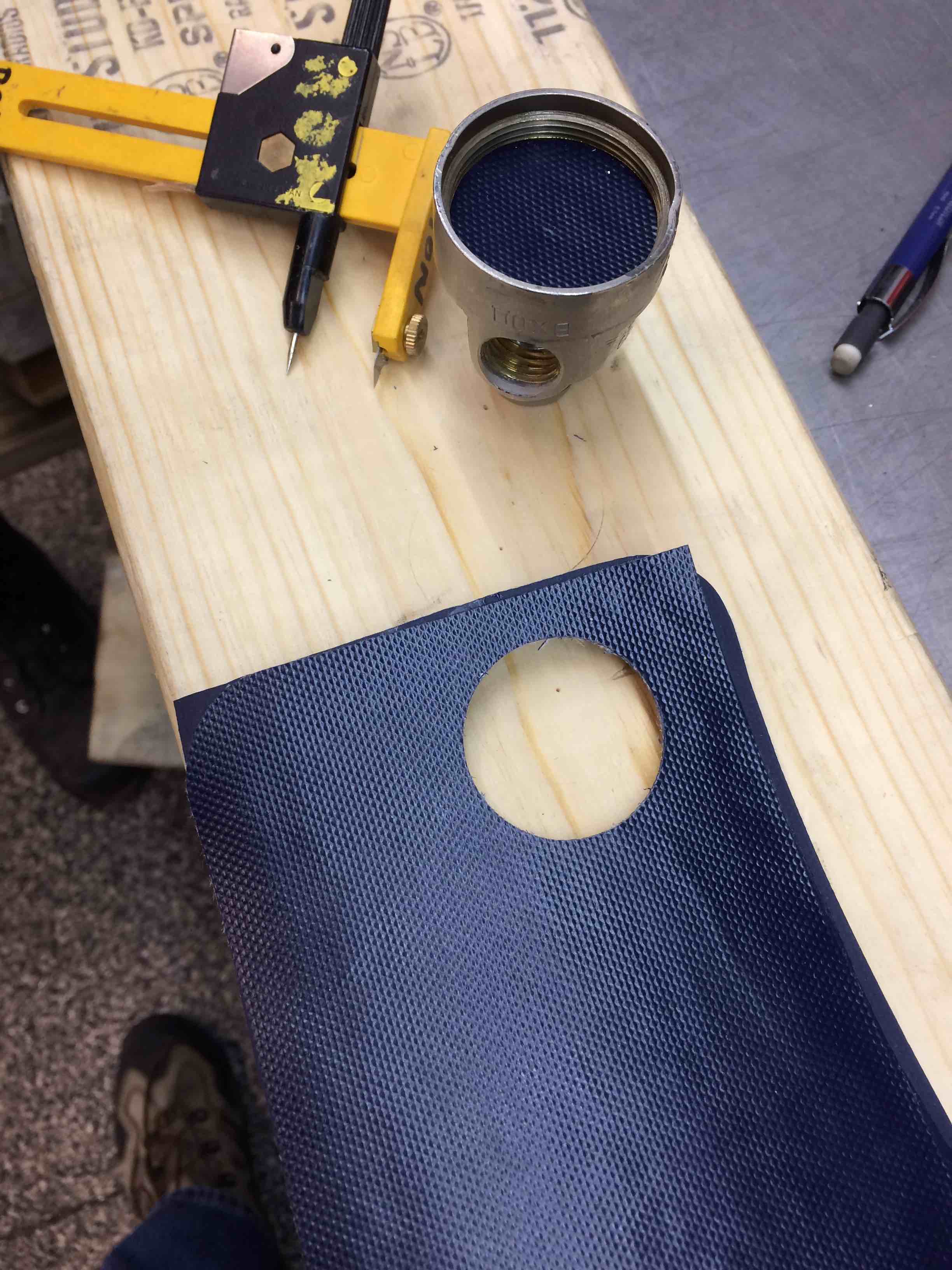

PostPosted: Mon May 15, 2017 2:09 am    Post subject: Re: Reduction valve Reply with quote
I used a Zodiak repair kit. You can find them at most marine shop for about $20. The patches are Kevlar reinforced, so it helps in holding the pressure. The valve on my rear canopy has been holding at 40atm for about a month now.
I needed to glue two layers of patch to get the proper thickness. And it took quite some time to produce the first seal. The patch is difficult to cut and we wanted to be sure we got the circle right. It basically took me a day to make the seals alone. I did 3, so now I have a spare.
D
