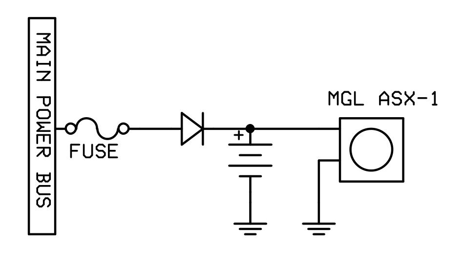

How about this circuit?
Small rechargeable lead acid batteries are available that weigh less than 1 pound.
http://www.zbattery.com/Batteries/List-of-All-12Vs

What I would do. Don't forget an on/off function between aux. battery
and load (not drawn).
Jan de Jong

You could connect 11 of NiMH AA or AAA cells and 2 diodes all in series. But not much weight will be saved over a small lead acid battery. The more connections there are, the greater the chance of failure. Those AA battery holders with springs are prone to fail. Pre-made 13.2 volt NiMH battery packs are available for an outrageous price.
Don't forget an on/off function between aux. battery and load (not drawn).
Good idea.

This sealed lead acid battery weighs 12 oz.
Use a schottky diode to minimize voltage drop.
http://www.zbattery.com/Power-Patrol-12v-800mAh-Sealed-SLA1000?sc=2&category=62965
