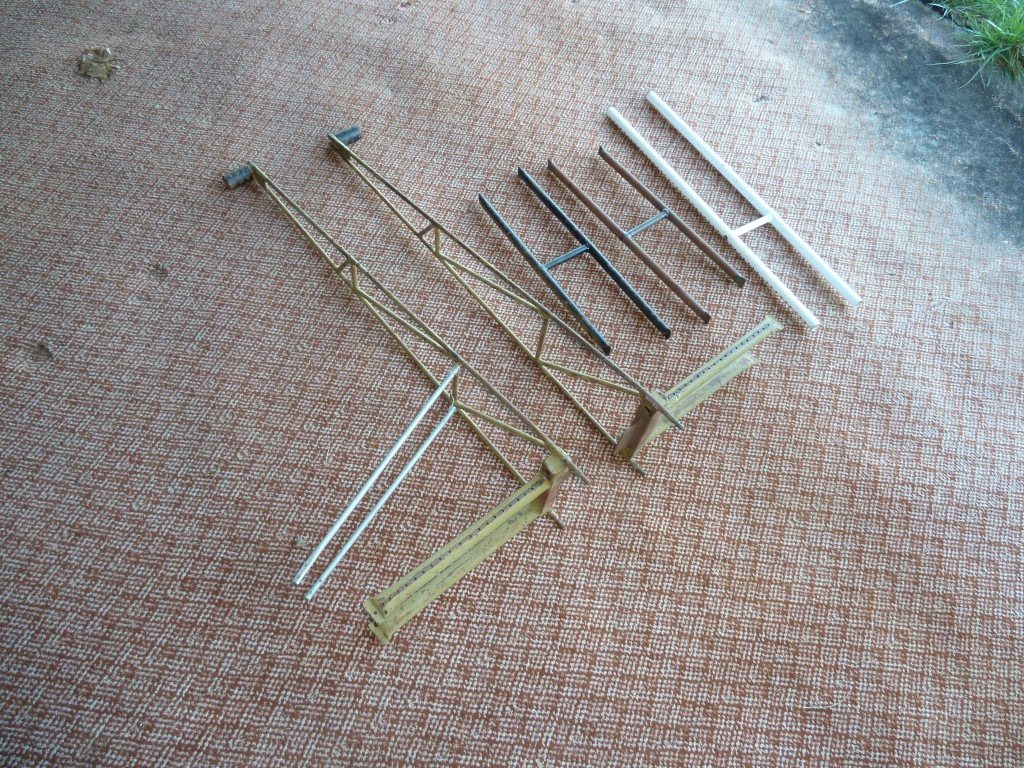

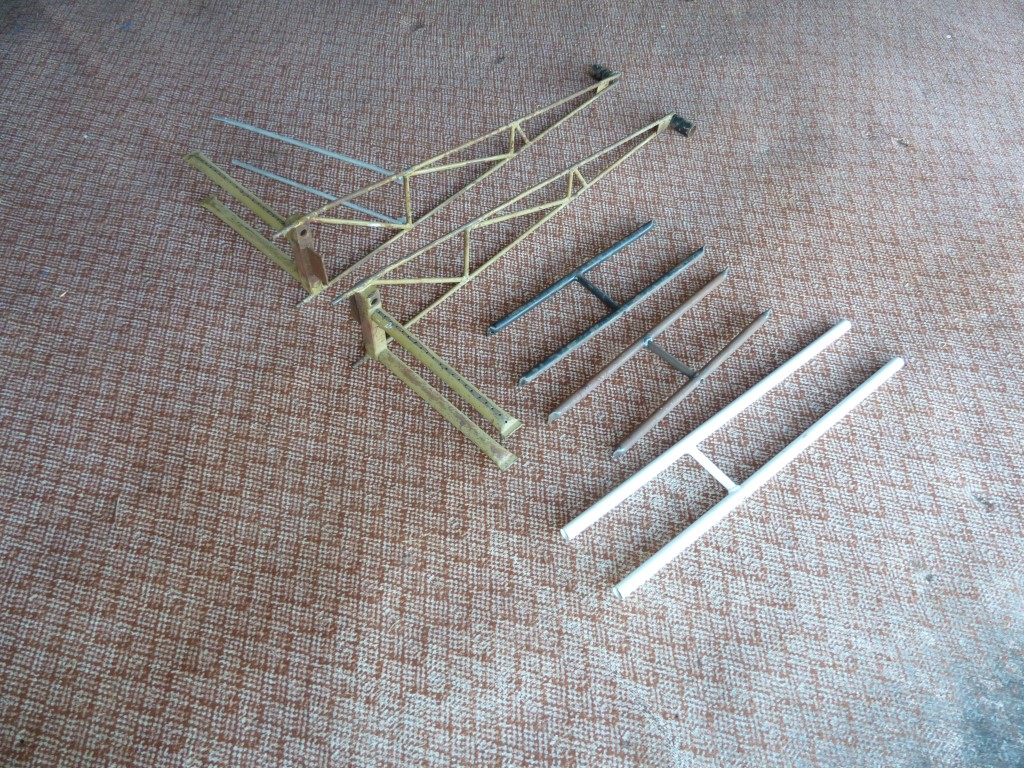

Not sure, but I think these might be US parts. Welcome to them if you want them.
 Filesize:  399.81 KB
 Viewed:  8865 Time(s)
 Filesize:  433.06 KB

Yep...That is what I removed them from...the root ribs ...but not the h
sections...the other h section was from a boom tube ...Herb
