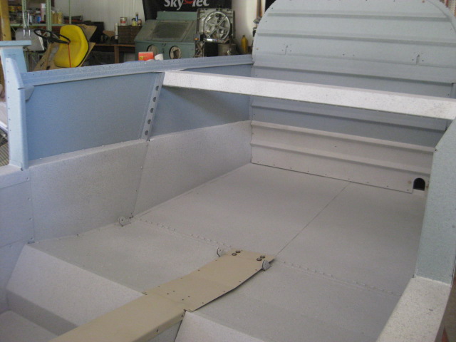

I've only used a few Stewart products ..... They're OK.  However I went with Zolatone.  It's water based also.
[img]cid:part1.FBAA27A5.FCC4DACA(at)cfl.rr.com[/img]
