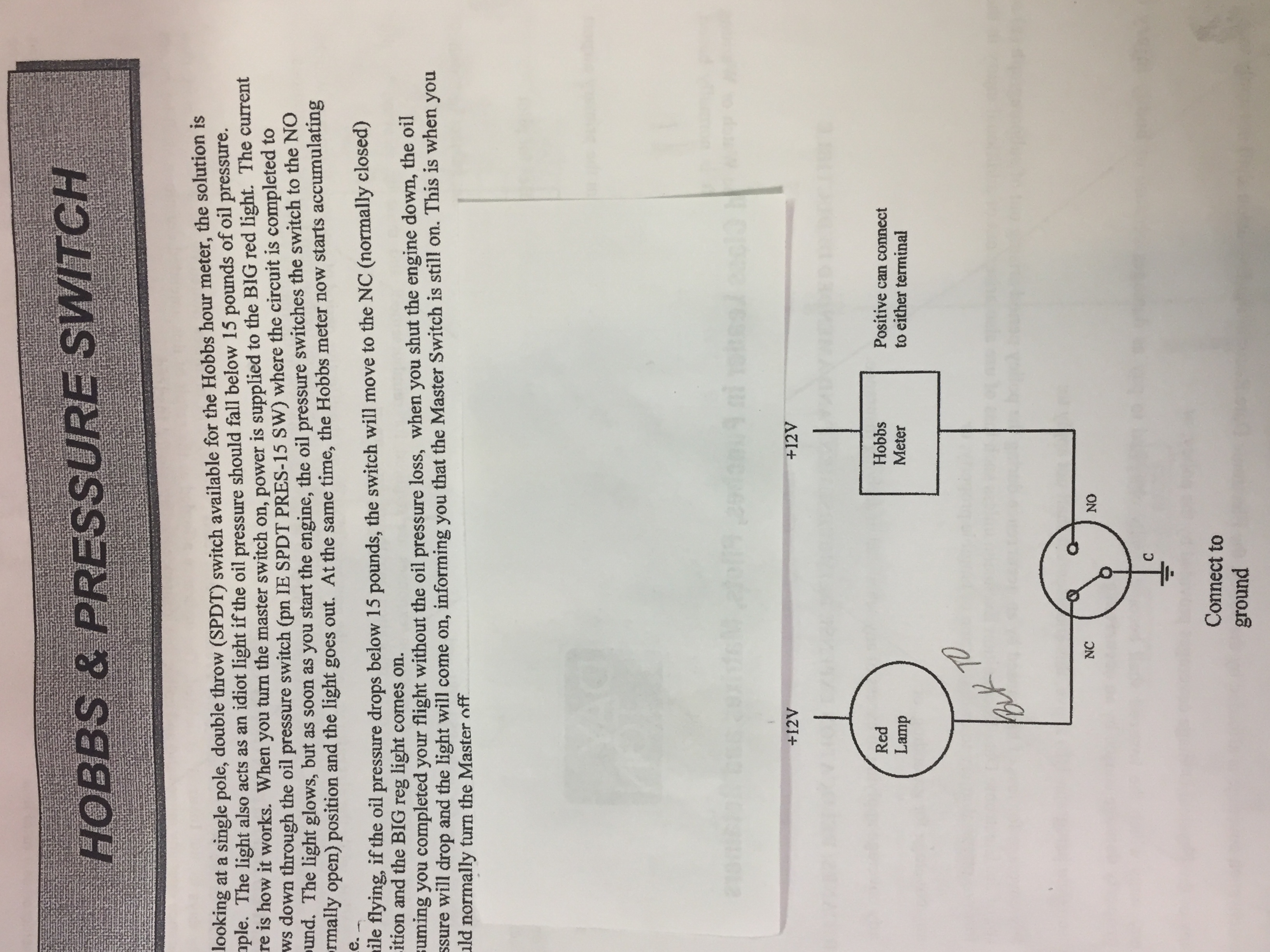

Although I have this engine time on my GRT EIS I would like to have this already installed additional system on my RV-6A which has a zero time rebuilt Lycoming.
I have a master key and start button which I believe should be spliced into the starter switch from the lamp, which being red when engine isn't running will also serve as a reminder to shut it off after the flight.
Then I should wire from the Hobbs meter to my fuse panel. Could someone please confirm for my pace of mind?

You are on the right track if my interpretation of your post is correct. But I can not say for sure until seeing a complete schematic of your proposed circuit including the master switch and battery contactor. A picture is worth a thousand words.

Ron, starter switch is not wired to Hobbs meter.

PostPosted: Sat Mar 11, 2017 5:12 am    Post subject: Hobbs wiring Reply with quote
Joe,
Don't have picture so will try to describe. I have converted from a Subaru back to a Lycoming, so I have a keyed master switch and EFII ignition. The whole system comes alive with the key, but has a switch that bypasses all if necessary.
Trying to tie in a Hobbs bought and in panel but never hooked up before. Now I have the oil pressure activated switch teed into the VDO oil pressure sender for the GRT EIS.
Ron Burnett

Ron,
It doesn't matter where the 12 volt supply comes from
as long as it goes on and off with the battery contactor.
Just connect 12 volts to the hobbs meter and to the
indicator light as pictured in your original post.
This advice is based on the assumption that the switch
in your picture is an oil pressure switch.
Joe Gores

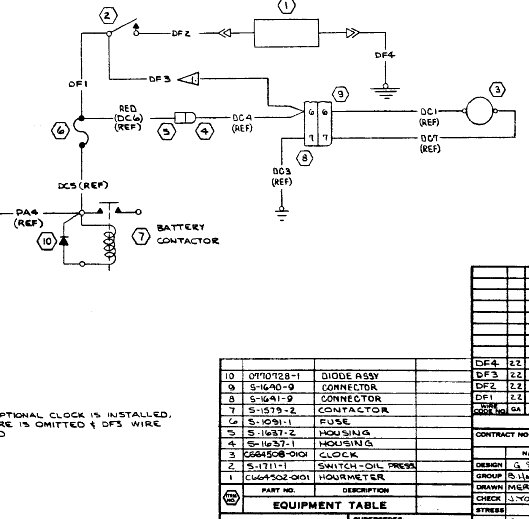

At 09:31 AM 3/11/2017, you wrote:
--> AeroElectric-List message posted by: Alec Myers <alec(at)alecmyers.com>
Most TC aircraft Hobbes meters don't get switched via the battery master. Too easy to hide time by flying with the master off.
Correct. Most folks are unaware of the fact that
tens of thousands of Cessnas had an always hot
battery bus right at the battery contactor. It
feed two fuses . . . one for the Hobbs meter controlled
through an oil pressure switch . . . the other for
the electric clock.
If one would like to add a low oil pressure warning
light, then the hobbs feeder needs to drive from
a controlled source. In OBAM aircraft a good alternative
feed is the e-bus.
Now the low oil pressure light (and perhaps warning buzzer)
serves four functions. It monitors oil pressure, it controls
the Hobbs meter to measure ENGINE RUN time, it gives warning
at shut down that both the DC master and E-Bus alternate
feed switches are open.
See . . .
http://tinyurl.com/zlpjzuc
If you have an engine fitted with a PM alternator
(a la Rotax or SD-8 standby) one COULD fabricate a
circuit to watch for the existence of AC voltage
on the alternator winding and use this signal to
control the Hobbs and offer warnings for DC power
shutdown . . . you just wouldn't have oil pressure
warning.
PostPosted: Sat Mar 11, 2017 9:16 am    Post subject: Hobbs wiring Reply with quote
the electric clock
Hmmm . . . not always two fuses . . . seems the 1976
C-172 drove the Hobbs and clock from the same fuse
[img]cid:7.1.0.9.0.20170311111312.055a9338(at)aeroelectric.com.0[/img]
