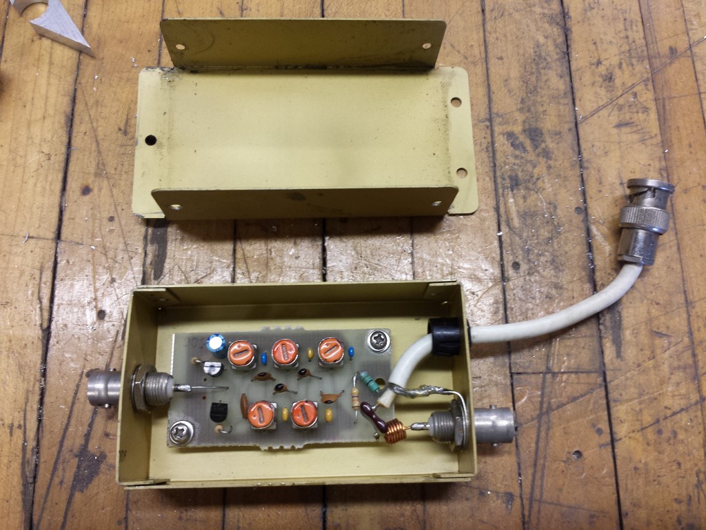

Can anyone positively ID this box? I'm guessing it's a VOR/ILS splitter, but the paper label disappeared at some point in the past. I hate to toss it if I can be confident in what it does.
Charlie

Hopefully it will be attached this time. A multitasker I am not.
Charlie

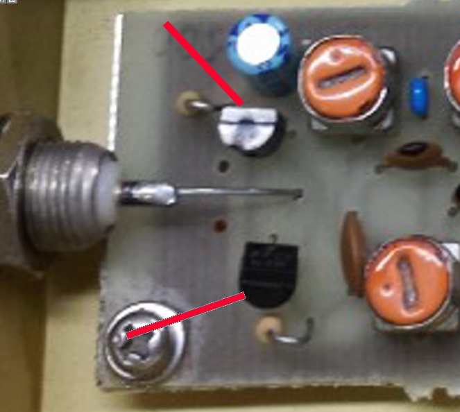

It may well be a VOR/GS splitter . . .
[img]cid:7.1.0.9.0.20170221192723.05404fd0(at)aeroelectric.com.0[/img]
. . . albeit an ACTIVE one. These two devices appear to
be TO-92 case transistors. This means that the critter
needs power via some path . . . which is not obvious
from the photo. The upper and lower sets of tuneable
inductors suggest vhf and uhf band-pass filters.
It would take some time to 'reverse engineer' the
circuitry by inspection . . . then one could bench test
it to ascertain characteristics of the two pathways.
Interesting . . . I've never crossed paths with such
a device before.

ceengland7(at)gmail.com
PostPosted: Tue Feb 21, 2017 6:57 pm    Post subject: mystery coax signal splitter Reply with quote
On 2/21/2017 7:33 PM, Robert L. Nuckolls, III wrote:
At 06:50 PM 2/21/2017, you wrote:
a device before.
  Bob . . . Well, double Duhh...If I'd actually looked at that, I'd have known
better to even send the message. I pulled an ancient LORAN out of the
plane after I purchased it about 15 years ago. I wonder if this could
be residue from that installation. Obviously, it's not a VOR/GS
splitter, so it's very unlikely to be of any use to me.
Thanks for the good eye,
Charlie
PostPosted: Wed Feb 22, 2017 11:06 am    Post subject: mystery coax signal splitter Reply with quote
Well, double Duhh...If I'd actually looked at that, I'd have known better to even send the message. I pulled an ancient LORAN out of the plane after I purchased it about 15 years ago. I wonder if this could be residue from that installation. Obviously, it's not a VOR/GS splitter, so it's very unlikely to be of any use to me.
Aha! Yes. Those components were physically a
bit 'horsy' for UHF/VHF circuity . . . but
I'm at bit puzzled at how it might function
as an add-on to a legacy aircraft. It couldn't
be used to receive on a vhf comm antenna due
to the need to also transmit throught the same
path. A VOR antenna with no frequency dependent
features (like matching sections or baluns)
MIGHT offer some performance at 100KHz LORAN
levels . . . it's a puzzlement.
