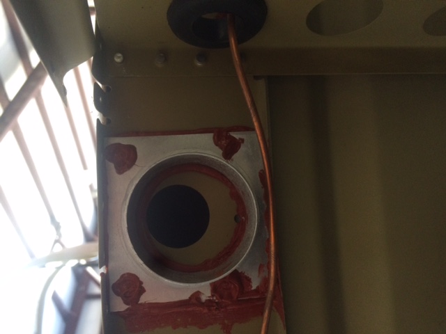

I'm about to close up this aft deck area to prep for the inspection. Before I do, I'm just going over everything one last time.

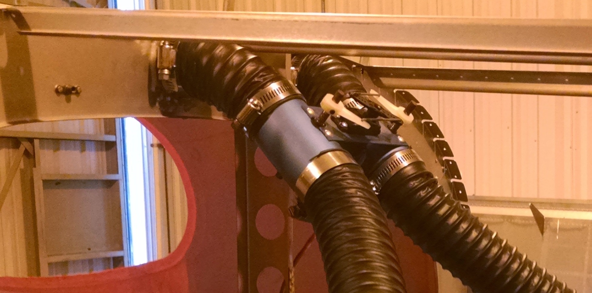

For those if you using the overhead console from Geoff, have any of you had experience with using an undersized hole in the bulkhead? Just curious how the airflow is...
I punched a 1" hole inside the 2" scat connector. I just couldn't bring myself to knocking a 2" hole in that bulkhead.
I also drilled a 1/8" drain hole to let any water drain out. I'll attach a photo so you can see.
I'm just curious if anyone else has done something similar with a 1" hole and I'm most curious about how happy you are with he airflow.
Phil

Phil,I used two 1" holes with 2"X1" bulkhead adapters.  The airflow seems very good to me.
Shannon
