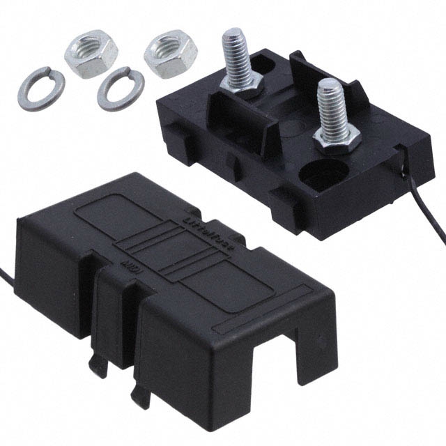

Here one example:
http://tinyurl.com/k4x4bua
Off the shelf holders for these fuses come
in TWO varieties (1) uses 'set screws' to mash
down on the fat-wires, ostensibly capturing
them in the end of the fuse holder . . . AVOID
THESE. (2) uses two threaded posts over which
the fuse is dropped along with the terminals
that bring fat-wires up to the fuse holder. Here's
one example . .
[img]cid:.0[/img]
Obviously, you could make something like this yourself.
Get a piece of phenolic, delrin, lexan, etc, and cut
out a base. Drill 10-32 fuse mounting holes (counter bore
back side for electrical clearance to ground). A couple
more 6-32 attach holes. The cover is more cosmetic than
utilitarian.

PostPosted: Mon Mar 27, 2017 2:34 pm    Post subject: Klixon Circuit Breaker Reply with quote
utilitarian . . .
