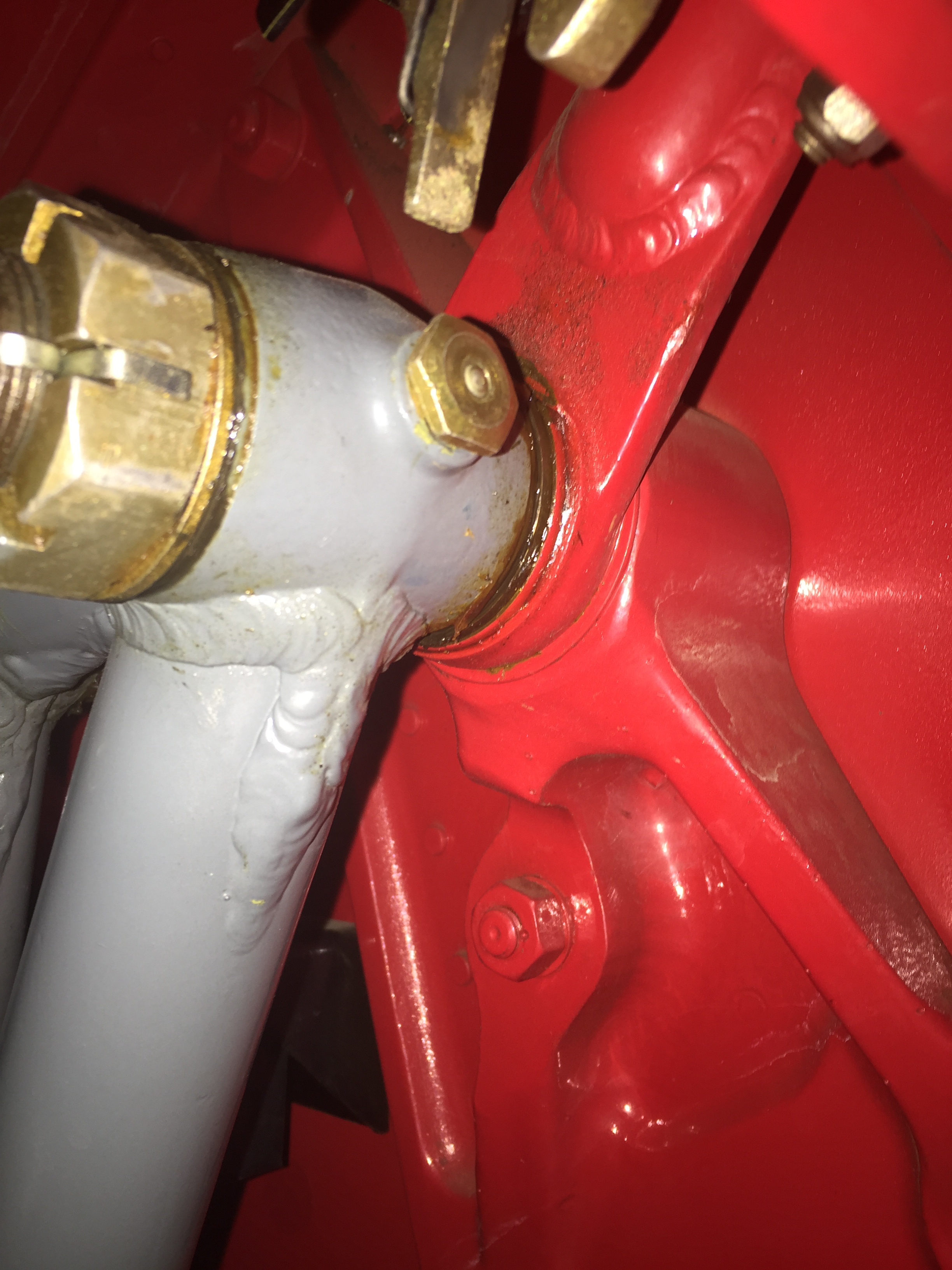

Hey Harv -
I've had great success using Aeroshell #5 in all my LG fittings.
On my CJ, all the grease fittings have been replaced with western nipple/zerk types (readily avail at my ACE Hardware), and they work very well. However, a word of caution: the uppermost forward grease fitting on the main gear trunnions should stay the low-profile Chinese type.
This trunnion - at least on my CJ6 - has a very close tolerance to the adjacent beefy wheel well mounting bracket, and when the MLG retract, a protruding zerk would strike the expensive bracket.
Western zerk fittings typically have a protruding height of ~1/4-inch, which would definitely shear off during MLG retraction, or worse.  All other LG sites tho, western zerks do great for me.

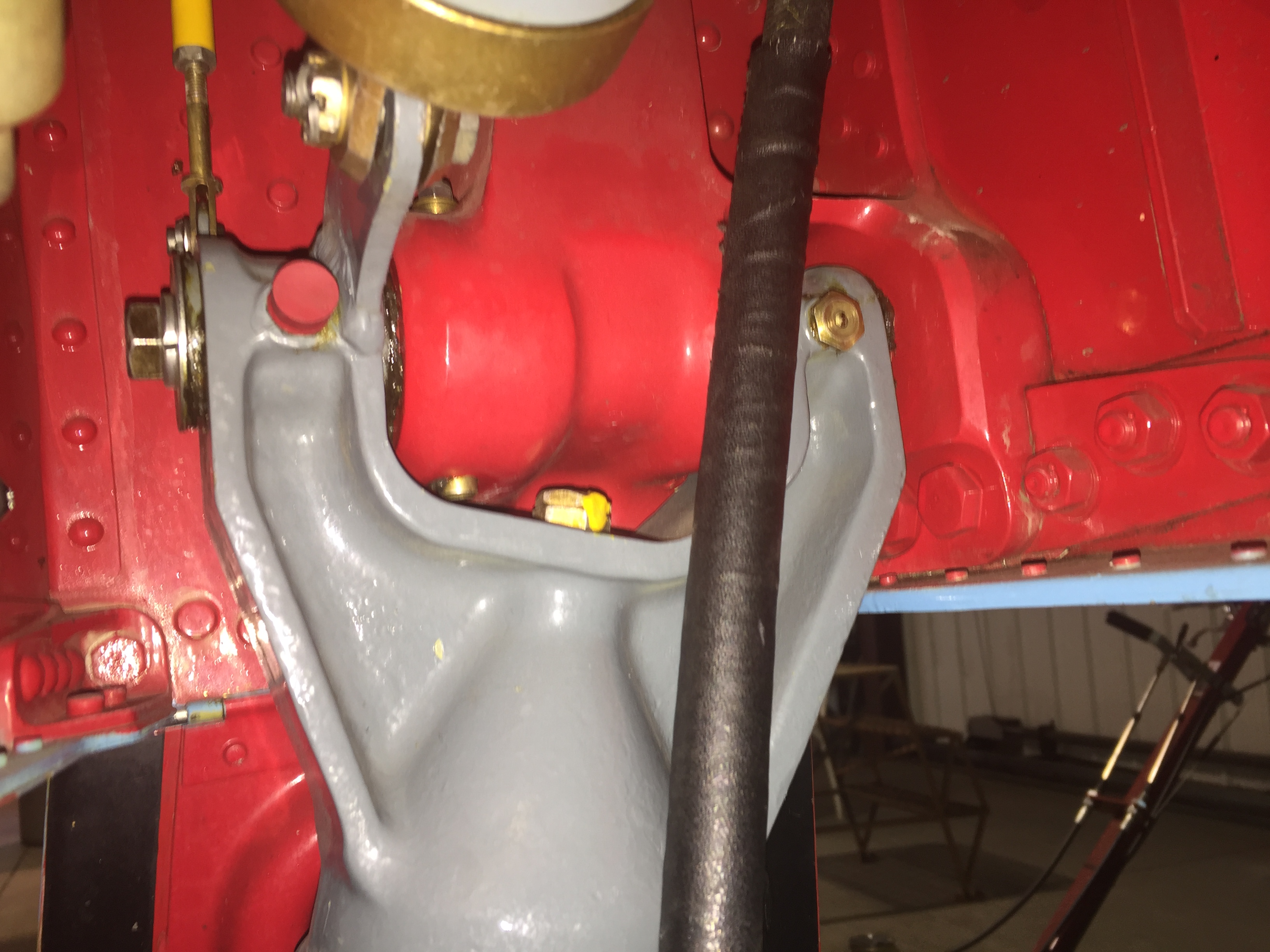

Harv, et al;
I have replaced the Russian/Chinese/Polish grease fittings with Western in
all locations except for two on each MLG.
One of these locations has been identified by Justin Drafts. This one, as
he has noted, is critical. The second is far less obvious. It has been
some
time since I did this so my memory may be suspect but I think this one
required a 45 (or 90?) deg. fitting which would only work in one radial
position
without contacting other structure and could only be detected by hand
swinging the gear with the doors off.
I concluded this could become a problem at a future fitting replacement
without realizing the position was critical and decided to remain stock.
Since I have the original Chinese grease gun it is not a problem. Compared
to the western standard it is far more time consuming but, IMHO, much more
reliable.
Will try to get a photo of that location and post it.

PostPosted: Fri Feb 17, 2017 8:06 pm    Post subject: Cj6 grease nipple fitting Reply with quote
More;
Only two (each MLG) not replaced with Western standard.
First photo is the one referenced by Justin. Second location has the
potential for interference in the up cycle if replaced with Western.
May be OK and I can't remember for sure what the actual problem was but
decided better safe than sorry.
Walt

Justin and Blitz are both correct. Replace with Zerk fittings. Ernie mentioned Grainger which is where I bought mine back in 2006 and I also saw them at Harbor Freight yesterday. As to the close tolerance fittings... I leave the Chinese "button head" fittings in place then on servicing, I temporarily screw in a zerk fitting, service it with grease, then replace with the button head fitting. JB
From: "Justin Drafts" <draftsjust417(at)gmail.com>
To: yak-list(at)matronics.com
Sent: Thursday, February 16, 2017 7:19:00 PM
Subject: Re: Cj6 grease nipple fitting
Hey Harv -
Justin
