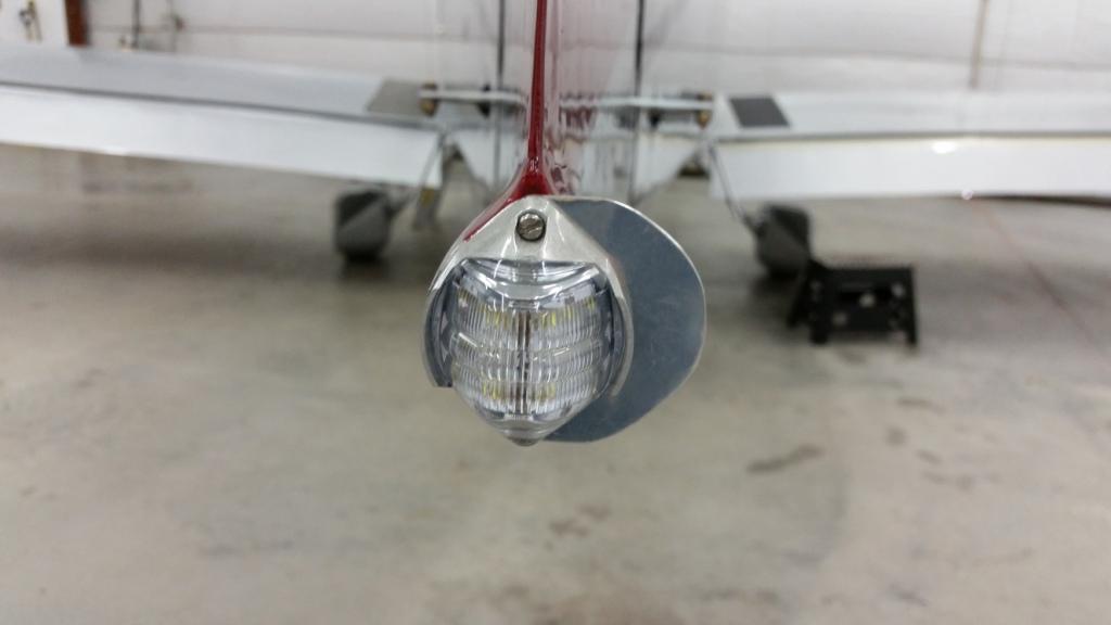

PostPosted: Mon Feb 13, 2017 6:21 pm    Post subject: Rudder Trim and Rudder Counter-Balance Reply with quote
This is a simple and effective rudder trim tab (not my idea - stole it).
Trim the tab as needed to get the ball in the center in cruise. Hard to see
but the tab has a ~30 degree bend aft. No added rudder counter balance
weight.
I started out with the ball touching the left line. Now it is in the
center.
Do this only after you are double check that your gear leg fairing are not
the cause of your ball being out.
Carl

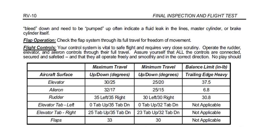

PostPosted: Fri Feb 17, 2017 6:05 pm    Post subject: Rudder Trim and Rudder Counter-Balance Reply with quote
Contacted Van's and they provided the finish tolerance. I'm familiar with different methods of static balancing, including measuring the weight of the trailing edge, etc., but I don't understand how to use the data they gave me.
Finish documents say the rudder’s balance limit is 30.8 in-lb’s. This is probably simple, and I am over-thinking it. However, I’m not quite sure how to apply the 30.8 in-lb. number in measuring the rudder balance.
Any insight is appreciated.
Tks, Bob…

PostPosted: Fri Feb 17, 2017 6:17 pm    Post subject: Rudder Trim and Rudder Counter-Balance Reply with quote
You are just measuring the trailing edge force when suspended on knife
edge at hinge points. Force times the distance from hinge point to
trailing edge gives you the inch pounds.

PostPosted: Fri Feb 17, 2017 6:57 pm    Post subject: Rudder Trim and Rudder Counter-Balance Reply with quote
Thanks, Kelly. I was over-thinking it.
Bob...
Sent from my iPad
[quote] On Feb 17, 2017, at 8:18 PM, Kelly McMullen <kellym(at)aviating.com> wrote:
You are just measuring the trailing edge force when suspended on knife edge at hinge points. Force times the distance from hinge point to trailing edge gives you the inch pounds.
