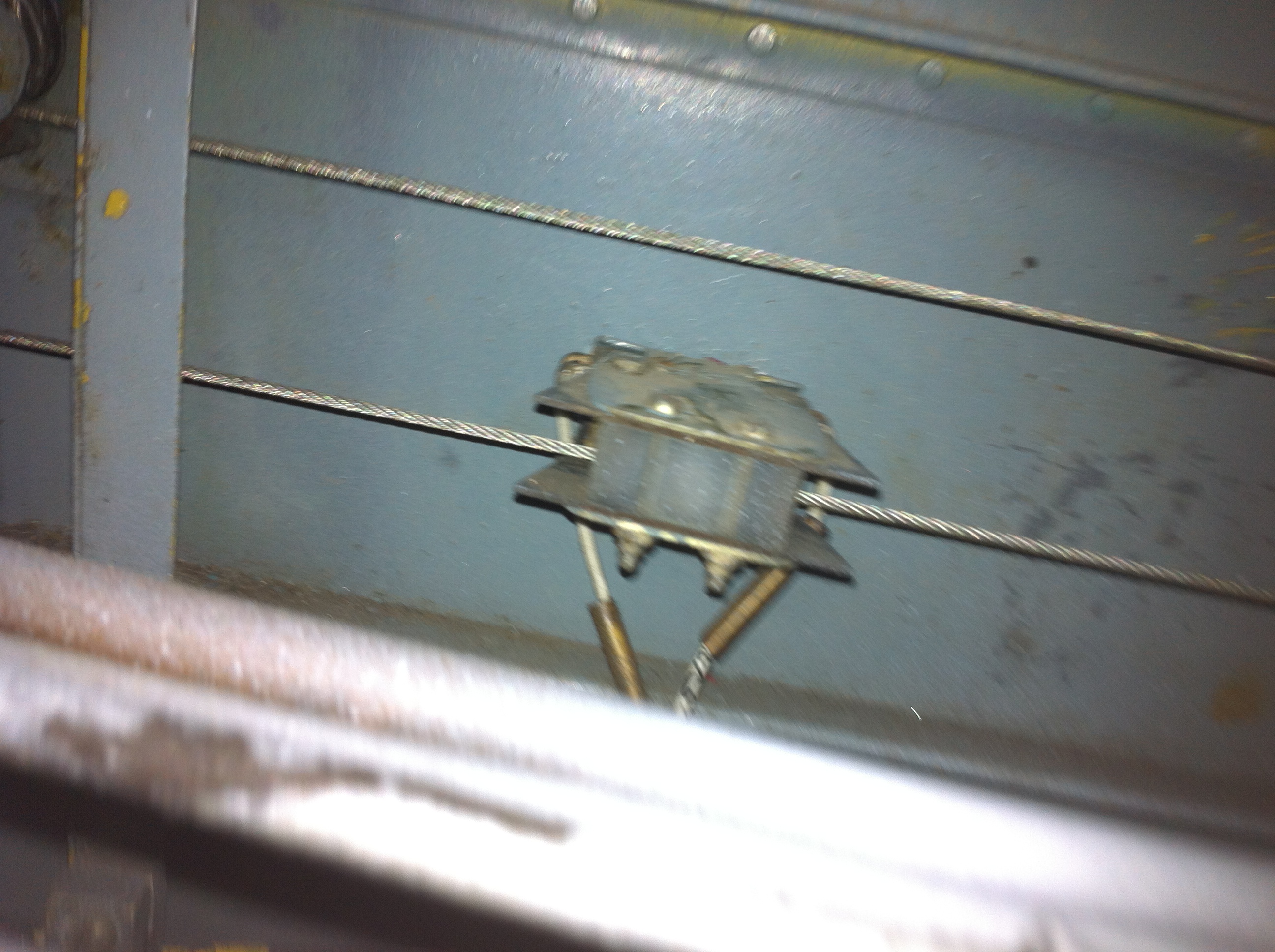

Hello,
You have to check in the radio compartment, behind the rear seat.
Open the back seat access, and look on the right and down side on the frame .
You will see the 2 cables of the tab trim .
the lower cable go through the neutral switch (check picture)
You must have a device clamped on the cable , when moving trough it activate it.
mine was broken and i replaced it by a lead device, from a fishing shop, clamped on the cable . (after aligned the trim and make a colored point on the cable, to notice the neutral position)
Adjusted to go through the switch.
if switch is ok and bulb on the green trim indicator are good, it will be lighted when neutral adjusted.

Hello,

Hello,

Hello,
