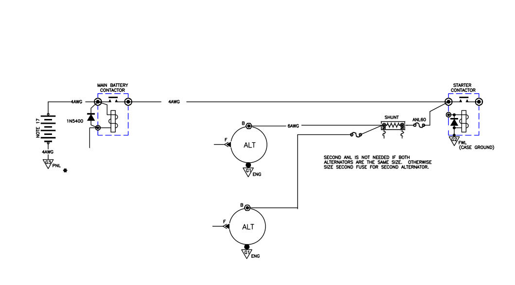

I am considering converting my Z18-8 equipped RV to a Z12 format. The B&C install kit includes an ANL mount and "fuse" plus the current sensor. My question is, is it reasonable to connect my existing anl with its 80 amp fuse and the anl from the stand by source to a single load meter shunt with the output side connected to the cold side of the starter contactor? Except for the addition of the second ANL and the B leed from the standby there are no other changes to this part of my proposed system.
My reason for asking is that it will be difficult to add an additional load meter to my panel. I am thinking that the stand buy would only be generating when the main alternator is offline for what ever reason. The meter reads out  XX.X amps and is built into my EFIS. The EFIS has a connection for a hall effect amp sensor but that would require two firewall penetrations from the standby alternator B leed.
I am not sure that I have given enough information to answer my question, but I would appreciate any input.  TIA, Don

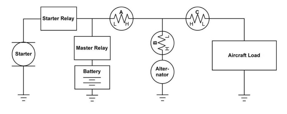

The attached picture from a Dynon installation manual shows three common locations where an ammeter shunt can be installed.
Location "A" is used to show battery charge and discharge current.
Location "B" is used to show alternator output current (load-meter).
Location "C" is used to show how much current the aircraft is using.
The shunt location is a matter of personal preference and has been the subject of arguments. The important thing is for the pilot to understand the meaning of the ammeter display. For instance, a pilot could misinterpret positive current from a shunt in location "C" as normal, ignoring the low voltage and oblivious to the fact that the alternator has stopped working.

donvansanten(at)gmail.com
PostPosted: Sat Feb 11, 2017 2:30 pm    Post subject: Z12 Question Reply with quote
Bob, thanks for your input. My "load" during daylight ops after the battery
is recharged from the start is roughly 13 to 15A. The load meter question
should have stated that it was just for "setup and test" to determine what
items can be operated while the 20A alternator is the power source.
What I need to know is, is it electrically safe to connect the two ANL
blocks to the input side of the shunt and the output side of the shunt to
the cold side of the starter contactor? At no time would there be output
from from both alternators simultaneosly.
Part of my decission to drop the E bus and go with the 20 A standby was
your recent responce to an individual asking about using the 20A standby.
You said something like "I would abandon the e bus and go with the Z12
setup".

Don, is this something like what you have in mind? I think it is feasible.
The ANL 60 could be moved to the other side of the shunt. Then the shunt would not have short circuit protection.
PostPosted: Sat Feb 11, 2017 10:20 pm    Post subject: Z12 Question Reply with quote
Joe,
That is exactly what I was intending. The Alternators are Main= 60A standby=20A. The current setup has an 80A ANL in the main "b" leed before the shunt. I was thinking of using a 30A ANL in the b leed of the standby. Both ANL's would then connect to the shunt input and the shunt output wound connect to the starter contactor.

PostPosted: Sun Feb 12, 2017 7:33 am    Post subject: Re: Z12 Question Reply with quote
Looking at Z-12, both alternator outputs are connected together through very low resistance shunts and short circuit protection devices. Your plan does not change that. The only disadvantage I see in your plan is that the shunt will not have short circuit protection. And the disadvantage of my circuit posted above is that if the large ANL current limiter blows, then both alternators are lost. Separate shunts as in Z-13/8 eliminates those disadvantages.
You might consider using a 30 amp Maxi fuse instead of an ANL to save money and weight.

PostPosted: Sun Feb 12, 2017 2:27 pm    Post subject: Z12 Question Reply with quote
Joe,
I may try using the Hall Effect amp sensor with the standby.alt. The manufacturer says the sensor may not be mounted on the hat side of the firewall. I know of a few people that have ignored this warning and they have had no issues with the sensor functioning after 1500 to 2500 hours of use. I might try this as well.

PostPosted: Sun Feb 12, 2017 3:50 pm    Post subject: Re: Z12 Question Reply with quote
Don, I have no experience with hall effect sensors, so can not advise. That sensor could be mounted on the cold side of the firewall, but would require another wire through the firewall, 12 or 10 AWG, whatever the alternator requires.
PostPosted: Sun Feb 12, 2017 4:19 pm    Post subject: Z12 Question Reply with quote
Yeah it would need to come in, through hall effect and then bach out. Trying to avoid the extra penetrations. Think I will just try the hall effect on the hot side of FW.Don

user9253
Joined: 28 Mar 2008
Posts: 1978
Location: Riley TWP Michigan
PostPosted: Sun Feb 12, 2017 5:36 pm    Post subject: Re: Z12 Question Reply with quote
The wire would not have to go back out. Just connect it to the main power bus with a fuse or circuit breaker.
