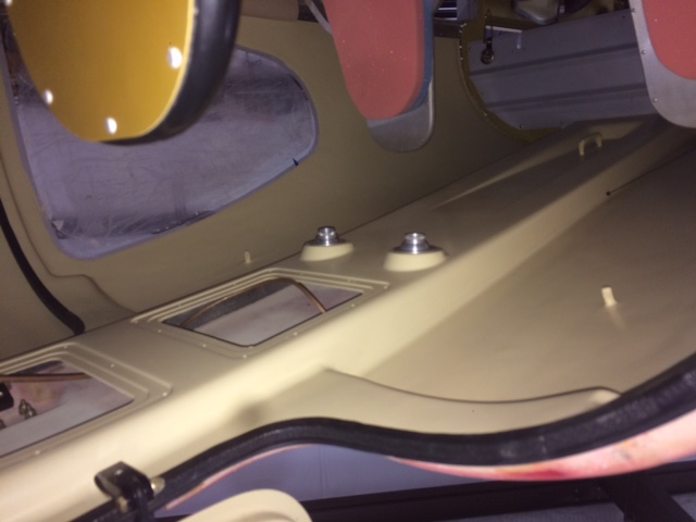

PostPosted: Thu Feb 09, 2017 10:37 am    Post subject: Cabin cover bottom Reply with quote
I was lucky in that I was based next to an aircraft interior shop.  We used a combination of textured truck bed liner paint and automotive type headliner.  I let the paint show in areas that are hard to cover with cloth, like around the windows.  The upper door areas are painted to conserve headroom.  This kit comes with the spray gun.  I had it tinted at my local paint supplier.  Worked great and easy to apply:
http://tinyurl.com/j7bclgy
Here's an example of the finished paint surface and the headliner.
[img]cid:ii_15a2426ac22ef90d[/img]
Also, the areas that tend to be touched a lot are painted so they're easy to clean.
--Dave
