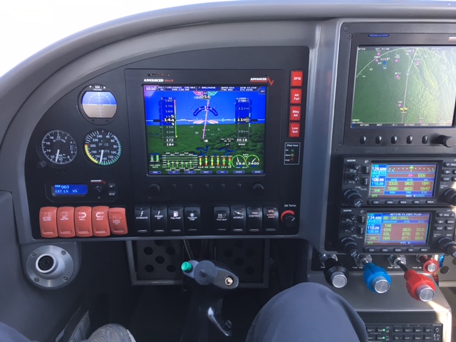

PostPosted: Fri Feb 03, 2017 9:00 am    Post subject: electronic ignition Reply with quote
I'm not seeing any noticeable increase in cht. At high MP the system runs at 25 btdc just like the mags. At cruise running LOP, the chts are fine. Here's a pic in cruise at 11k. If you zoom in on the AFS you can see all CHTs below 324. 172knts TAS, 10.9 gph.
[img]cid:7F00759A-CB9E-4F6A-913E-A6DF3595F201[/img]
Bob NewmanTCW Technologies, LLC
610-928-3420
