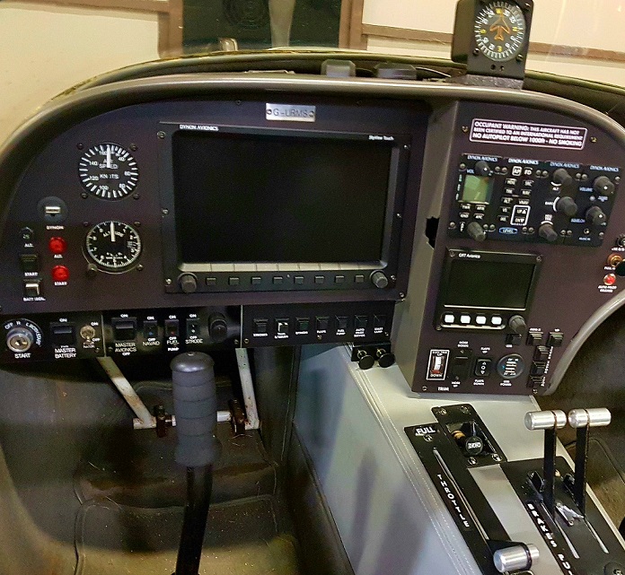

I'm in the process of getting my Europa Tri-Gear ready for IMC/Night approval. I've done a lot of work replacing all my avionics with a SkyView D1000T panel, 8.33 radio, transponder, 2 channel auto pilot, landing light, position lights, cabin lights and a backup artificial horizon (I went for a GRT Mini-X because it has a terrain and obstacle database. Essential as a backup instrument for IMC/Night if you ask me). I've also plumbed my Pilot Aware unit into the SkyView system so I get traffic too. It works a treat. I just need to replace my Pitot probe with a heated version now and I was looking at the Dynon. I need to find out what the current draw is to see if I'm going to need to fit an additional alternator.
I'm talking with Peter Pengelli, one of the guys that's been involved in getting the LAA IMC/Night approval through. I'm waiting on a test pilot to fly it and see if he gives the thumbs-up so I can go on to the next step. Then it's down to an assessment of the kit I have fitted and whether I need to make changes (God, I hope not), additions, etc.
Hopefully you can see a picture attached of the new panels fitted. If not, email me directly and I'll send you some pictures.

wow, that looks and sounds great. I put my info into the LAA but then was asked to submit a MOD15 form. I have my annual at the moment so am rearranging my instruments to comply plus adding wires for lights and pitot heat. I have a pitot heat design in progress based on the europa standard one and recon on needing about 1-2 max keeping thermal insulation up and thermal mass down.
It sounds like you are already well on the way and will be the first of class/type and it may be sensible that that is a tri-gear.
Rick Moss is also pursuing it his Europa with a conventional six pack fit out. Mine is a mix of steam, dedicated gauges and portable and installed electronics not nearly as clean as your panel.
Somehow I need to link up to the assessment team. Where are you based?
Graeme Bird

The link just goes to an error 404 and not found. I would love to see them please as I am currently designing a panel. I'm favouring conventional instruments with some electronics I.e. HSI.
Perhaps the Europa Club would consider hosting the pictures with a write up on progress on making this happen do you happen to be a member?

I deleted the original picture because it was physically too large. You may have clicked on the link when I was in the process of changing it over. It seems to be displaying OK now.
Graeme, I'm based at Membury.

congratulations for that very tidy cockpit layout - impressive! And of course best of luck for the approval.

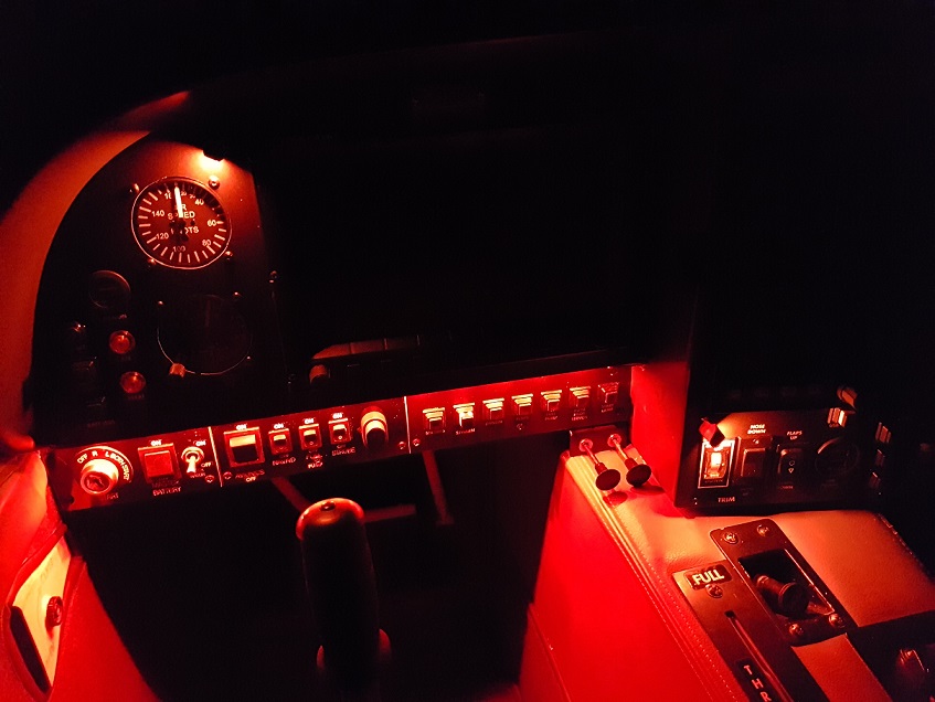

I've just finished adding dim-able LED cockpit lighting for those night flights to come.
