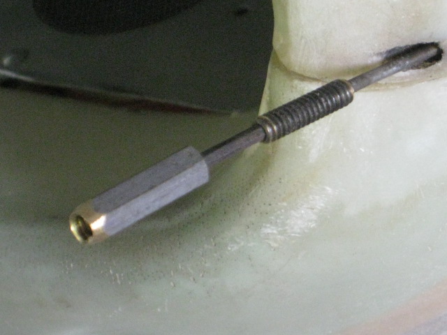

I bought socket head 10-24 set screws.  Drilled the end of the set screw and brazed it to the hinge pin.  I have a coarse brass screw for fastening in wood (don't know what it's called) that has a 10-24 thread down the middle.  It is epoxied in the front of the lower cowl so that the set screw goes through a small hole in the cowl nose and then screws into the brass thingy.  I have a threaded part that fits over the set screw and fits in my battery drill so I can turn the hinge pin as I push it in.   A piece of hex key in the drill will insert/remove the hinge pin far enough to clear the threaded insert.
[img]cid:part1.854F40CA.8B087B04(at)cfl.rr.com[/img]

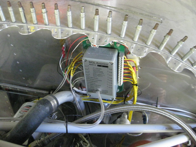

I used 1/4 turn fasteners. Here's a pic of the mounting strip.
[img]cid:part1.0977DC6B.BB6D0E9B(at)cfl.rr.com[/img]

Although I was not referring to the side cowl to cowl hinges, but to the top cowl/fuselage upper hinges,
Thanks for the tip, anyway
Cheers
Carlos
