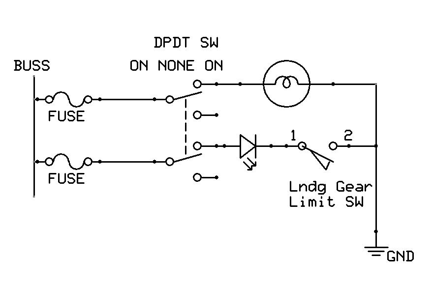

Sounds like unnecessary extra in-flight work for you Bill … I would arm the entire circuit with a single switch that turns on the nose landing light straight away, but is wired in parallel with a microswitch and relay to allow current to flow to the gear leg lights only when the gear is physically in transit going down.

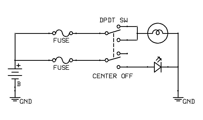

Attached is a schematic to control two circuits.
The switch terminals can be figured out using a continuity meter or test light, the kind with flashlight batteries.
If using a meter with a diode check function, the meter will show about 0.7 volts when the switch indicator LED is conducting.
How many terminals do your switches have?

Here is another circuit using Stu's idea which is a good one that will reduce pilot workload. Landing is a busy time. The pilot does not have to be concerned about what position the light switch is in. The switch only has two positions, up or down, on or off. There is no center position. Either a DPDT ON-NONE-ON or a DPST ON-OFF switch can be used.

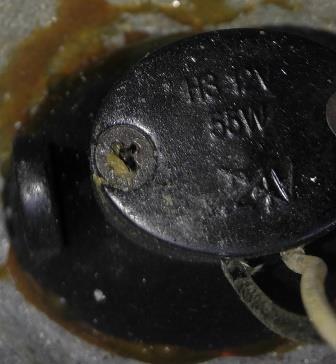

I do not know what the existing nose cone landing light bulb is...it is a
"HID" (blueish color) bulb and it has " 55W 24V HID" printed on the inside
plastic base. I have attached a picture (hopefully it goes through). My
aircraft is a 12 VDC system so the "24V was surprising"?
Does anyone recognize this bulb? I am trying to reconstruct records for all
of the equipment that came on this airplane (the previous owner was not the
builder...he had a "builders assistant" build the airplane for him and he
lost most of the records/receipts)

There is no diode in my schematics other than the LED. The two little arrows next to the diode symbol indicate that it is a Light Emitting Diode aka LED. No additional diode is needed other than the LEDs that you already have.
Adding up the wattages of all 3 lights, 55 + 72 + 72 = 199W
199 watts / 14 volts = 14 amps I would use a 20 amp breaker and 12AWG wire. If the breaker trips, all light will be lost. You might consider two separate circuits.
