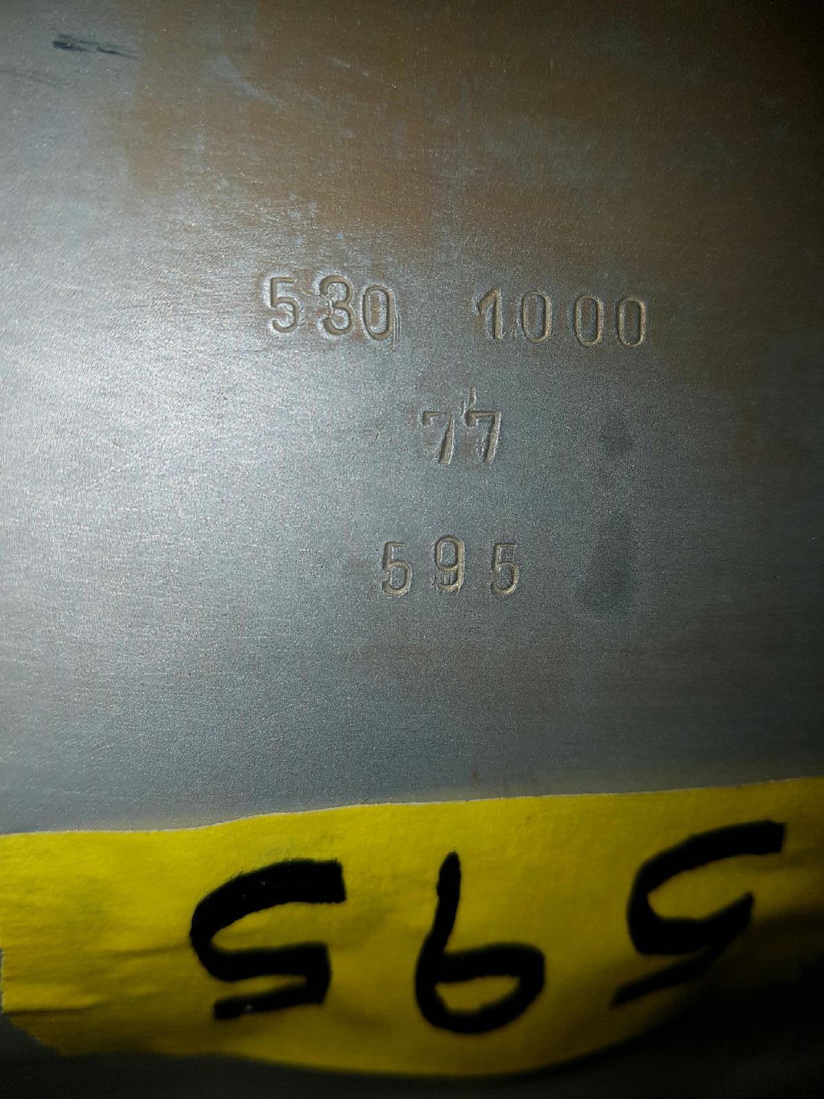

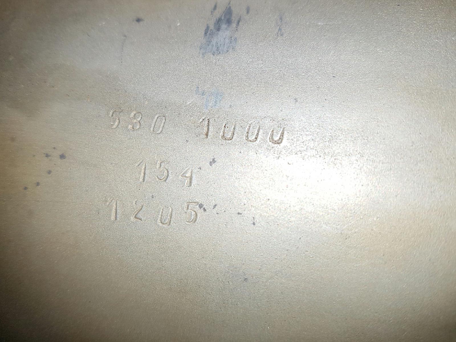

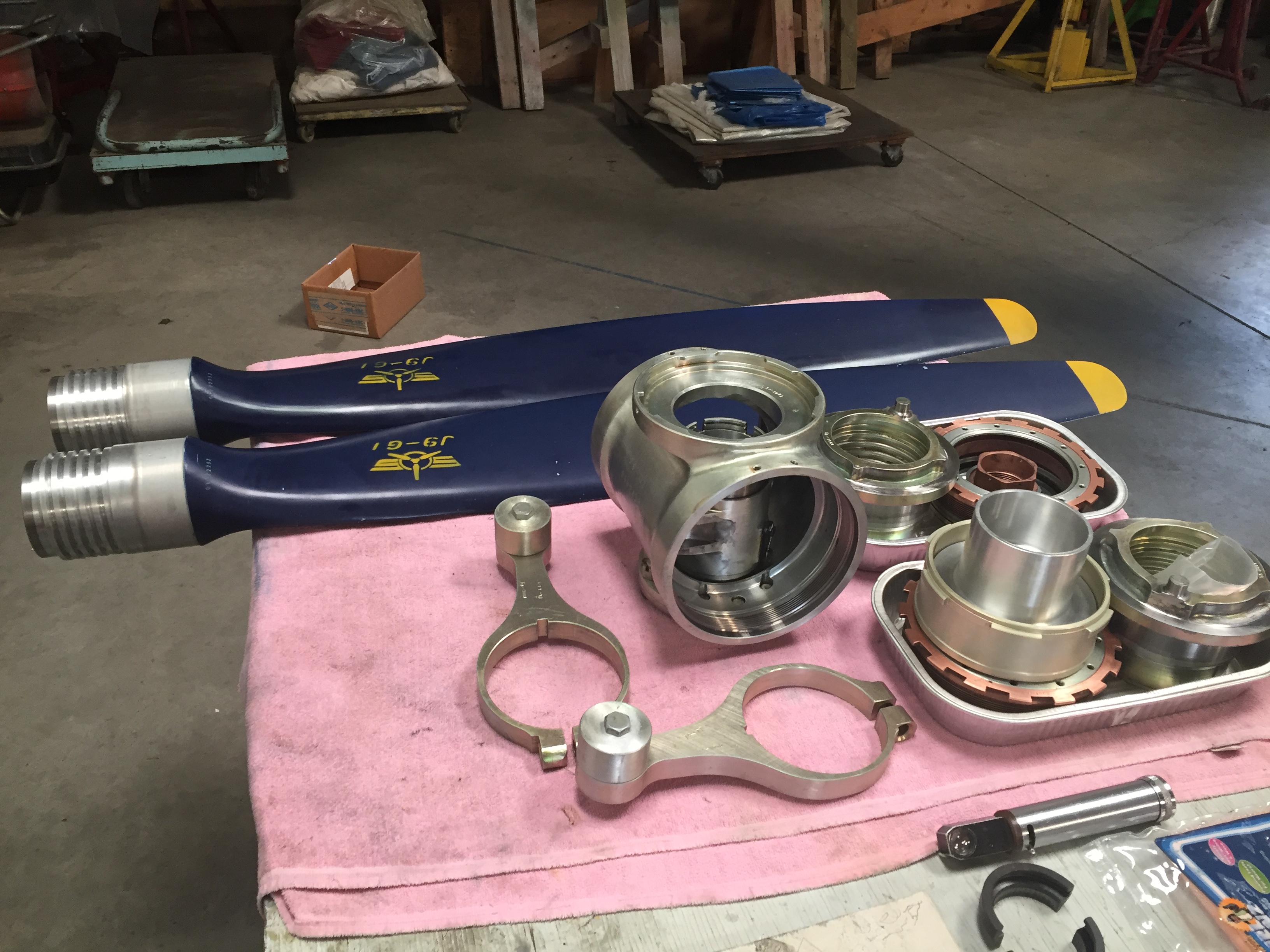

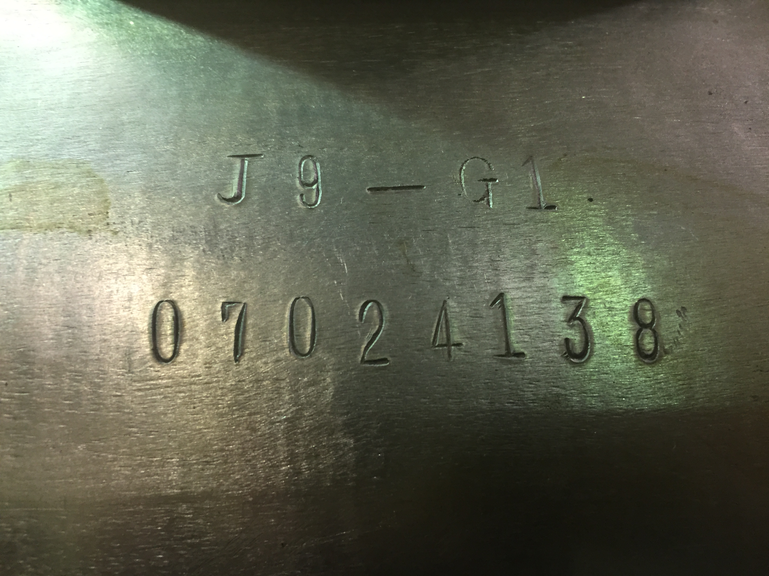

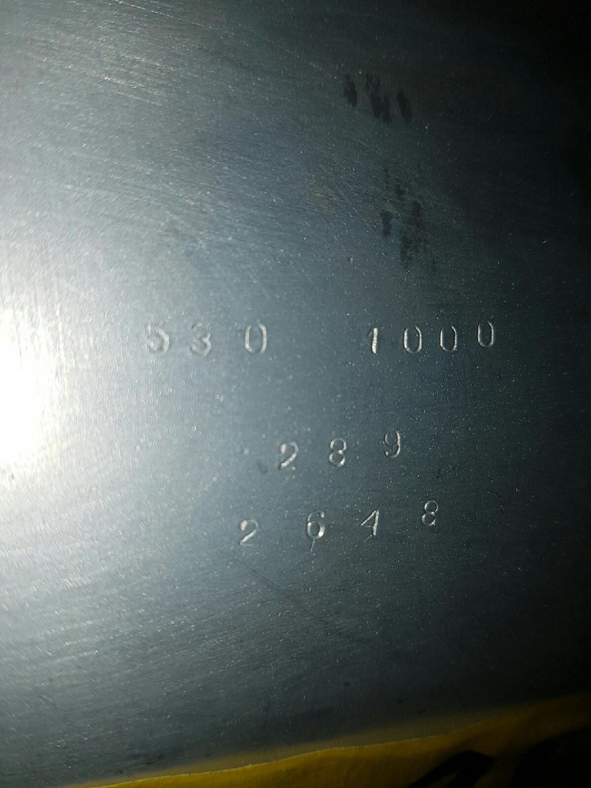

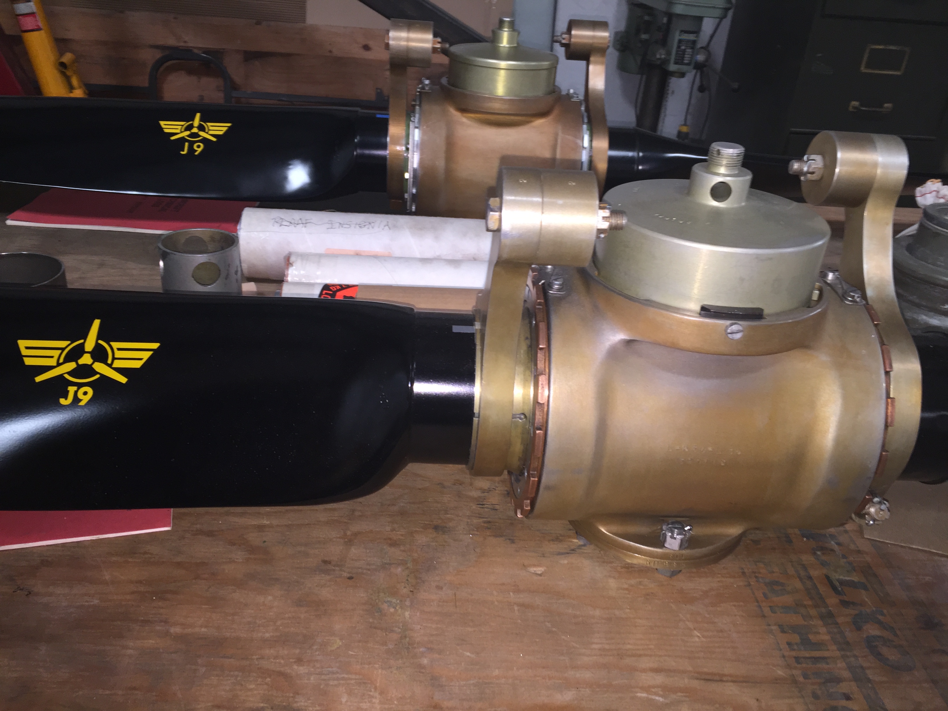

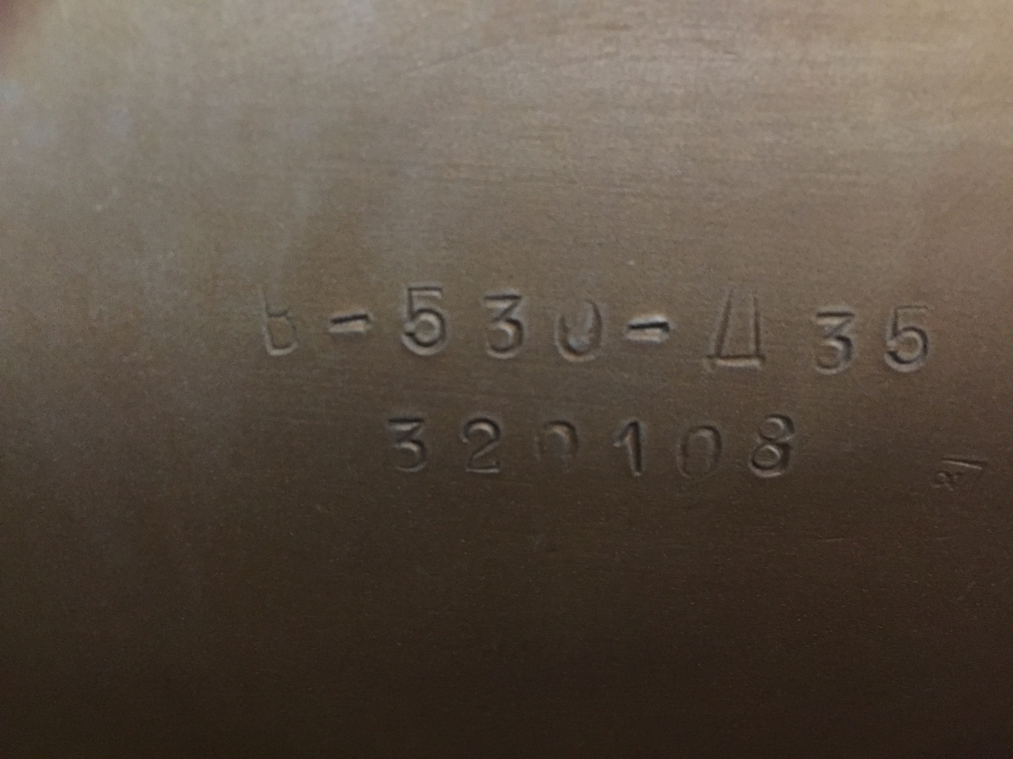

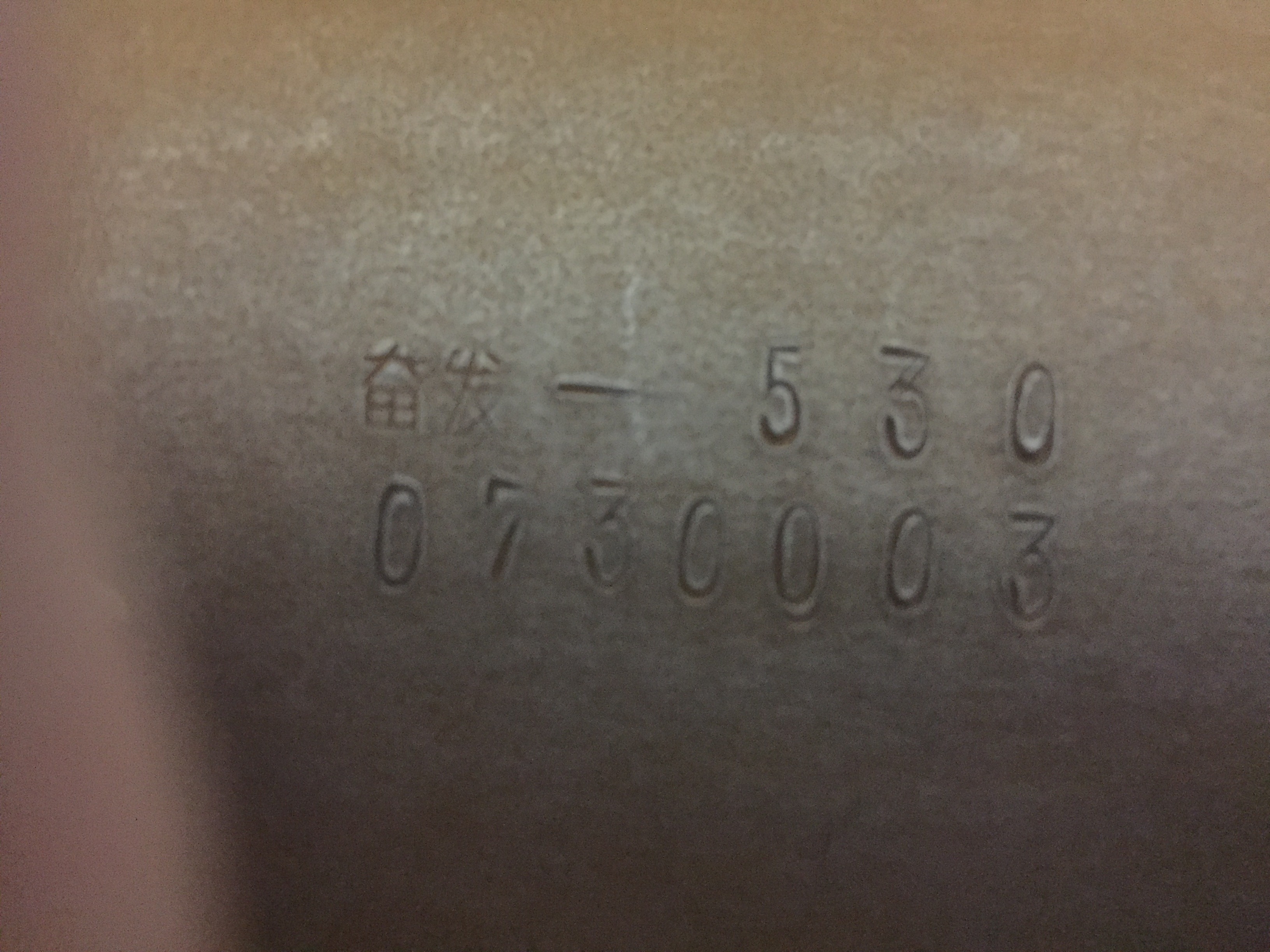

PostPosted: Tue Jan 24, 2017 11:30 am    Post subject: Nanchang Company, M14P approval Reply with quote
Jill, Pappy & Group;
I guess I too am a stickler for facts but in this case Jill’s fact is the real one, the PZL number (US 122000) is the propellor type. My apology Jill! It is not in compliance with Hamilton Standard practice but then it is not an HS prop. Can I claim my screw up as an “alternate fact”? Seems that now has official sanction in certain places.
Back to the original question: Is the Type 530 hub used only on the M14P engines? The answer is still no. Some photos attached of a number of CJ and Wilga prop. hubs showing the Type/Part numbers.
Photos 1 – 3 are CJ6 hubs: #1 is a very early (in CJ production) Russian manufactured unit. #2 is early Chinese manufacture - note the Chinese characters preceding the number. #3 is the final Chinese production.
Photos 4 – 6 are PZL Wilga hubs (presumably all of Polish origin).
All of these hubs are physically interchangeable (though not legally for the certificated version of the Wilga).
Of course none of the above hubs can be installed on the M14P.   The Type 530 probably originated in the 1950’s with the production of the Ivchenko engine but possibly even earlier for other prop. shaft type engines.
The M14P did not exist until approx. 20 years later. The flange mount arrangement was a major change that probably should have warranted a new type number but given that the majority of internal components were the same they may have concluded it was not necessary. In any case it is impossible to interchange.
Due to large size of first 3 photos only those are attached here.  Others to follow in separate email.
Walt

The number you are quoting for the PZL Wilga prop. hub is actually the
design number of the blade, not the hub.
If you could take the time and actually look at one you will see the hub
design number is V530 - T35. The M14P uses the same BASIC design number
but
with a very different dash number.
Walt

wlannon(at)shaw.ca
Post # 2 Remaining photos attached.
Last 2 photos are two overhauled CJ props and one in process. Anyone interested in these please contact off list.
Walt
From: Jill Gernetzke (jill(at)m-14p.com)
Sent: Saturday, January 21, 2017 6:58 AM
Subject: Re: Nanchang Company, M14P approval
Walt and Group,
Good morning. I am a stickler for facts and a thank you to Walt for prompting me to back up my statements with facts. (I am a much worse grammar cop and that is how I ended up writing for the Red Alert.)
So, I went digging through the library and the shop before my first cup of coffee, this morning. Here is what I have to add to the discussion:
1. The PZL US1220000 is the correct name for the Wilga prop, not just the blades. It is listed on the FAA Type Certificate data sheet in this manner. Nowhere on the 2 Wilga hubs in the shop is there a stamping "V-530".
2. The Yaks/M-14P use the Vpered V-530 T/A Propeller.
3. The CJ uses a J9-GI Propeller type. The stamping on this CJ hub we are overhauling is stamped with 2 Chinese characters, a dash and then 530. I do not think the factory in Russia manufactured these hubs. Again, the CJ hub is for a splined prop shaft. We do install V-530 blade collars in the hub to be able to use our V-530J, W-530 or stock V-530 blades in the Chinese hub - no problem.
My question is how people fill out their Airworthiness Application in the Propeller blocks for Manufacturer and Make/Model?
If you are really curious, I have posted documentation and pictures about this topic on our M-14P, Inc. Facebook page because I don't know how to do it here. After 20+ years in this business, there is still a lot I do not know! : )
Going to get my coffee, now. Have a great weekend!
Jill
