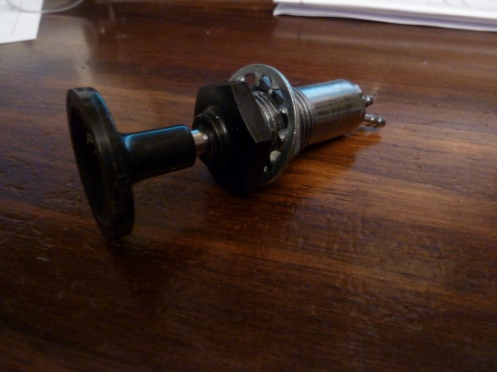

Was planning to add this primer to the FSII, specifically this item in the photo - it is new old stock. Tested it and while it sucks fuel into the intake side, when you push the plunger in, it also squirts it back out the same line, unless you do it quick and hard, in which case it squirts it out both lines.
I am thinking it is no good, but never having used one, what do I know? Is that the way it is supposed to work?
Richard Pike
Kolb MKIII N420P (420ldPoops)
Kingsport, TN 3TN0
I've never used that model, but they're just piston pumps, with inlet &
outlet check valves. Sounds like the inlet check valve is stuck open.
Can you disassemble to check it?
Charlie

PostPosted: Wed Jan 18, 2017 11:00 am    Post subject: Re: Primer plunger? Reply with quote
Richard Pike wrote:
. S N I P >
http://www.aircraftspruce.com/catalog/appages/primerplung.php?clickkey=69864
Richard
Definitely not the way it is supposed to work. One side in... the other out. These are notorious for going bad, generally from drying out due to lack of use. However, I still use them to fill the bowls instead of the bulb pump.
If this one has been sitting for a while, trying to get it to work will soak the insides with fuel. Letting it sit for a day or two may lube the internal parts enough to get it to work.
When I get a replacement, I always make sure I have a spare on hand.
Worth what you paid for it... your experience may vary.

PostPosted: Wed Jan 18, 2017 11:25 am    Post subject: Primer plunger? Reply with quote
That looks pretty much like the one on my Firefly.
Concur with a stuck check valve.
Always check the simple and easy stuff first. Are you are the fuel supply is
connected to the proper fitting? Might be worth reversing the hoses at the
primer just to see what happens.
If you can't get it apart perhaps soaking in your favorite gasoline additive
(Sea Foam, Marvel Mystery Oil, etc.) might free it up. 100LL makes a pretty
good solvent for fuel system stuff.
If this is a used primer assy. there is a good chance that the check valve
is gummed up with varnish and it may take something more like Toluene or MEK
to break it free. If all the internal parts are metal it should cause no
harm. All bets off for seals and plastic parts though, so use at your own
risk. Wink
If new, perhaps a visit with the vendor will get it replaced.
Let us know what you find out.
Stuart
byoungplumbing(at)gmail.c

PostPosted: Wed Jan 18, 2017 3:37 pm    Post subject: Re: Primer plunger? Reply with quote
Like I said, this primer/plunger is brand new, never been used, sitting on the shelf for ... hmmm... probably since my MKIII was running a 532...
OK, since it may not be worth a flip anyway, will attempt to open this primer/plunger up using Large Mechanical Devices and see what the insides look like. Earlier today I dumped some Marvel Mystery Oil down the intake side and it didn't do any good, nothing changed.
In an attempt to loosen the check valve (if any) I took it and beat it against the side of the wooden picnic table. No change, but the wife did ask me if we had any ducks in the back yard. Not helpful.
The only reason I am fooling with it is because the FSII with a 582 is driving us crazy - it belongs to my buddy, who has the hangar next to me, and it is drawing the fuel out through the top of the tanks, with the fuel pickups weighted, and laying in the bottoms of the tanks. Same as we did with our Hummers & Drifters years ago. No Big Deal.
After the two lines come out of the top of the 2 tanks, they join, then go downhill to the primer squeeze bulb (new) then further downhill to the filter, then the gascolator (to sump out any water) and then to the Facet pump. And then uphill to the Mikuni pulse pump next to the engine, and then to the 2 carburetors.
Sounds simple, right? Yeah, bet me and lose!
Drag the airplane out of the hangar, tanks are almost full, turn on the Facet pump, squeeze the bulb several times, it gets as hard as a rock, you can hear the Facet load up, just as they always change sound when the float bowl gets full and the float needle cuts off, because the floats are full. Sounds ready.
Now you turn on the mags, hit the starter, and grind it over ad infoonity - nothing happens.
Grab the spray can of primer/starter and shoot a dose into the air filter, .... and it starts.
If you pull a float bowl off during this fiasco, it is dry. In spite of our best efforts, we cannot get any fuel up into the float bowls when the engine is not running.
But once you get the engine to semi- sorta - primer spray - run, it sucks the fuel right on up and then functions flawlessly for the next week. But let it sit for a month? HAH!
I am not willing to fool with this thing endlessly, I have already spent hours redoing the fuel lines and connections, and it changes nothing. If I can rig a primer to shoot some gas into the carbs and get it to simulate running, so that then it will take over and behave normally, and everyone will be happy - good.
So that is why I am trying to get this primer system to work. Or am I missing something? All suggestions will be pondered.
