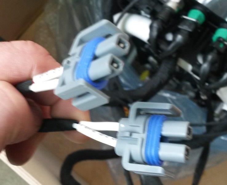

Hi all,
Does anyone happen to know the make and model of the connectors on the
attached picture ?
We would like to fabricate an extension cable for the 912iS fuel pumps,
but couldn't get an answer from our dealer or the Rotax Owner Forum.
Any suggestions ?
Thanks in advance,
Best regards,
Gilles

kjashton(at)vnet.net
PostPosted: Wed Jan 11, 2017 6:50 am    Post subject: Do you know those connectors ? Reply with quote
LeadingEdge shows them but backordered. # 881 304 At $135 each (Yikes!) I would just cut them off and use a standard weatherproof auto connectors.
https://www.leadingedgeairfoils.com/connector-set-fuel-pump.html
Or go to the junkyard, cut off some nice connectors. Smile
-Kent

gilles.thesee(at)free.fr
PostPosted: Wed Jan 11, 2017 7:09 am    Post subject: Do you know those connectors ? Reply with quote
Kent,
Thank you for responding.
Yes, the price and availabilty...that's why we would like to get them
from the manufacturer and not from a Rotax dealer.
Also we would need the mating female counterpart.
That's plan B. But we would like to avoid modifying the standard wiring etc.
That's plan C^^!
Still searching, thanks
Best regards,
Gilles

chaskuss(at)yahoo.com
PostPosted: Wed Jan 11, 2017 8:06 am    Post subject: Do you know those connectors ? Reply with quote
The drawing in the link you provided looks like a GM WeatherPac connector. I suggest you show this connector to a local "quality" auto parts vendor. Forget asking the minimum wage employees at your local national chain auto parts store. Odds are they will be clueless.
Charlie
PostPosted: Thu Jan 12, 2017 2:33 am    Post subject: Do you know those connectors ? Reply with quote
Charlie, Jim, Kent,
Thanks a lot for pointing me to the Weather Pack stuff : the researched
connector is actually a Delphi Metri-Pack :
http://ecat.delphi.com/feature?search=12162017
2 Way Medium Gray Metri-Pack 150 Sealed Female Connector Assembly, Max
Current 14 amps
Part # 12162017
Less thant 1 $/€ apiece at Mouser Electronic's (+ seals and terminals).
Thanks a lot !
