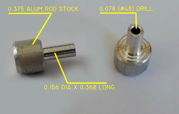

PostPosted: Mon Feb 27, 2017 1:25 pm    Post subject: crimp tool positioner Reply with quote
At 11:14 AM 2/26/2017, you wrote:
m22520/7-02 available at mouser
Unless you can find one on eBay or some
such used, they're pretty pricey . . . I'd
made some in the past but couldn't put my hands
on one. Went out to the shop and carved
one out:
[img]cid:7.1.0.9.0.20170227151700.0220e8a0(at)aeroelectric.com.0[/img]
3/8" rod stock of alum or steel works. I've used
3/8" grade 3 bolts as material source. The exact
diameter is not critical.
Turn down a 0.156" x 0.368" "smoke stack" on
the end and then drill with #48 drill at least
0.5" deep.
Attach to your Daniels tool with a small dab of
RTV or E6000 . . . just enough to keep it from
falling out.

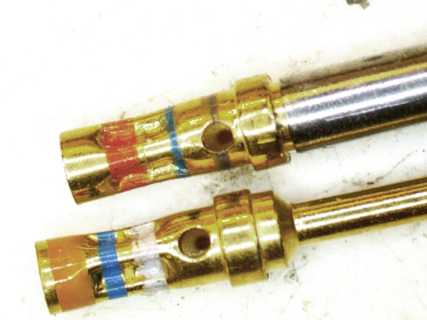

The positioner you see above placed the crimps
on these pins . . .
[img]cid:7.1.0.9.0.20170227151700.0220e8a0(at)aeroelectric.com.1[/img]
. . . right where I wanted them.

PostPosted: Mon Feb 27, 2017 3:41 pm    Post subject: Re: crimp tool positioner Reply with quote
Thank you Bob, with that info. I can make one here.
Once again, you have bailed my butt out.
