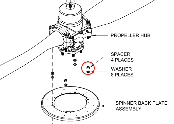

PostPosted: Tue Jan 03, 2017 3:56 pm    Post subject: Spacers to simulate prop for fitting cowling? Reply with quote
Thanks for the input, guys.  I managed to get a scrapped hub from a nearby prop shop.
However, I've encountered one more snag---how long are the spacers that go between the hub and the spinner backplate?  The plans say they're supplied with the prop and don't give a dimension.  They're the ones indicated in red in the attached drawing.
David

PostPosted: Tue Jan 03, 2017 4:59 pm    Post subject: Spacers to simulate prop for fitting cowling? Reply with quote
Wait until you get the prop and use those spacers.
