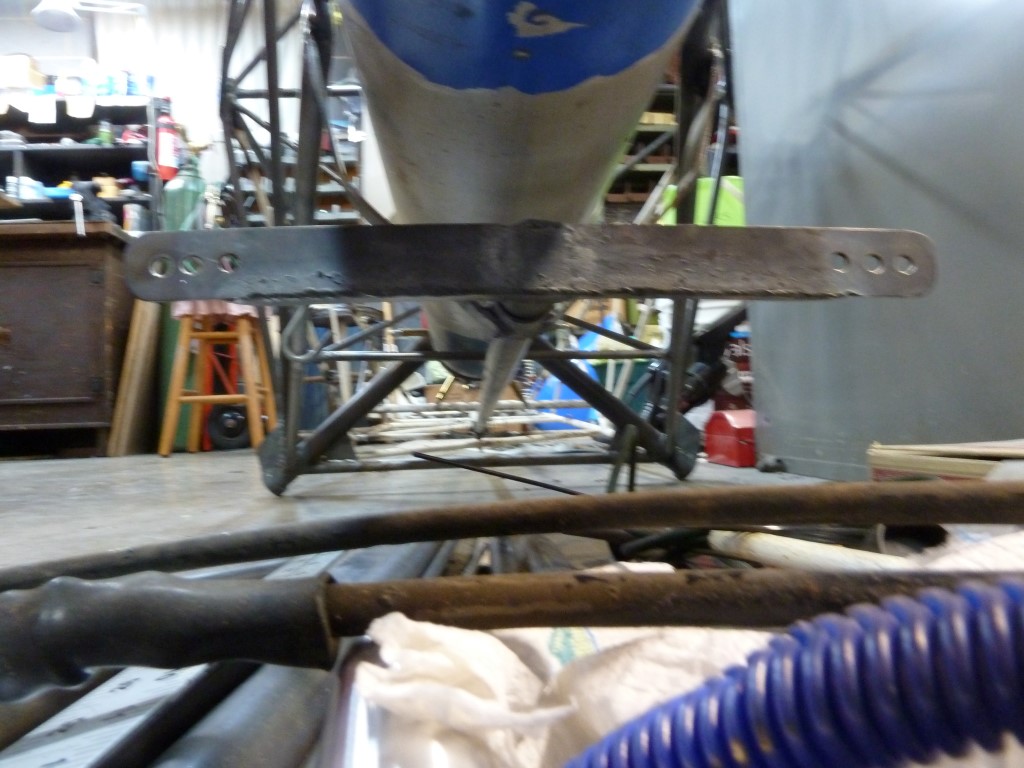

Rick, if you ever get anywhere near NE Tennessee, I hope you come and visit, I would love for you to fly my MKIII, I would consider it an honor. I reduced the aileron throw just a little, but the reduction in effort was remarkable. I think you would find the control authority to be non-compromised.
Right now I am in the process of building a Firefly out of a wrecked original Firestar, and have built the aileron bellcrank so that we can find the "sweet spot" for rigging the ailerons. You might consider trying something similar, it is one of those things where if you try it and don't like it, you can put it back to where it was.
Merry Christmas to all my friends on the Kolb List!

I appreciate the offer and have no doubt that your change works as you describe but you may have missed my point of concern. When you are near stall speed on takeoff and landing and you get into turbulence that can spell disaster you might need every degree of aileron deflection that Homer designed into our airplanes. I don't know that I have ever utilized full aileron deflection but my Kolb got me through what mother nature threw at me. It would have been a small consolation that is was easy to get to a aileron control stop that didn't save me. Yes I want it all, balanced controls, full defection and maybe no adverse yaw. But I can live with the stock configuration.

The Firestar ll that I purchased several years ago had aileron spades that could be detached from the aileron and that was the case when I looked at the plane....the owner showed them to me ..they were I thought quite big and I thought to myself that it made no sense to put such things on the ailerons and put all that pressure on the hinges...so I left them there…at that time I am not sure I knew what aileron spades were….....the seller was the 2nd owner of the plane.....later on I talked with the builder of the plane and he said the spades worked excellent and that I should have taken them.....after speaking with him I came away thinking he might know what he was talking about...

Been thinking about this for a couple of days and the more I think about it the more it sounds like a good idea. IMO my solution to heavy ailerons via reducing throw/leverage works quite well, (or it has for the last 15 years) but you guys certainly do have a point - what if you can have your cake and eat it too? And maybe we can?
One of the considerations on any Kolb is the aileron twisting force; you apply torque to the inboard end, and by the time that torque gets to the tip, you have a lot of pressure accumulating, and typically, the aileron tube will twist enough that you are not getting full deflection at the tip. Typically spades are placed at the mid point of the aileron, but then I notice that most aerobatic aircraft have the aileron pushrod at midpoint, so what they are doing is modifying a major piece of hardware to do two jobs, and that's cool, but that's not our situation. So what if we put some small spades at the tip? To counteract the twist of the aileron tube throughout it's length? And reduce stick pressure?
Since most of the (maybe all?) of the heavier Kolbs require aileron counterbalances, I wondered if it might be possible to install small spades on the front end of the counterbalance rod. I was told that this is a bad idea due to the vortex's / wash coming out from under the bottom of the wing and curling around the tip.
What if you made stand off's to position the spade a couple inches away from the wing tip? Maybe a gap of 3 or 4 inches between the tip and the spade? (I am like; "Dude: we already have this sturdy rod coming out of the aileron spar, and aligned with the wing chord; is there any way we can put it to good use other than just around carrying dead weight?")
I have been trying to learn from what others have done - here is a good thread, worth the read it you are interested in spades, but not exactly what I am proposing: http://www.biplaneforum.com/showthread.php?t=3920
Since we all have Experimental aircraft, experimenting w/o getting hurt might be fun & worth the trouble by making these great little airplanes even better.

Richard,   I think that I can safely speak for the rest of the guy's and that is if you want to do the work, we will be glad to take advantage of it. Smile
As I mentioned earlier, I have cleaned up as many of the drag factors on my plane that I can, so it flies a bit faster than Homer probably intended. To counteract the extra force required to use the ailerons, I have gotten in the habit of using my right knee to help with the turns. This causes a cramp in my right butt cheek about 40 minutes into the flights. Under the right circumstances, I could probably do without the cramp.

Hopefully, you won't have to build new ailerons for any reason.  Me either.  My ailerons work just fine.  Don't have the roll rate of an Extra 300, but it isn't an Extra 300.  It is a big old MKIII that hauls whatever I can cram in it, from here to wherever I point the nose, and back.  If I had wanted a snappy airplane I would have built a Pitts.

That's a great idea. Just so happens I saw somewhere (Airventure?) where someone did something like that on their Kolb. Anyone out there know anything about it? Did it work at all, cause problems?????
Brian are you listening?
