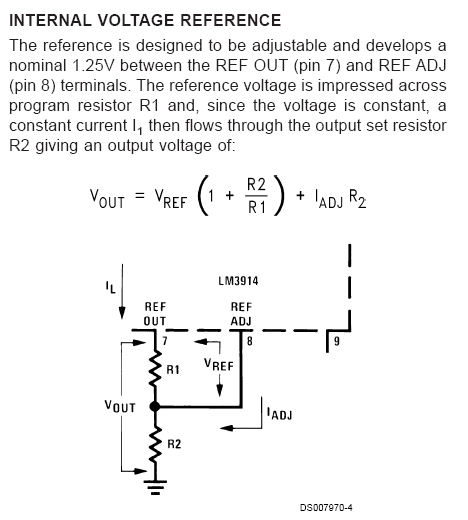

After pondering schematics for the trim indicator,
the reason for it's sensitivity to RF becomes
apparent. The design was never evaluated and
crafted for immunity to RF interference. There
are critical components missing from the design.
I note further that voltage used to excite the
potentiometer in the actuator is the rudimentary
1.2 volts supplied by the internal reference
regulator. An excerpt from the LM3914 specifications
states . . .
[img]cid:.0[/img]
A higher reference voltage increases noise immunity
for the A/D conversion and less jitter or uncertainty
in the bar-to-bar transitions for the display. I would
have considered at least a 5v reference and probably
some higher value still by adding R1/R2 as described
above.

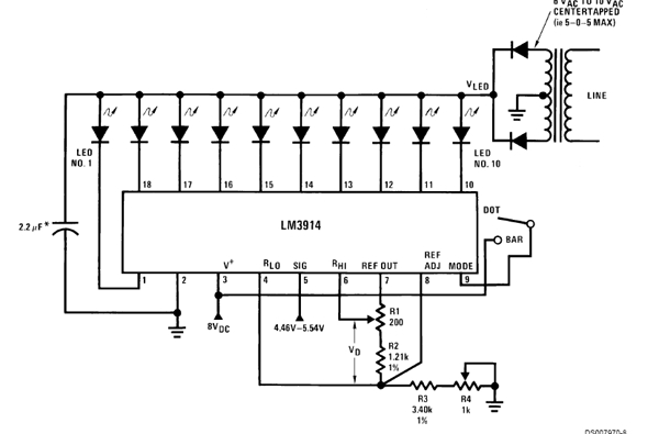

The designers also missed a great opportunity to make
their product truly 'universal' by not exploiting the
expanded scale voltmeter example in the specifications.
[img]cid:.2[/img]
Adding a few components and a couple of pots would
allow the indicator to be tailored to a specific installation
such that full down trim would illuminate the bottom led,
full up trim the top led . . . irrespective of the actuator's
as-installed stroke.
states . . .
[img]cid:.0[/img]
above.
[img]cid:.2[/img]
