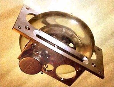

Hi Don,
I think you want one of these:
https://www.aircraftspruce.com/catalog/elpages/racpos12sensor.php?clickkey=35250

I'm looking for some idea on how to implement a trim position sensor.
Attached is a picture of the aileron trim mechanism.
DC motor on the right drives a cogged belt with an idler pulley on the left. There is no limiter on the motor. It can run continuously. When it is unable to pull the bellcrank, the belt begins slipping.
The mechanism works fine. I'm not looking for a new trim mechanism.
But I would like to know where the system is positioned. I thought about a small magnet on the belt and then some type of sensor but I think that would be too coarse.
So I'm wondering if anyone has any ideas on how to implement a sensor.

how about a servo potentiometer geared to the idler pulley

Hey Matt,
I thought about that. But since this isn't a linear mechanism, I couldn't figure out how to implement that sensor.

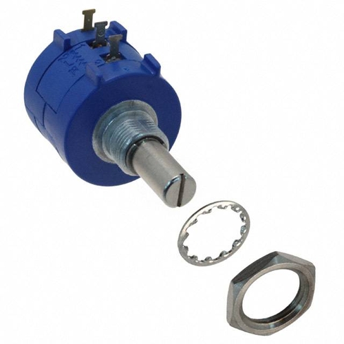

There's a family of ten-turn potentiometers. You
might be able to couple one of these to your
idler pulley.
See http://tinyurl.com/gunkre5

It seems likely that full stroke travel of
the trim system will not produce more than 10
revolutions of the idler pulley. The pot
would be rigged to produce 50% of full scale
voltage with the trim system mechanically
neutral.

put a gears wheel on the shaft of a servo pot and bolt it to the bulkhead so the toothed belt is tangent to and drives the gear.

I can pick up another cogged pulley that has an ID which will fit over the shaft of a pot.
Now I just need to figure out what type of pot. Since the VPX will accept an RAC trim position sensor, does anyone know what the spec's are for that? I'm assuming that it's basically a linear pot.

Unverified.
The value of the pot is very non-critical . . . 1 to 10K would
work . . . it's simply a voltage divider that is biased up
with a 5v source from your EFIS system.
You'll want a MULTI turn pot that will accept more
rotation than what results from full-stroke motion
of the cog-belt against the add-on pulley. Here's
a likely candidate . . .
http://tinyurl.com/gn4rs23
for a 10-turn device to which you can add the pulley
and bracketry to make the installation.

I'm making some progress on this.
The VPX guys say use a 10K linear pot.
I've determined that with the appropriate timing gear that I'll be getting 3/4 of a revolution total. Which means I don't need a multi-turn pot.
And I just happen to have a 10k pot in the drawer (Alpha 813 B10K). And it's got a 1.75" shaft (which is very important since that bulkhead is rather thick). But I can't tell if it's linear or audio taper. At 50% of travel, I'm getting about 6K ohms.
IIRC, if it's an audio taper 10k pot, at 50% of travel, I would be seeing about 3k.
Does anyone know if this particular pot is linear or audio taper?
alec(at)alecmyers.com
PostPosted: Thu Jan 05, 2017 4:33 pm    Post subject: Trim position indicator Reply with quote
Most audio pots aren't really logarithmic, they're a two or three straight line approximation. The 25% and 75% travel resistances should enable a better determination, but the B in the code usually means linear taper.
I'd most definitely use a dedicated servo pot, cheap panel pots wear horribly and lose contact; not much of a deal if your old amp volume knob goes a bit crackly, but probably not helpful in your application.

donjohnston
Joined: 13 Dec 2009
Posts: 232
PostPosted: Thu Jan 05, 2017 4:59 pm    Post subject: Re: Trim position indicator Reply with quote
What's a "servo pot"?
This will provide a visual indication of the trim position. Something that I haven't had before. So if it stops indicating, it's absolutely not a problem. If it stops rotating, that would be annoying, but not insurmountable.
Edit: just did some googling on servo potentiometer... Holy crap! $60!
http://www.ebay.com/itm/Rotary-Potentiometer-Wirewound-3549S-Series-10-kohm-Linear-10-2-W-Servo-/401236171094?hash=item5d6b8a1956:g:7rMAAOSwcUBYQNgh
If that's what they cost, I'll keep tooling around without the trim indicator. Sad
