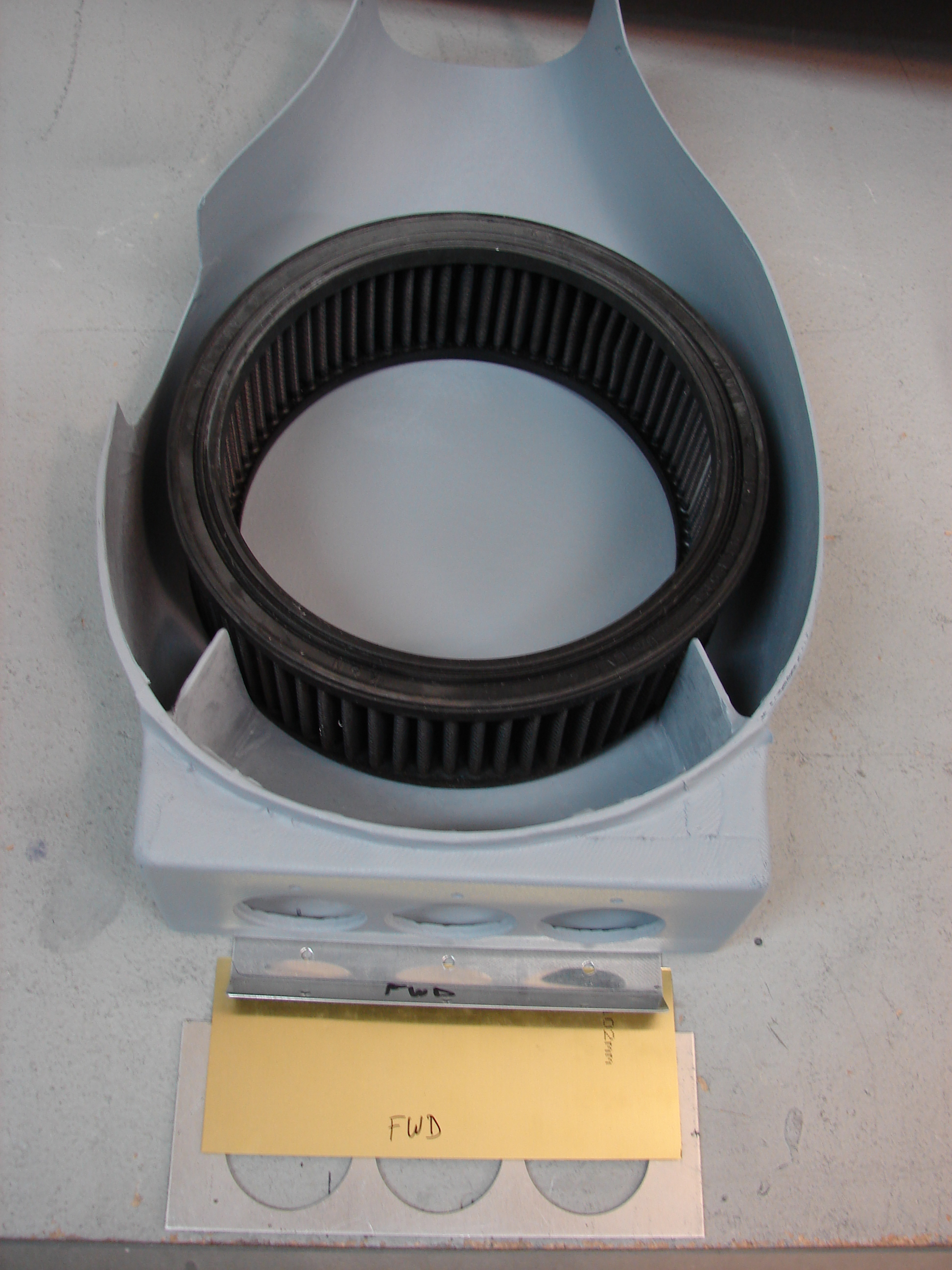

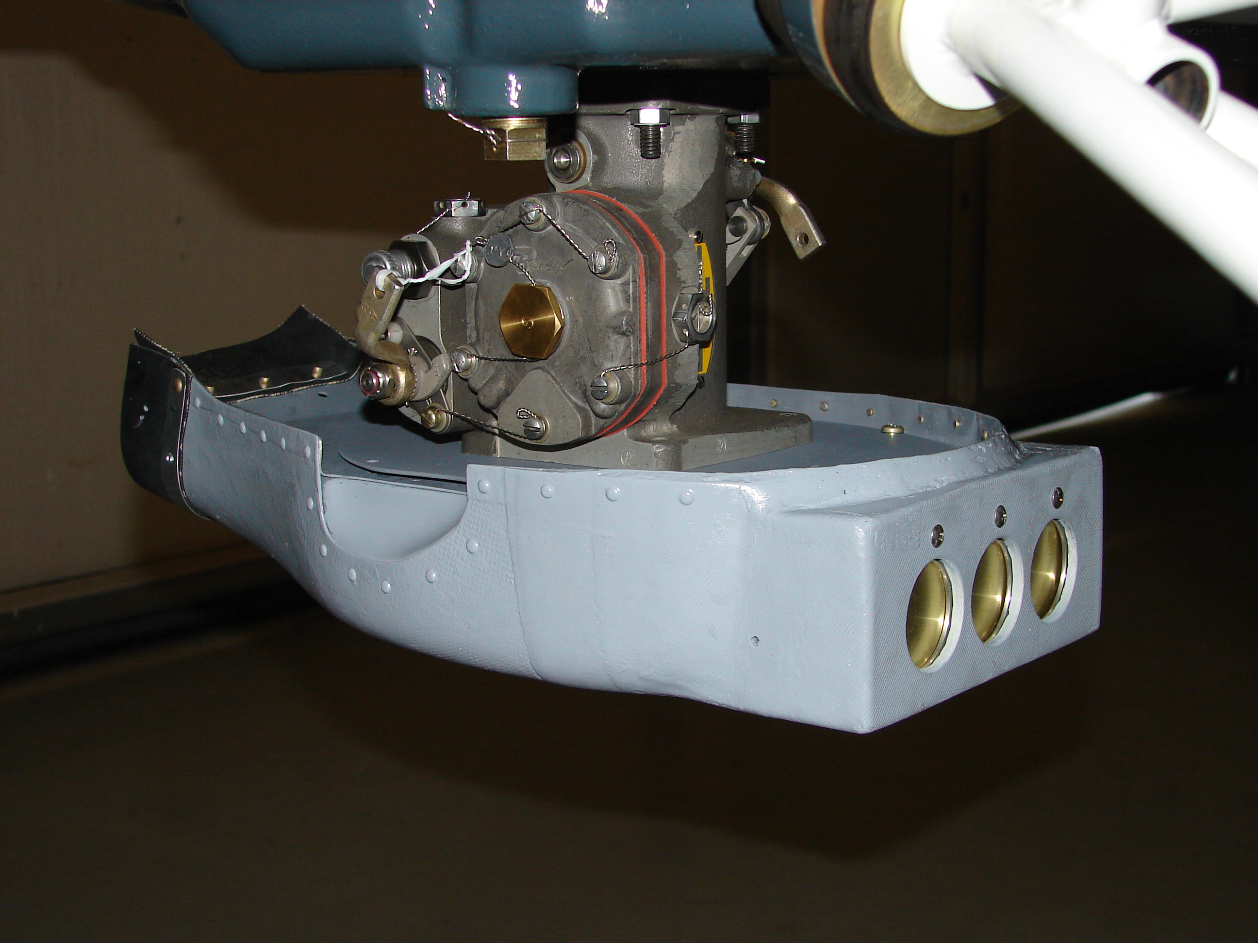

or you can do this

That looks like a very good solution. I don't quite understand how the rear inlets are constructed, but certainly solves all issues with blockage in the front 2/3 of inlet. If you have any other pictures of fabricating this mod, I would be very interested.

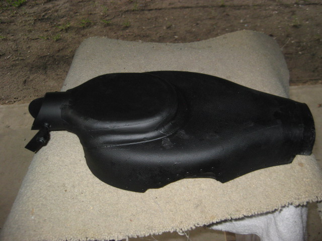

PostPosted: Tue Dec 06, 2016 5:37 pm    Post subject: FAB box Reply with quote
Here's what I did.  I didn't want any control that I could not reset in flight so ......
[img]cid:part1.A2A74A2A.DDC2EDC1(at)cfl.rr.com[/img]
Made a blue foam plug on the FAB and glassed over it. Filed the plate to an oval shape that seals pretty good at an angle in the tube.
