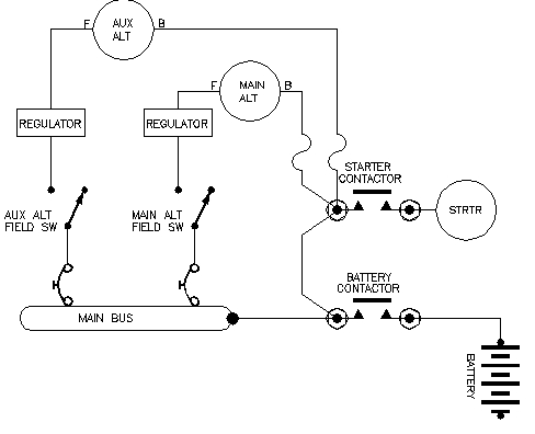

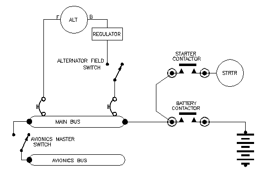

PostPosted: Sun Dec 11, 2016 10:55 am    Post subject: Z-12 questions Reply with quote
At 07:54 AM 12/11/2016, you wrote:
My thinking on the ebus was that the radio has a very small draw when not in use, and the flaps, landing light and fuel pump have zero draw. Having them on the ebus would allow their use for landing in case of master contactor or switch failure, if not for that failure mode, the need for the ebus would be if both alternators fail. Wonder which is more likely.
Your throwing a lot of rocks into the electro-gearworks . . .
First, the E-bus is an ENDURANCE bus originally intended
to offer a simple, plan-B approach to MINIMIZING loads
on limited energy resources for the en route phase of
flight.
The idea was that should the ONLY engine driven power source
become unavailable, then it's entirely possible and
practical to plan for continued, comfortable flight to
airport of intended destination (or a similarly
friendly one where repair resources are available).
In other words, inoculate your system against the
'dark-n-stormy-night' syndrome.
As originally proposed, the E-bus would let flyers
continue with RUNNING LOADS as small as a few amps
with a goal of reaching friendly concrete.
Over the years, the E-bus has been badly mutated
into a collection of band-aids that go to addressing
very unlikely if none existent worries. Worries easily
address by consulting gray-beards here on the List
and deciding just what devices are must useful for
meeting the ENDURANCE mode design goals.
Z-12 was the next evolutionary step for replacing
a pieces-of-(at)#$# generator on Bonanzas with an
alternator having about 4-5x the output and 100x the
service life. . .
It was never being suggested as the elegant solution
for a clean piece of paper design. I'm not suggesting
that it's not going to perform as intended . . . in
fact, it's a perfectly satisfactory alternative to
the legacy architecture typical of a few hundred
thousand spam cans (the vast majority of which will
not be center stage in a dark-n-stormy-night story).

If you're well down the road with Z-12 then I would
recommend ditching e-bus, and anything resembling an avionics
bus. With a robust second alternator, you will not
be energy deprived for the en route phase of flight.
Just reduce loads till the alternator loaded light
stops flashing. This holds ALL of the battery's
contained energy in reserve for descent and approach
to landing . . . turn on anything else you want to
have (short of the air conditioner).
[img]cid:.1[/img]
Loosing ONE properly selected, installed and maintained
alternator is very unlikely. Loosing BOTH alternators
is on a par with being hit by an incoming meteor.
if Z-12 is good for hundreds of Beech, Piper and Mooney
airplanes obsessed over by hoards of folk paid good
salaries to WORRY about everything . . . then it's
golden in your projct.
