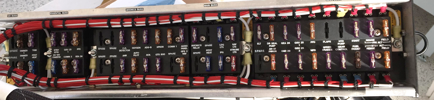

Here’s some background info. We have a fuse tray that pulls out of the panel holding blade type fuses that light up when they’ve blown -- saved a bunch of real estate on the panel. The landing gear are powered by an electric motor driven hydraulic pump that can pull almost 80 A at times. On the first occasion the field fuse blew I’d eventually attributed it to being because one of our two PC680 batteries (in series for 28 VDC) was heat damaged from sitting down stream of the oil cooler and was not holding a charge well and maybe not compensating for the big current draw from the hydraulic pump motor as well as it should. The battery issue was corrected (replaced) a couple months ago and all has been well until this morning when the field fuse blew again on landing gear extension.
On both occasions the fuse blew on landing gear extension which seems to be the least loaded gear operation since the weight of the gear and their gas spring struts want to deploy the gear anyway – the pump can barely keep up. But, we do have a modification to our landing gear system where the inboard gear doors close after gear go down and the pump typically cycles very quickly several time while it’s closing the inboard doors. For more background, we splurged on expensive hermetically sealed contactors rated for 100 A continuous for switching the hydraulic pump motor -- Tyco Kilovac EV100 relays with built in voltage suppression diodes.

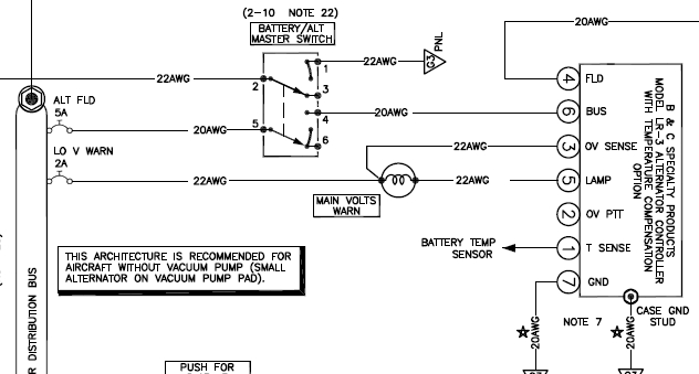

On another matter, using fuses upstream of the crowbar
OVM system is not recommended. This excerpt from Z-12
[img]cid:.0[/img]
. . . shows a circuit breaker feeding the LR regulator's BUS terminal.

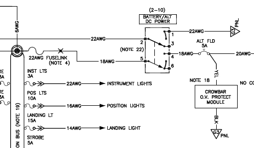

The reason for this is based on the precise difficult you're
wrestling with now . . . it's difficult (some cases impossible)
to replace a nuisance tripped fuse on the OV protection system.
[img]cid:.1[/img]
For other architectures where crowbar ov protection is
installed in conjunction with fuse blocks, we show a
FUSIBLE LINK upstream of the alternator field breaker.
Modifying your regulator is probably the solution for
nuisance trips . . . eliminating the ATC fuse in favor
of a 5A breaker is the solution for graceful mitigation
of nuisance trips.

Our fuses are crew accessible in flight. The tray pulls out from the right side of the panel with all the fuse blocks facing the pilot. The Primary Alternator Field fuse is the first one. So, we’ll go ahead and stay with the fuse unless there’s another reason to go CB. I can’t find a good photo to show how it is set up. These two photos should provide an idea. See the face plate with a little pull ring on the right side? That’s the fuse tray face plate, a two foot long fuse tray slides out from there. The second photo shows the fuse tray.

That's a beautiful job on the fuse panel
no doubt deserving of honors for craftsmanship.
But my best wish for you is that when something
stops working, that fuse panel is the FURTHEST
thing from your mind while you concentrate on
a comfortable termination of flight.
