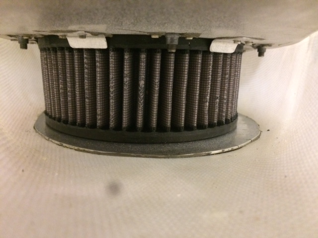

PostPosted: Mon Dec 05, 2016 6:58 am    Post subject: Filtered Air Box options Reply with quote
Thanks to all who responded.
Phillip
Do you have any photo of the rub plate you are recommending?
Best

PostPosted: Mon Dec 05, 2016 12:04 pm    Post subject: Filtered Air Box options Reply with quote
I don't have a good photo on my phone apparently.
So I just took this one down the snout. I used .063 because I wanted something really firm to suck up tight against the filter. Primarily to reduce the likely hood of deformation.
Mine is pro-sealed in and looks like a donut. The filter bypass sits in the middle of the donut hole.
