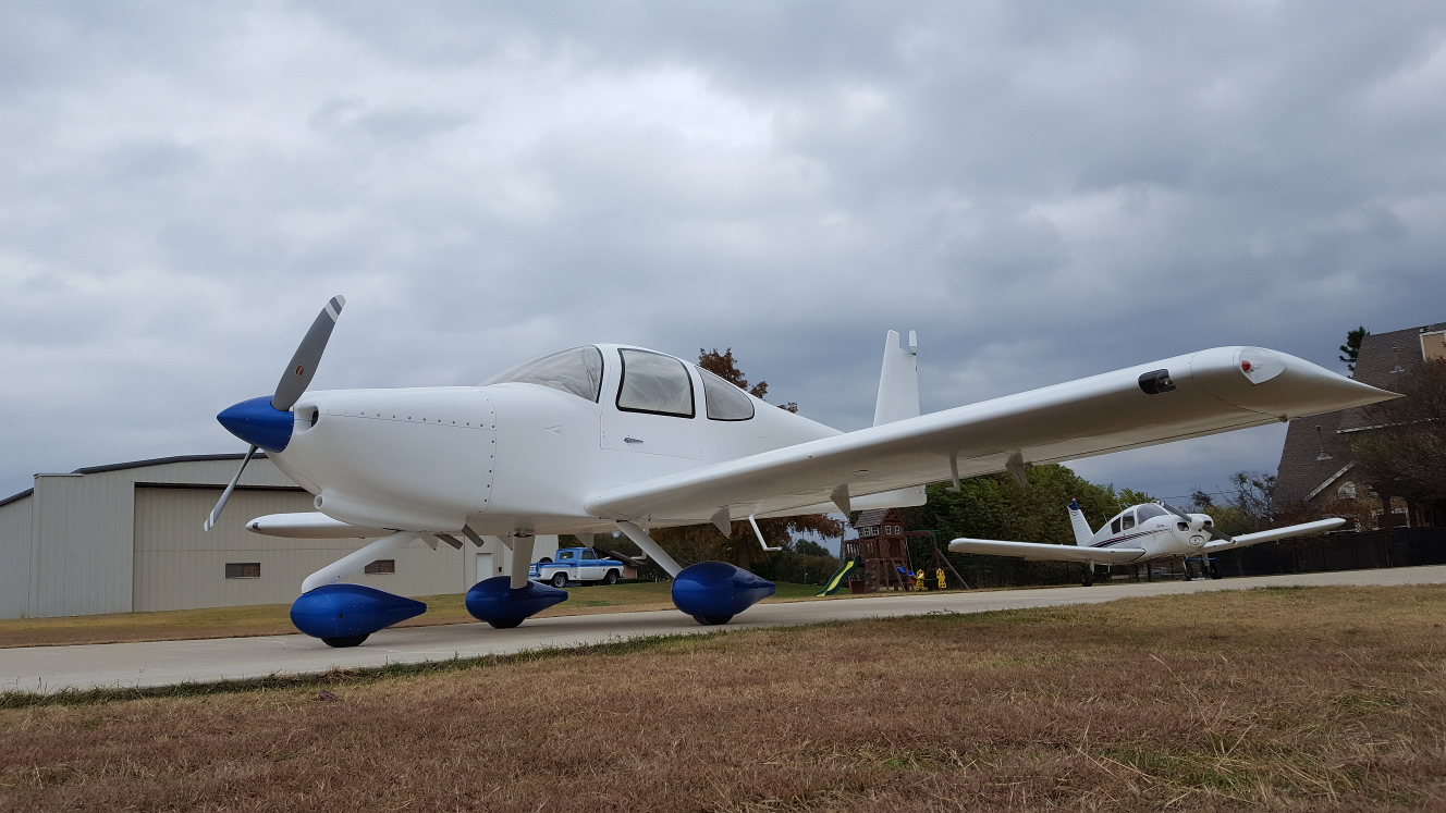

I placed an order with Sandy at Loehle back in September.  I received everything but my Wonderfill, it was marked as backordered.  I tried contacting them in October and November to find out where my order was, and never could get in touch with anyone.
My gut tells me they have just quietly shut the doors, and not notified their customers.
I have used their product to completely prep and prime the plane.  I am not to happy with it, as it orange peeled pretty much the entire project.  It is going to require some elbow grease to smooth things out before I paint.  But I want to finish the plane and get in the air for a year or so before I paint, in case I want to do any post-build modifications.
I am not sure what you are needing at this point, but I found a good replacement for Wonderfill was Dolphin Glaze.  Takes a little more sanding, but fills the pinholes, scratches, and imperfections a little easier than bondo.  Here is what I used to finish things up, my local paint supplier carries it for around $10.
I have played with some paint, I decided to go with what Vans uses; Valspar 852 Polyurethane.  This is a fantastic product, and looks great, see the metallic blue on my pants and spinner.  When I finally decide to paint the whole plane, this is what I will be going with.
Attaching an image of what things look like right now.
Good luck!
Vernon
Good luck!
Vernon
[image: Inline image 1]
