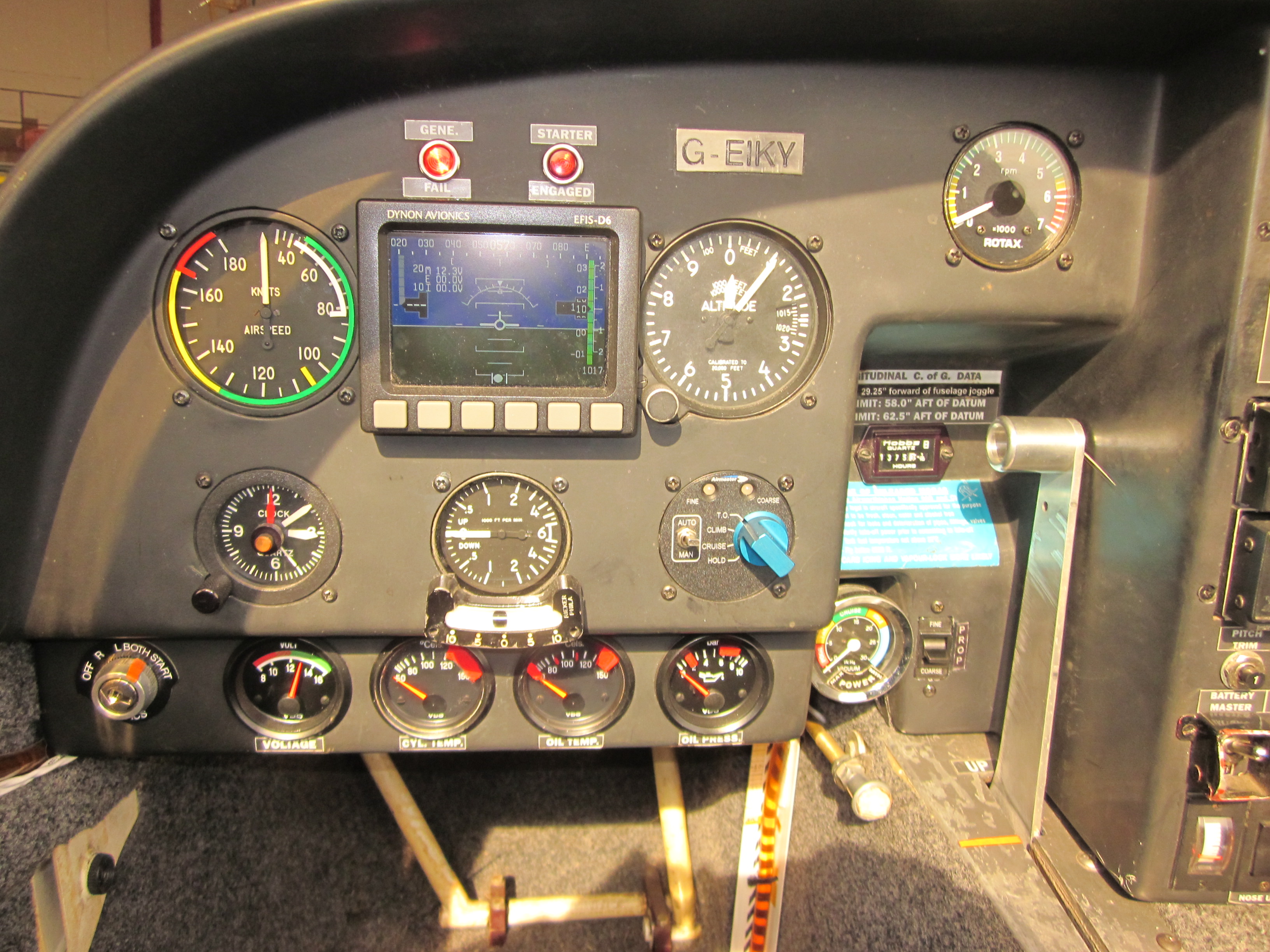

JonathanMilbank
Joined: 14 Apr 2012
Posts: 397
Location: Aberdeen area
PostPosted: Fri Dec 02, 2016 3:27 am    Post subject: Re: 10 inch Dynon in a Mono Reply with quote
Here's my solution. Really all I wanted to do was to replace the old dead electric A/H, but for not much more money this is perfect for VFR only.

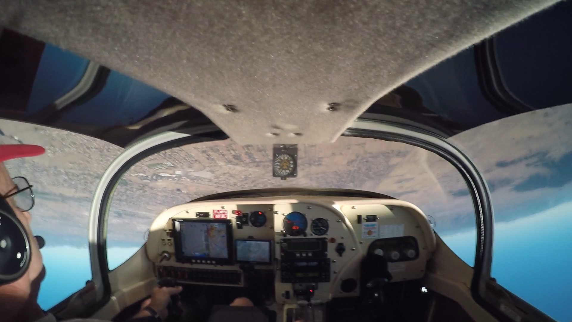

PostPosted: Fri Dec 02, 2016 9:27 am    Post subject: Re: 10 inch Dynon in a Mono Reply with quote
Here is a pic of the 8 1/2" GRT Sport SX in my Tri-gear. Very happy with the unit.

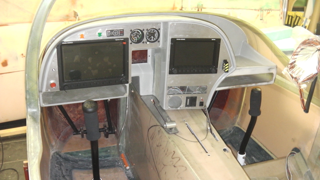

spcialeffects
Joined: 29 Aug 2012
Posts: 306
Location: Kent
PostPosted: Fri Dec 02, 2016 11:48 am    Post subject: Re: 10 inch Dynon in a Mono Reply with quote
Dynon is an excellent choice.........I have 2. The only modification to the panel needed is to chop out a bit small bit of the panel moulding for the top left of the screen to allow you to get it into position

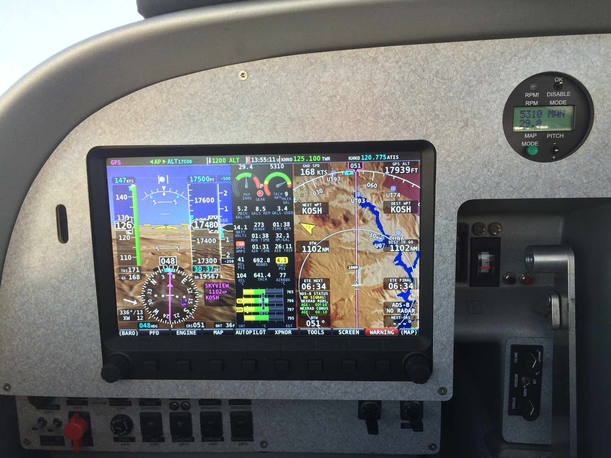

PostPosted: Fri Dec 02, 2016 12:05 pm    Post subject: 10 inch Dynon in a Mono Reply with quote
Hi Martin,
I installed the 10 inch Dynon in my mono.

It is a tight flight, however, the modification to the panel was minimal and does not encroach on the gear retract space.
Erich Trombley
N28ET Classic Mono
