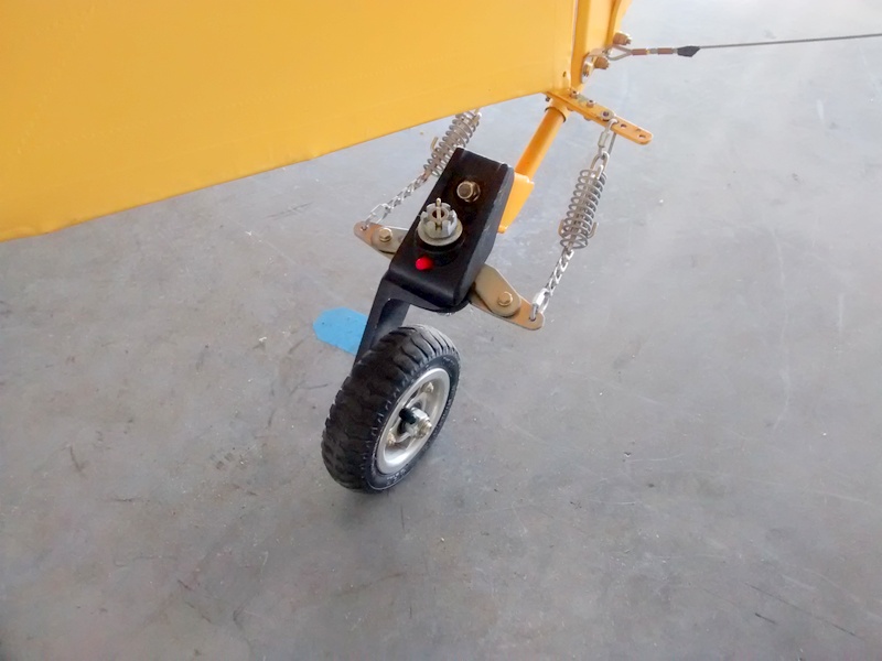

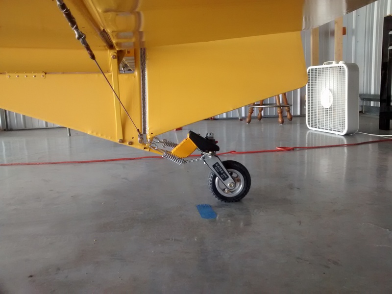

Had many, many problems with my tailwheel. Finally found the right combination that would give me good control in a crosswind and still be able to release to make a tight turn if needed. Tried many combinations of linkage ratios, springs, and mounts. The tailwheel pivot angle should be vertical or tilted back a few degrees. I had to make a custom mount to achieve that. I also went to a 6" pneumatic wheel. See attached pictures.

Interesting. Looks to be a bit of work making it work. The solid rubber tail wheel I have makes a pronounced thump going over runway expansion joints.
I used the factory optional full swivel tail wheel. The factory setup was easier to mount but not ideal. They supplied light springs which allowed the tail wheel to rotate enough to unlock but also unlocked when I didn't want it to.
It looks like Rex had to adjust the ratio to get his to unlock also. The factory optional tail wheel allowed me to drill holes in board to attach the control chains so the tail wheel would unlock. I then installed compression springs. No more unlocking in cross wind taxi.
I see Rex left some slack in the control chains. I'm old enough to remember cars that had slop in the steering and never liked it. My tail wheel chains are just short of tight. I can taxie fairly fast on hard surfaces, even turning onto taxiways at speed with confidence.

Rick is correct about the slack connections. I tightened them up after some more tests after the picture was taken. I forgot to mention that.
