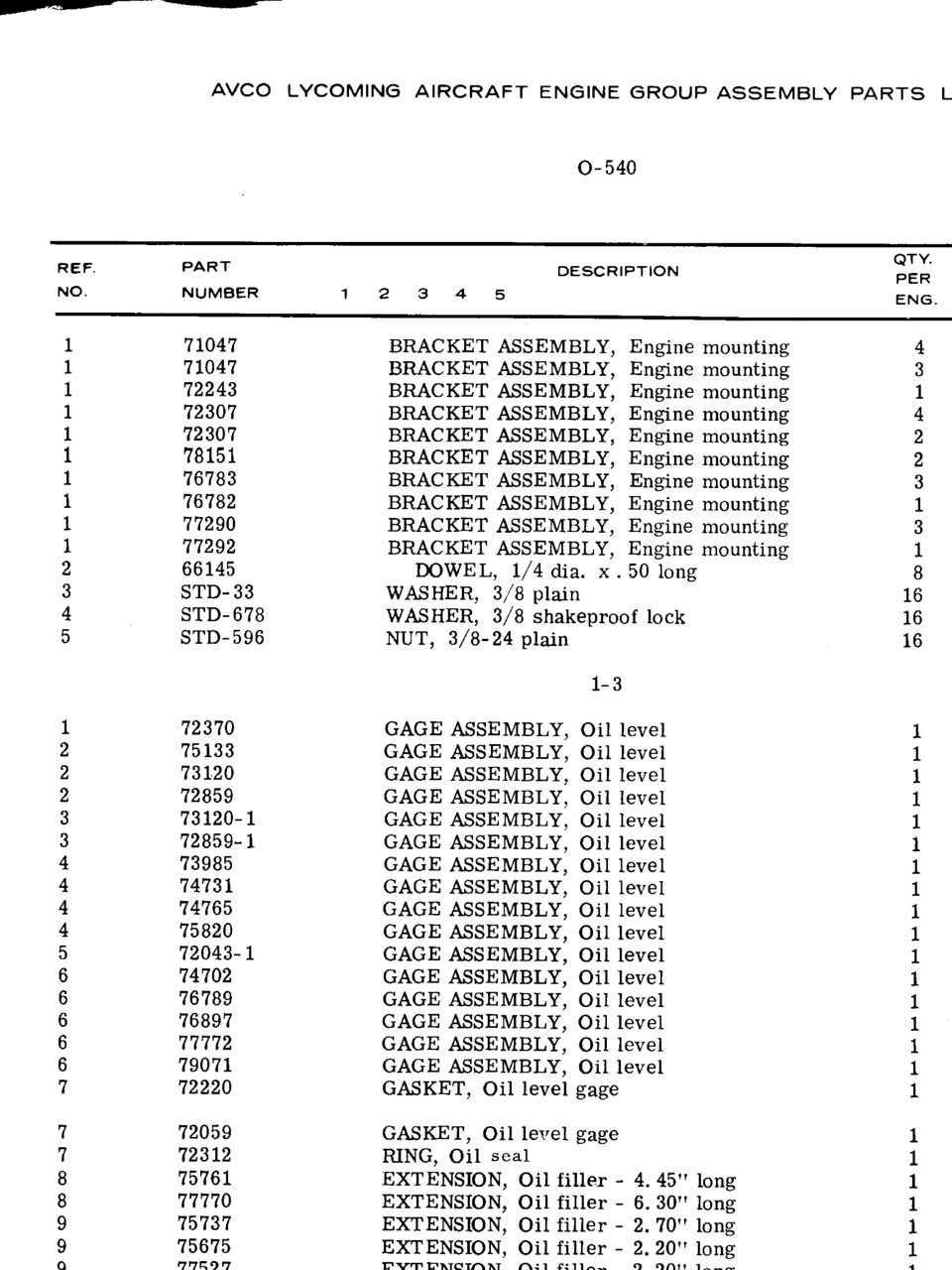

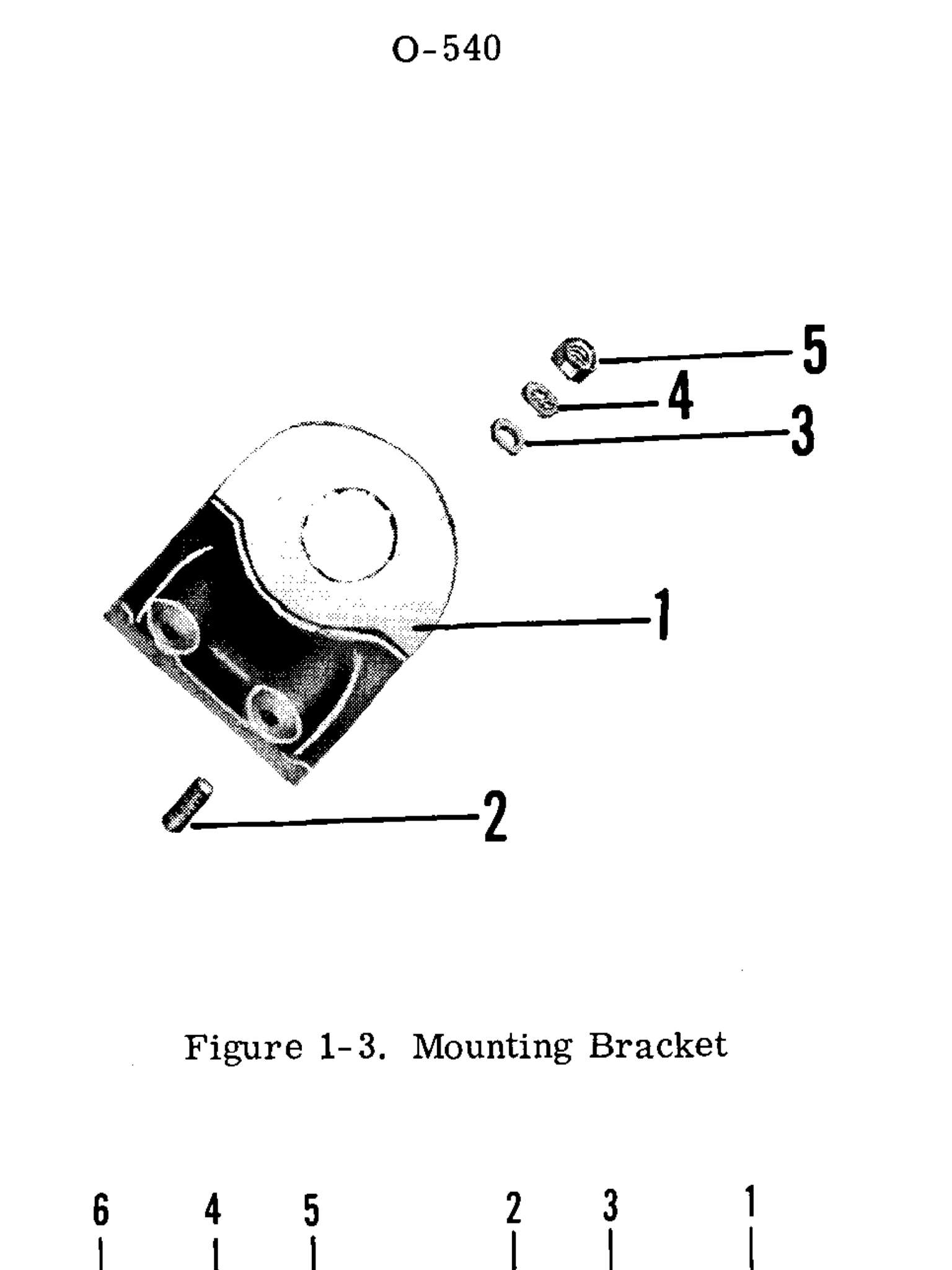

I've searched the manual, no pictures of the "ear mounts", but basically "yes" always install lock washers next to the nut. The purpose of the lock washer is to grab the nut to keep it from backing off. Hope that addresses your issue. Later, - Lew

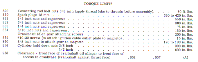

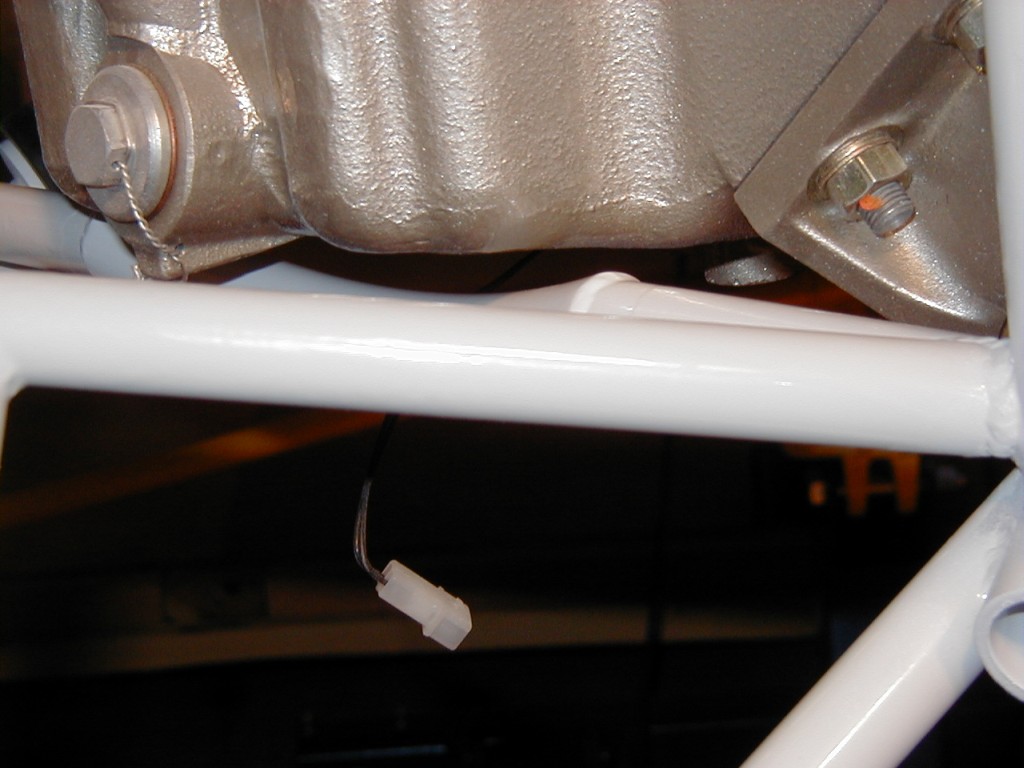

I just took mine off today to attach a better ground path to the block. Mine only had 2 studs per ear.
I need to check the torque in the manual to confirm it's 100% correct, but I torqued the nuts to 15.5 lbs per Vans Section 5 torque specs.

On Nov 28, 2016, at 7:20 PM, Lew Gallagher <lewgall(at)charter.net> wrote:
Hey Carlos,

PostPosted: Mon Nov 28, 2016 5:16 pm    Post subject: Re: Installing engine mount bosses to the engine Reply with quote
Hey Carlos,
Jesse's diagram is boss! Here's a picture from Tim's build. Later, - Lew

PostPosted: Mon Nov 28, 2016 8:01 pm    Post subject: Installing engine mount bosses to the engine Reply with quote
I got back to the house tonight where I can see the Lycoming overhaul manual.    The correct torque for the 3/8" bolt is 300 in/lb.
My 'ears' only have 2 studs to put nuts on and they're 3/8.   If you've got 4 studs, then I'm not sure what yours are.  So here's the entire torque limit chart in the manual if yours are different.
Phil
[img]cid:ii_158ae3a6a7e7d017[/img]
On Mon, Nov 28, 2016 at 6:53 PM, Phillip Perry <philperry9(at)gmail.com (philperry9(at)gmail.com)> wrote:
