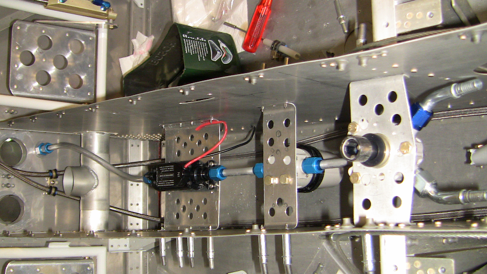

PostPosted: Tue Nov 22, 2016 1:32 am    Post subject: Fuel Valve Mounting Bracket Reply with quote
Dave,
that is an interesting statement, as according plans facing down is correct. As I did another setup (Andair) I had to swap it as well; a long 3-4" drill bit and a good, deep mark in the center, did allow me to drill it out, slightly bend in the middle. I did use a bucking bar on both sides and had the mushroom set on the outside bucking bar (you need a helper!) with that approach I was able to set that last rivet however it took 2 attemps!
[img]cid:part1.06DD0867.ED6FB5E0(at)gmx.net[/img]
Werner
