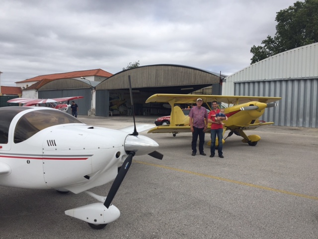

PostPosted: Fri Dec 09, 2016 1:04 pm    Post subject: Cowling (Airmaster) spinner gap Reply with quote
[img]cid:43C1E951-C685-4B80-BC03-37FDF0BA208A[/img]
Dave Park
Mine is no more than 3/8inch
Regards Dave Park
