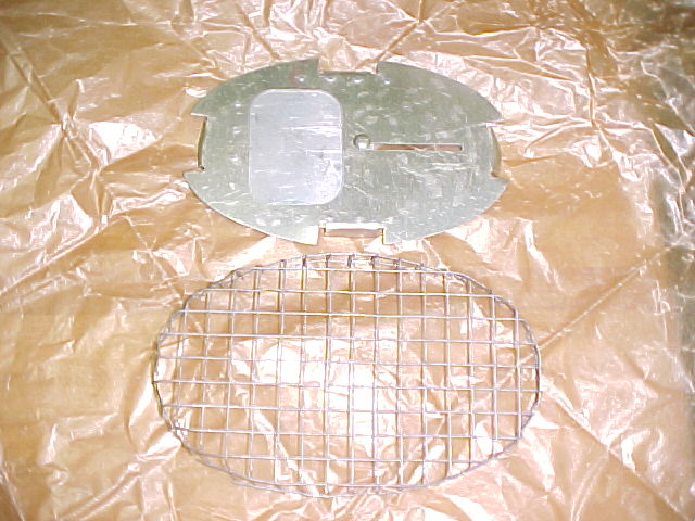

Or you can install a winterization kit as in the attached photo.I think I may still have some fitted cowl blankets also.
Doug

<MVC-012F.JPG>
