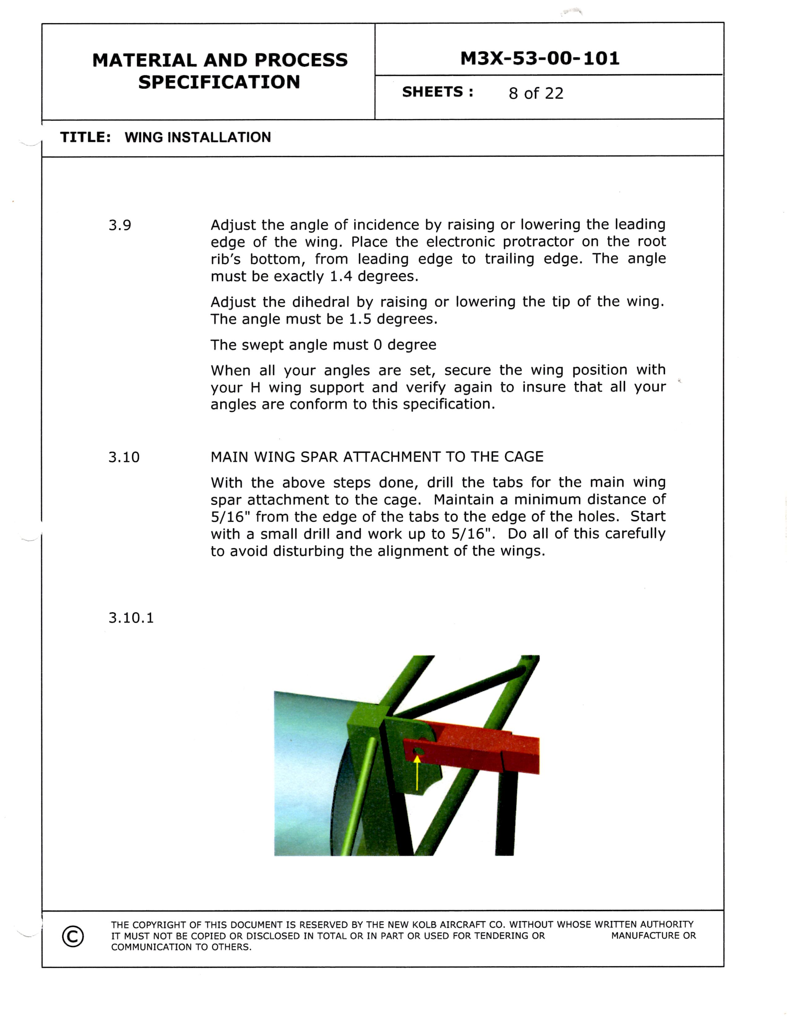

From where did you get the 1.4 degree incidence setting and from where is it measured? I believe Bryan's recommendation is 2.8 to 3.5 degrees set using the engine mount as the zero reference. I urge you to go for the minimum recommendation.Here's why; the X was developed to improve the performance of the C. To do it the cockpit truss was lowered at the front in an effort to decrease the angle at which the two plane surfaces on the bottom of the fuselage meet. Barnaby (Wainfan of the Kit Planes "Wind Tunnel" column) wanted to get this angle to somewhere below 15 degrees so the air could follow this abrupt change (with a very small radius between) a bit better than it did on the C. He failed to see that when he did this the new wedge shaped fuselage would be at a negative angle in cruise flight. What you ended up with was a wing trying to go up and a fuselage and tail trying to go down. Not very efficient (the Plane from Hell, a C converted to an X, had actually caved in the top of the nose cone from the pressure).
So, as I heard the story from Travis, Bryan began experimenting with reducing the wing incidence. In doing that he had to reduce the angle of the HS and when those two came right he then needed to make the main landing gear legs longer to make the aircraft rotate better at take off.

I got that info straight from my manual... I do have the 11th Mk3 Xtra.. So there maybe some differences from the newer models... I did set the wings at 3.4 last night which put me inline with the tab on the wing root but now the wing root is in contact with the flap tangs that stick out through the fuselage... And when I moved the wing outward to clear the flap tangs now the wing root tab that mounts to the fuselage is to far out to be pinned to the fuselage... Something is not right!..

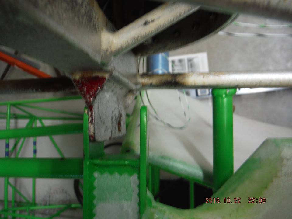

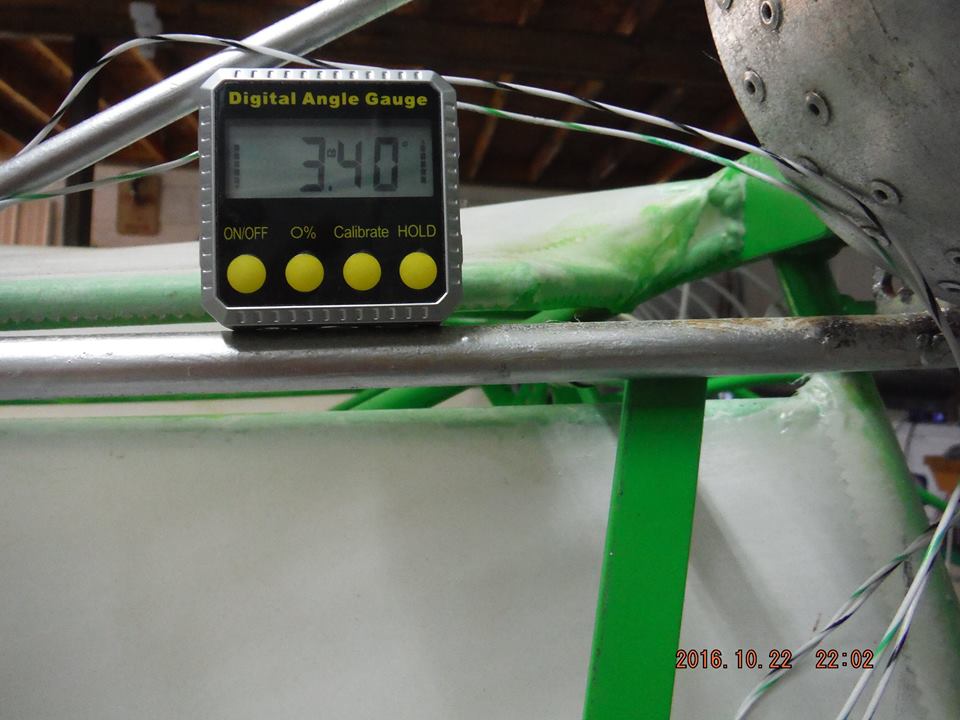

here are a few pics of what I'm dealing with... The wing is set at 3.4 degrees and is in contact with the flap tang/flange...

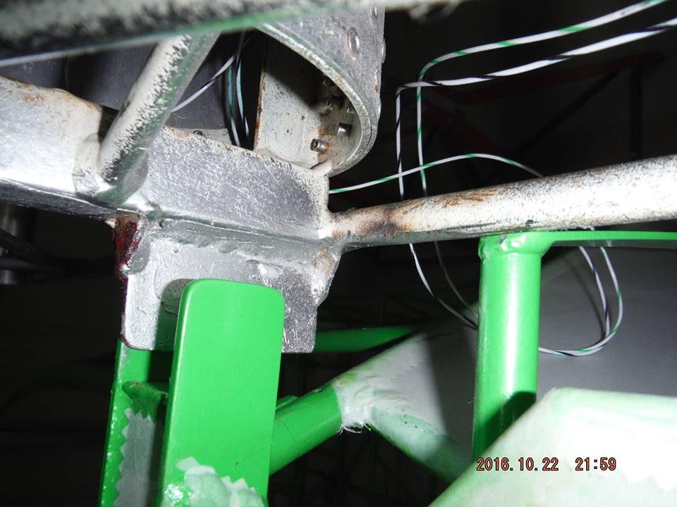

here you can see the contact between the flap flange and the wing root when set at the 3.4 degrees... if I move the wing out then I dont have enough room to pin the wing root to the fuselage...

there is an easy fix for this... If I'm doing this correctly... it looks like the flap rod that goes out to each side could be cut down a little and replaced... but I need to know what I'm doing is right before I go cutting stuff...
I did do a search on incidence and it seems the older kolbs with the short landing gear used a different angle of incidence... ok I have the old version, but I have the newer longer curved landing gear...

Isn't that root rib mounting tab in the wrong location? Been a while
and the one I rebuilt was a MkIII C.. Herb

It was bought as an unfinished kit... some of the parts were assembled when i bought it... at some point i think some of the parts where stored outdoors... the fuselage was pretty rusty before i had it powder coated so it looks newer than the wings...

PS Found the incidence numbers I used, although setting the motor mount at
zero is a PITA, you end up the nose on the ground and the tail in the
rafters. :-}
1) with motor mount set at level in BOTH directions, i.e.--0 degrees
2) boom tube should be -6.1 deg (mine was!!)
3) hor. stab should be -4.6 deg
4) dihedral should be 1.6 degrees per wing (I chose 2.7, because my
diagonal struts were already made. When repositioning the wings to the new
lower position, this has the effect of adding dihedral)
5) main wing should be +3.4 deg, but this has been revised to +2.8 deg
After looking at the numbers I began to wonder if you aren't confusing the
dihedral setting with the incidence setting. Just a thought.

I have an Xtra that is the same vintage as yours (within 2 numbers). I ordered a MarkIII and then changed it when the Xtra came out. I called Brian in July, 2011 when I started final rigging. The numbers he gave me are very close to Rick's.
At Motor mount of 0 degrees, wing is 3.4, boom is -6.1, horiz. stab is -4.8 (I have the larger horiz. stab.).
I set my D.H. so the tips are about 2 1/4" high each side.
I also have the longer heavy steel legs from Kolb. Be sure to take several readings and average them. Those numbers have worked great for me. I think the u-joints on the wing can be turned upside down and that also Kolb has make some a little different. I don't remember the details or exactly what I had to do to get his numbers. I do remember that it was a lot of hassle going back and forth. Change one thing and you affect everything else. You might call Brian if nothing seems to work.

I just got off the phone with Bryan at Kolb and he told me to set it up like the mk3 classic... lol
