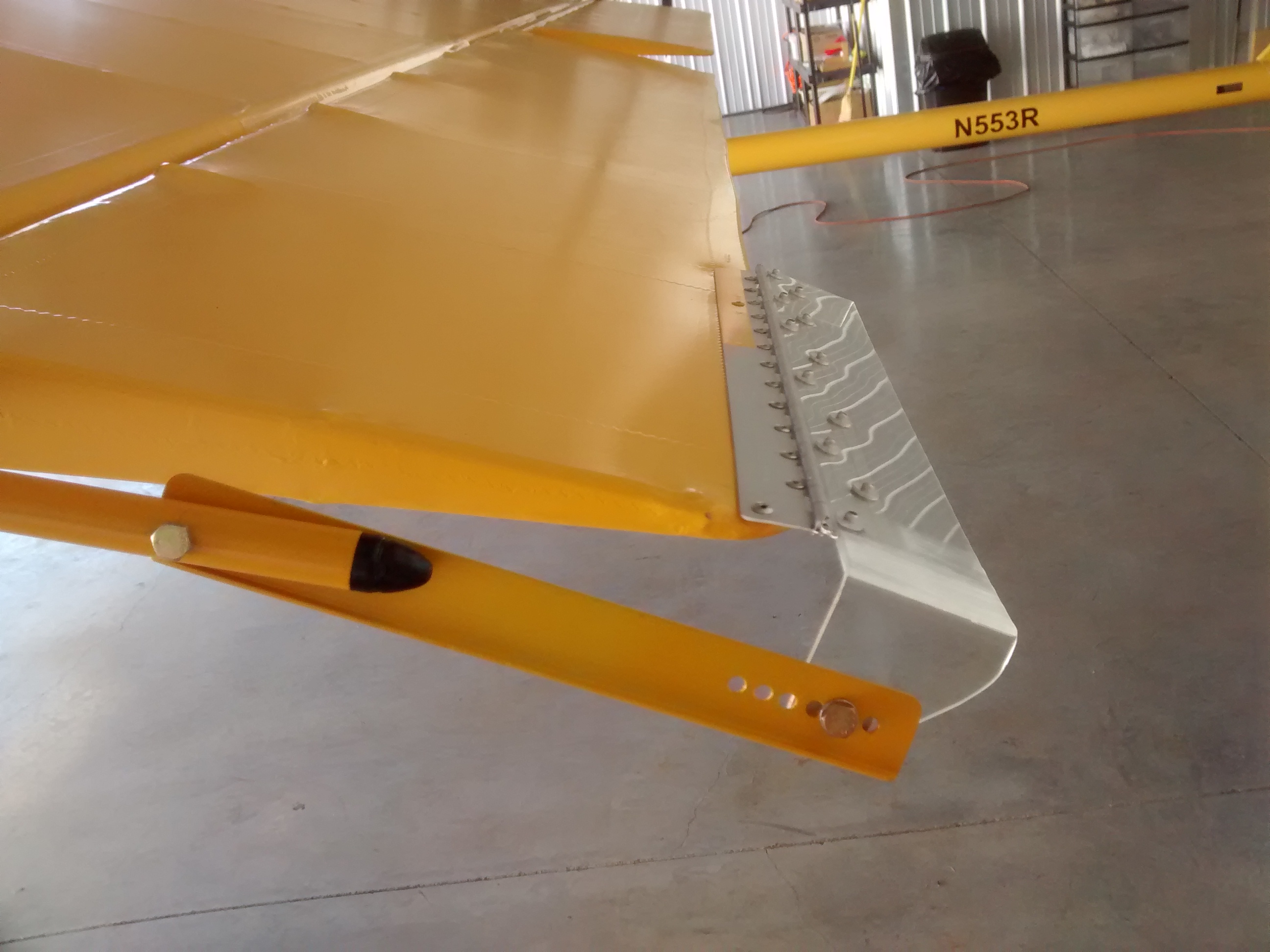

Thanks to all for the aileron trim suggestions a few months ago. I made an adjustable trim and then had to add a little bit on the rudder trim for the extra drag. See attached pictures.

my curiosity is getting to me......  the picture of the aileron trim.... can you take another picture from further away...  is the trim tab mounted dynamically?   does it flex as you move the aileron?    or is it fixed?     what is the rod that the linkage is mounted to?
I have the aileron counter weights on my mkIII....   but they go from the aileron torque tube forward....     Assuming they are dynamic and move as you move the ailerons..   do they reduce some of the stick pressure like a spade would do?   and then maybe I am over imagining things here....

Boyd, It's a fixed tab mounted to an extension of the aileron counter-balance. I'll send a pix tomorrow.
