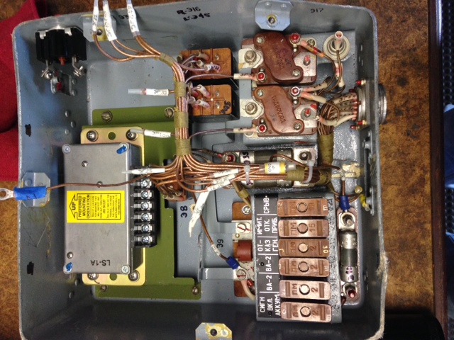

Just new on this forum… I'm in the process of installing a 35A B&C to replace the stock generator. I think I have it pretty well figured out but would like to get a second opinion if someone has done the conversion on a 52 before. Jill and Carl at M14P have a partial procedure but it's a work in progress.

George Coy was kind enough to send me a procedure that he submitted to the Yak design bureau several years ago. They turned it into a service bulletin. It specifically addresses the changeover to a Jasco alternator but is generic enough to give me the info I need. Thanks George!

I am also installing a B&C alternator on my yak 52. I have looked through the list and have not been able to answer my questions.
1. What to do with the old voltage regulator wires down on the floor. Do the need to be connected together some way or they totally redundant with the new regulator?
2. I see in the picture of the previous post all the reverse current relays have been removed. Is that necessary or just for a cleaner installation?
Lastly I would love to speak to anyone who had done the conversion off line for any advice to avoid the common pit falls.
