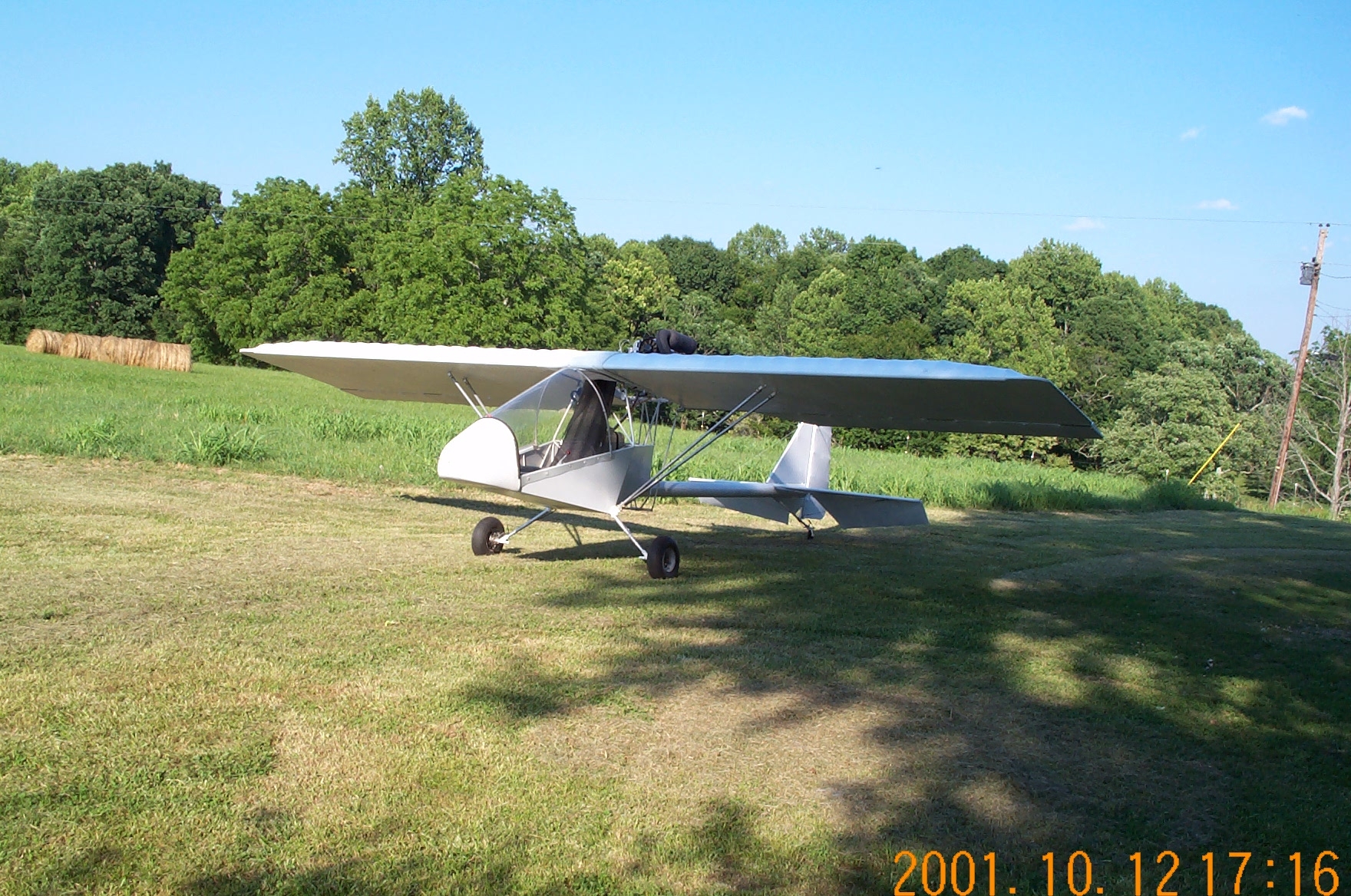

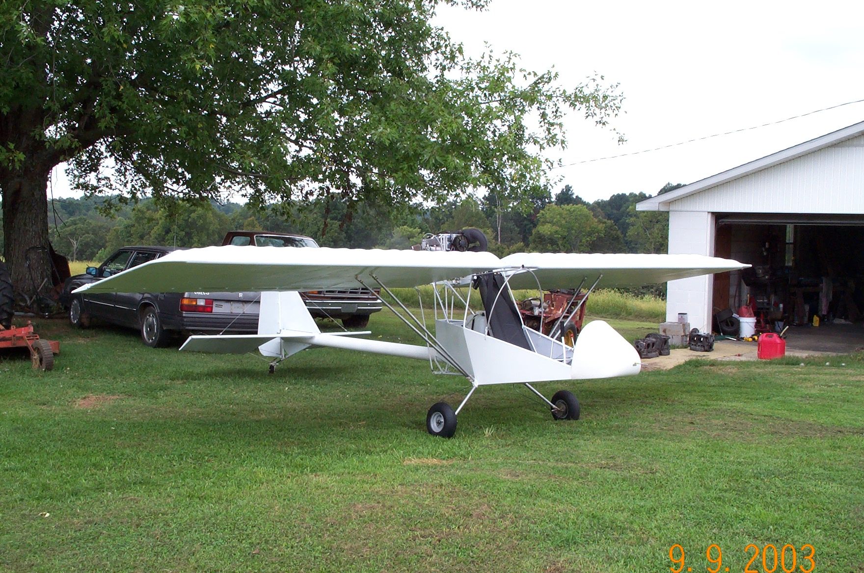

  I have installed full enclosures on two Fireflys...I did a gull wing enclosure on my MkIII..
   easy to do...the 1/16 lexan just lays over the nose cone... a 4x4 sheet works...was 35 to 40 bucks here in Tenn.. Lay the paper covered lexan over the nose cone and rear bow that you have made and do a rough marking of the size...over sized a bit but to shape ..this makes it easy to clamp and handle. Once the shape is made then move on to mounting..I let the Lexan lay over the nose cone by about 1 and one half inch..enough to allow the rubber seal to clear the front  of the cone a bit... 1/8th inch...will do..
  Making the rear bow is not science...just bend it carefully and try not to go to round such that it is sticking out any further than need be...Guess your shoulders would dictate the bow size..Oval is good..toward flat.on the sides.. The top of this bow is braced by another bow that runs rather horizontal to the cromolly verticals that attach to the spar carry through..this is attached to the cromolly tubes with gussets and that tube and rear bow meet and are gusseted to one another..on the top...
  I install a stop screw and decorative washer at about 10 am.. thru the lexan to the  cone..I raise the lexan up to a comfortable entry position and install that screw...I also note where the lexan is on the rear bow and install large head rivets from there down to the end of the bow on that side(left)  I install a powder coated white angle aluminum on the top of the left longeron and fasten it in maybe three or 4 places then fasten it to the lexan from nose to bow I attach it to the bottom of the rear bow but not to the nose cone....I use the decorative dimpled washer and flush screws there...then once the lexan is down on the right side...I mark the paper covering and install white angle aluminum there also..from  nose cone to bow..At the nose end I install a tapered screw of my own making I flatten or grind it flat  and attach it to the aluminum angle   ..I drill a hole in the nose cone bracket such that the tapered screw fits snugly and holds a good wrap around the nose cone.. before you do this install the rubber seal on this end of the lexan..some hold it with silicone but I use the 3m black weather seal...Trial fit the rubber seal and tape the lexan on both sides so that the rubber goo that squeezes out of the seal does not get on the lexan beyond where it is intended to go...I use good auto paint tape here...Then  install the tapered screw on the angle that is attached same as the angle on the left side...now...make a sliding latch that is captured by the aluminum bow that the rear of the lexan lays on...you can make some sort of prop...to hold the lexan open for entry/exit ...i tended to use my head... naturally the right side angle is only attached to the lexan... and it is good to make a stop on the sliding latch such that is cannot rise up the bow..though the slip stream should be fine for that...
 Clear as mud?  Herb
 my cost is usually the price of the lexan...maybe total of 50 bucks..

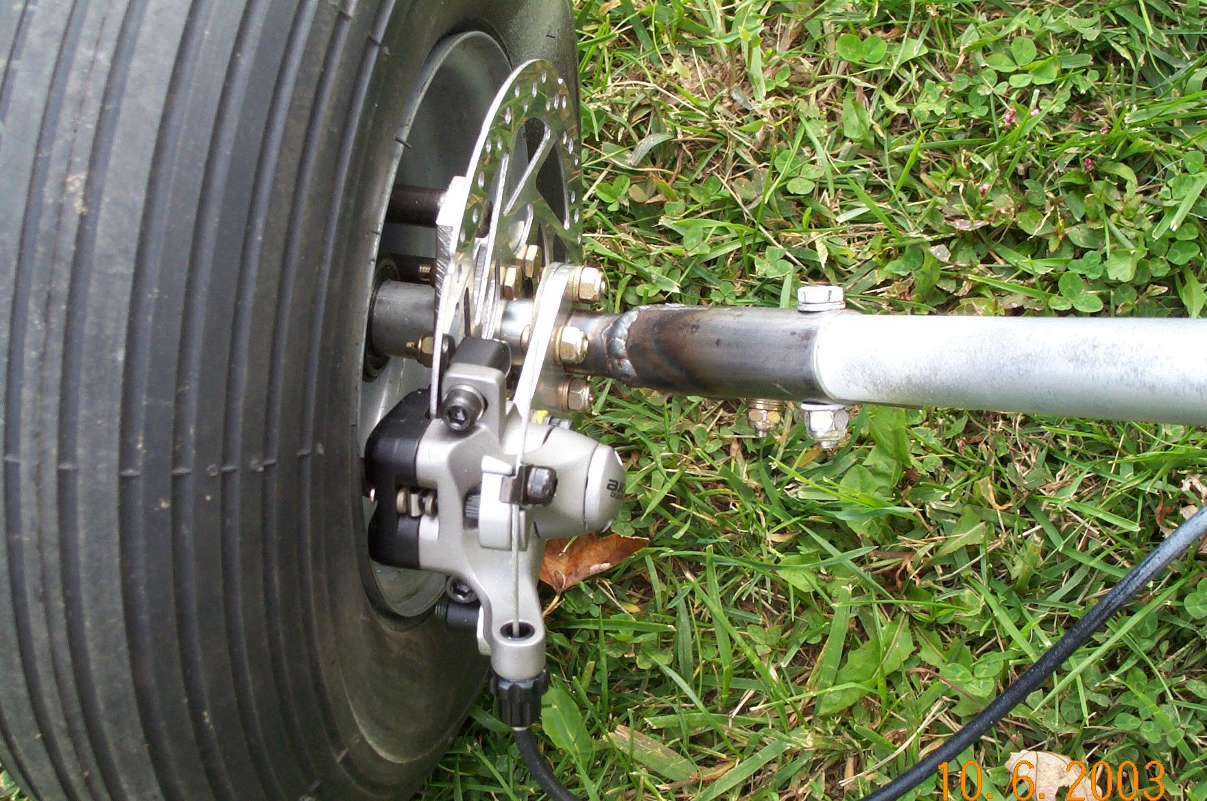

 oops...brakes...I use mountain bike brakes..they come from the salvage yard on bicycles ...front only usually...meaning that one side mounts with cable forward and the other side rearword..
   I turn aluminum spindles to mate the disk to the rim..I have good luck using the two piece spun rims...they are true...
 The hard part is mounting the caliper...here you need to make an aluminum plate that slides over the axle and mounts to the 4 holes in the large washer that is part of the kolb axle..from here it is a matter of a spacer,trial and error, to get the disk pad/caliper/disk distance correct. a cromolly tube that slips over the axle and sets the distance from disk/rim  to caliper... is the spacer..
 In the pics..notice that I left too much lexan on the left side..need only be 1/4 inch below the longeron..
 Clear as mud?  Herb
