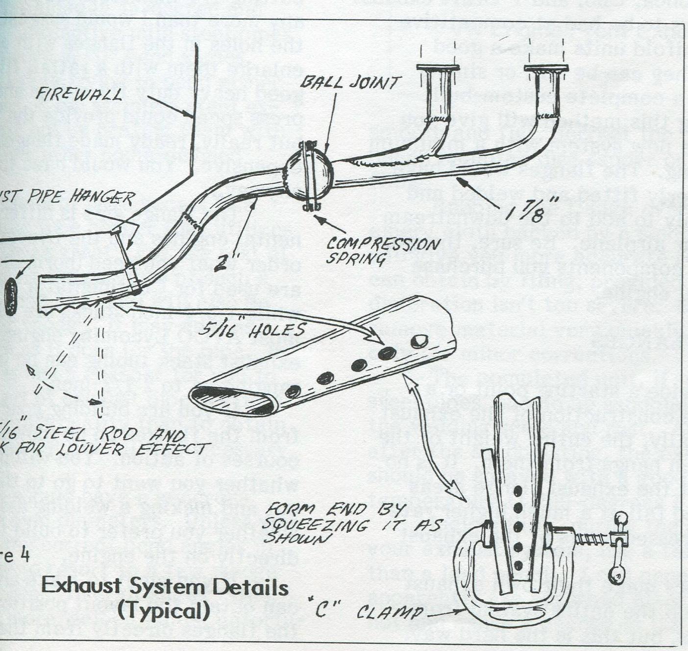

At OSH one year I was looking at a BackYard Flyer with a Generac engine on it. The exhaust was two tubes wrapping around the front of the engine (tractor setup) and if I remember right they used a slip joint to join them.
There was no open end on the tube but a series of small holes aprox. 1/8” diameter drilled in the underside of the tube. This allowed for dispersion of the exhaust gasses to keep the heat down and did a good job of controlling the noise.
I have searched for pictures but have found none in my albums.
Perhaps something like this could be done with the HKS on the FS.
My thought process for experimenting would go something like this.
Get a scale that you can tie to the plane and a solid object to measure thrust.
Start with the existing exhaust since you already have that. Dial the prop in for the proper full throttle static RPM and measure thrust.
Remove exhaust and re-measure thrust. Now you have a couple of baselines to work from.
Install a “mock-up” version welded out of standard automotive exhaust pipe. (cheap and easy to work with). Drill holes of a quantity and diameter that you think would be a minimum required.
Test for static RPM and thrust again and judge the noise made.
Drill more or larger holes as needed to get a design that works for you.
Once all the bugs are worked out to your satisfaction, then take the prototype to a place that can make up a nice one from more durable and hopefully lighter weight material. I understand titanium is wonderful for this kind of thing.
It might take some time dialing it in, but it shouldn’t cost too much to try it.
Just a suggestion, do with it what you wish.
Stuart

Reminds me of this picture in Tony Bingelis' book "Firewall Forward."
