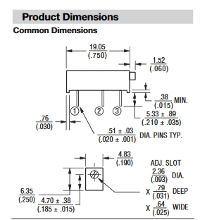

I have several such tools. Usually made
from a screwdriver with an 1/8" blade and
a short piece of .125" i.d. tubing glued
over the end.
An exemplar drawing calls the adjuster
out at just under 0.100" . . .
My guess is that the screw's head is about 1/8" in diameter but that is only a guess. Plus/minus 1/32" would do the trick. Thanks in advance!
