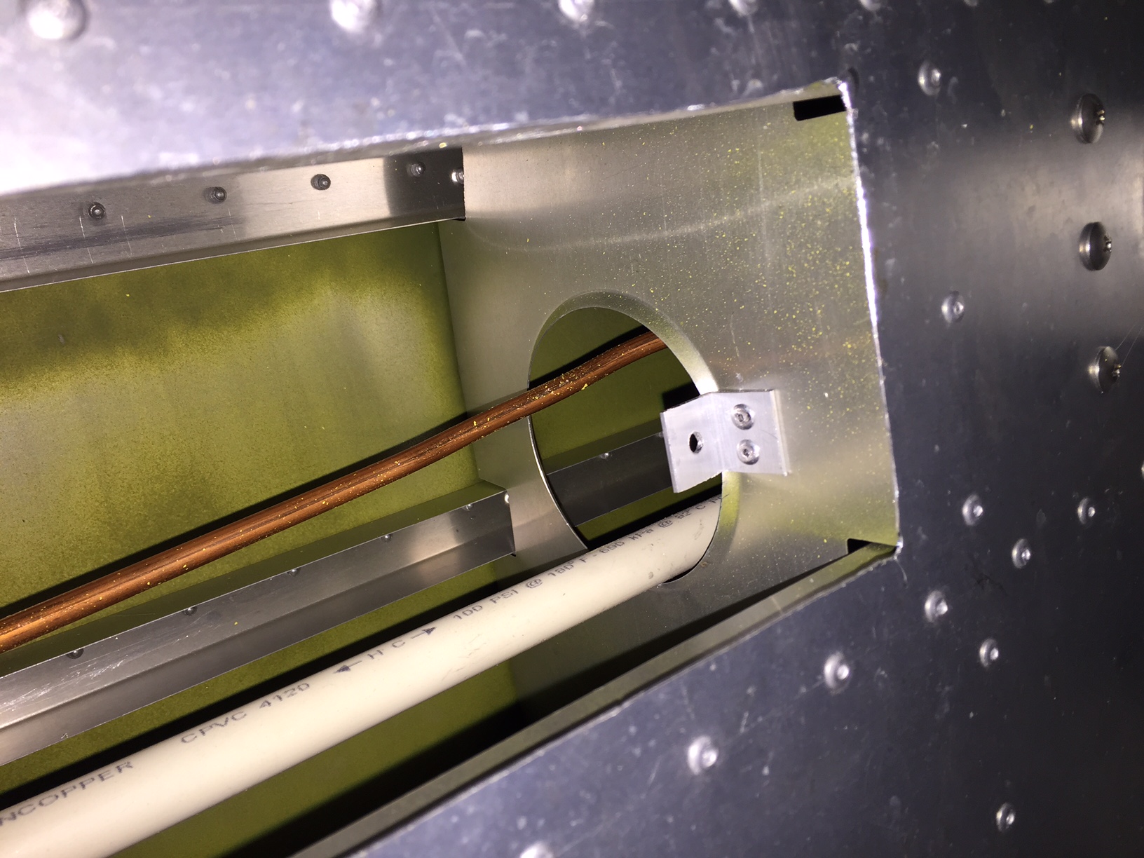

I have to install loom in the wing rib lightning holes. Any recommendations on how to adhere it to the edge of the hole? The loom runs the length of the wing perpendicular to the ribs.

This is how I mounted mine (not an RV-10)
I then used an adel clamp and mounted it to the angle.

How about a dab of pro-seal at each end rib?

Google "suspension clamp". I used the ones from Oatey with 1/2 cpvc pipe.

We did use an electrical PVC pipe.
