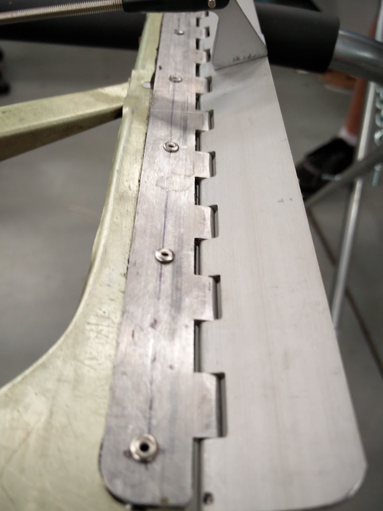

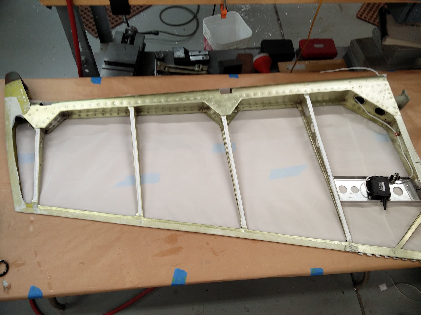

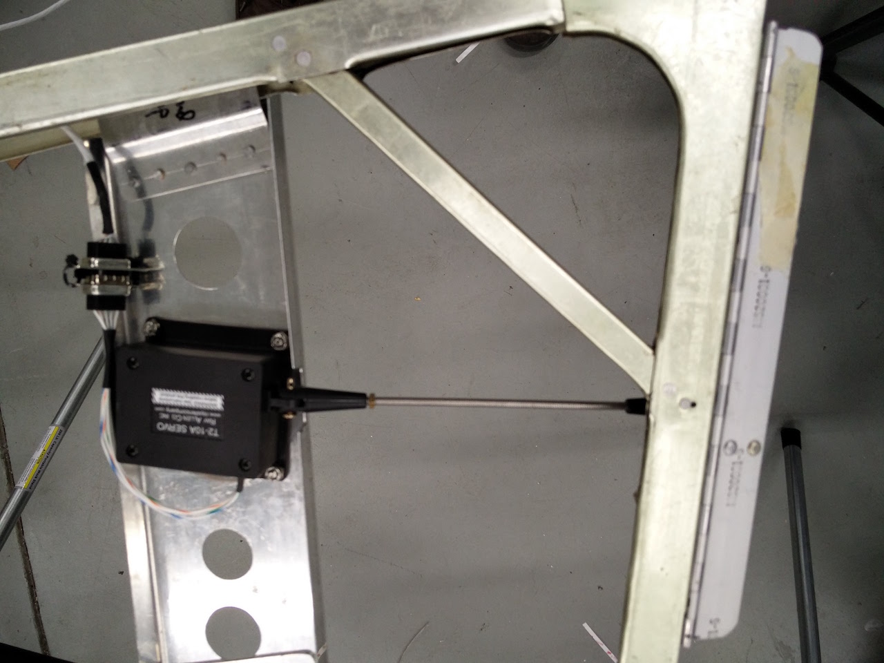

In case anyone is interested, here are a couple pics of the Ray Allen servo I mounted in my CJ rudder.
Stephen
