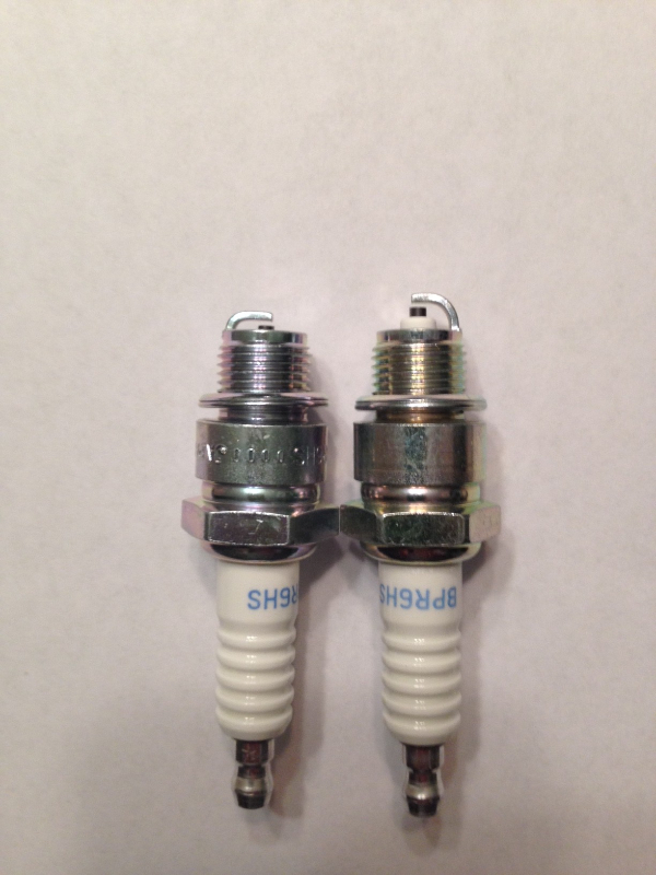

What spark plug are you running?

JS Rittenbach: The TW has the auto spark plug conversion with NGK plugs. I'd have to look through the notes, but we used whatever part number John Shuttleworth told us to when he sent us to the store Smile

We are now shipping the automotive conversion kit with NGK BPR6HS plugs. Gap remains the same at .020. NGK part number is 7022. Essentially the same as the BR6HS (p/n 3022) that we shipped with the kit for years except this plug has an extended tip which places the tip a tiny bit further into the combustion chamber rather than flush with the surface of the combustion chamber just like the original Russian or Chinese plugs and the BR6HS plugs were. This especially helps on the lower cylinders when oil is present. Heat range is the same. Here's a photos of the NGK plugs. The standard BR6HS plus is on the left. BPR6HS extended reach on the right.
[img]cid:314cea3b-9e92-d8f5-e480-2b7897112324(at)yahoo.com[/img]
BTW, this is not something new. In fact in Lycoming and Continental engines, whenever an engine has evidence of fouling, especially on the lower plugs in the cylinders, they recommended using the extended reach version of the plug. Here's a photo of the Champion standard reach and extended reach.

PostPosted: Mon Sep 26, 2016 1:15 pm    Post subject: M14P running very rich at idle, stumbling Reply with quote
Dennis,
Thanks for the post - what is the cost of the kit?
Cheers
Dean
On 26 Sep 2016, at 9:32 PM, A. Dennis Savarese <dsavarese0812(at)bellsouth.net (dsavarese0812(at)bellsouth.net)> wrote:
<NGK Spark Plugs BPR6HS and BR6HS.jpg>

PostPosted: Mon Sep 26, 2016 6:59 pm    Post subject: M14P running very rich at idle, stumbling Reply with quote
$595.00 including shipping and insurance to US addresses. It includes everything needed to facilitate the installation.
Contact me off list if you're interested in purchasing a kit or if you need more information.
Dennis
On Sep 26, 2016, at 5:14 PM, Dean James <dean.james.matthews(at)icloud.com (dean.james.matthews(at)icloud.com)> wrote:
Dennis,
Cheers
Dean
Dennis
