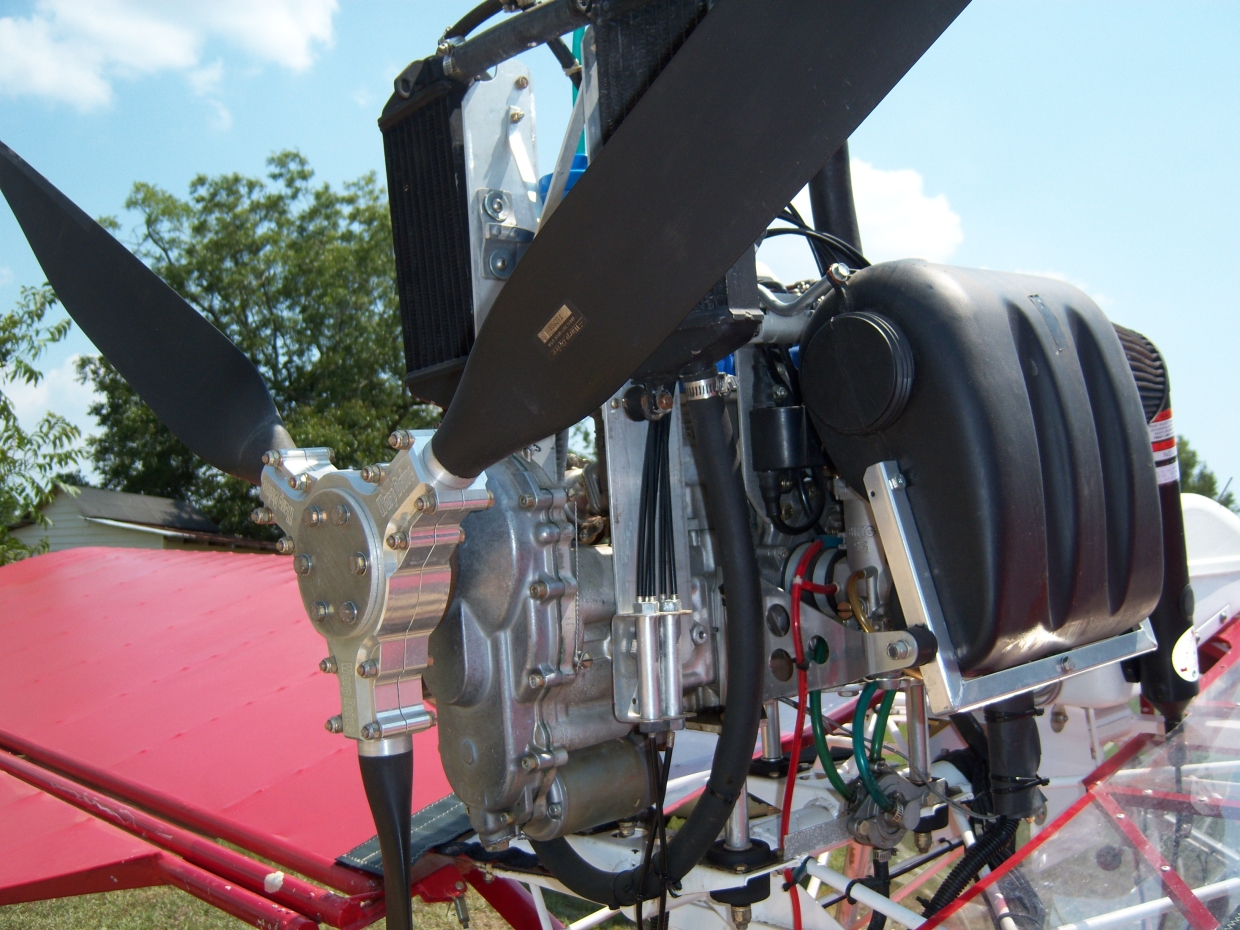

Can Larry C, or Rick Girard, or anyone else who has an HKS engine on their Kolb tell me how they installed it in such a way that the exhaust pipes (where they come out of the cylinders) clears the aileron torque tubes when you fold or unfold the wings??
I am in the process of figuring out the engine mounting on my Firestar. There is a clear and obvious interference, and the only way I can see to completely avoid this interference is to raise the engine up about 6 inches from where it would normally sit on the mount plate.
Also, can anyone on the Kolb list tell me if it is possible or permissible to reverse the cylinders on the HKS, so that the exhaust pipes are on the opposite side from the gearbox? The cylinders are not identical, meaning that there is a left and a right cylinder. But IF it is possible to reverse them (move the right cylinder to the left side of the engine and vice versa), that would also resolve the interference mentioned above. I know I can contact the engie importer and ask this, but since I'm sending this to the Kolb list I figured I'd ask here too.

Bill, I'm attaching the service manual for the HKS. Maybe you can use that to check about the cylinders. As for raising the engine, had something similar on the PfH, see photo, didn't work worth a darn on a mk 3X.

Bill, Did some looking and there's a photo of the engine case on the bottom of page 25 that shows that the cylinders aren't symmetrical on the mounting boss. You'd also have to have a new cam ground to get the valve timing correct.

Mine will clear using the same mounting as for a 503. You just have to hold the ailerons at a certain attitude when you fold, and that is only on the right side. There are different exhaust configurations available, none that I felt moved to explore. You would not like mounting the engine higher than absolutely necessary.

Thank you Larry, I will try that before I start making any changes or modifications or work-arounds. I was indeed trying to keep the engine as low as possible, with the "gearbox low" engine configuration.
It was already obvious to this old washed up model airplane builder that the thrust line being too high will cause problems with performance and handling ! But it is good to hear that my own instinct matched the actual real-world experience of Kolb flyers.
I tried to look up anything in the archives that addressed this problem, and it seems thata a David Bigelow in hawaii had this same concern on his Firestar.

Not to hijack the thread - but why is that 582 in Rick's picture mounted up so high? To clear the starter?

thrust line being too high will cause problems with performance and handling >>
No it doesn`t. This is always a criticism levelled at planes with a higher than usual thrust line. In practice it makes no difference that your normal flying instincts can`t cope with automatically. If you are pushing your speed envelope from high to low, say when you switch from cruise to landing approach speed you may have to re trim but so what, you will have to retrim as the flaps come down anyway. Good luck. Pat

One of my early reduction drive VW configurations I had a rather high thrust line. Flying solo I had to feed in power slowly so that I wouldn't nose over. The first time I flew with a passenger I found I had to reduce power to keep the thrust from overpowering my elevator on takeoff. With a passenger at low air speeds with full power and full up elevator it would not pitch up.  At higher speeds it was just OK. I never.... attempted a go around with a passenger. Actually I never flew with a passenger again in that configuration. I switched fairly quick to the new VW engine mount that significantly lowered the engine. In this case the high trust line was down right dangerous.

Richard, The story, as I remember Travis telling it anyway, is that the last owner before it reached me had the guys in the Kolb shop mount the 582 on stilts for just the reason you ascribed to it. They didn't want to do it but the owner seemed, by the way he did everything else, to have no clue about what such would do to the prop inflow and overall drag. I never flew it that way. I moved the engine backward to clear the starter, changed the Rotax twin radiators to a single one from a Honda Magnum motorcycle, and dumped the intake silencer.
Rick
