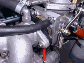

It's the temp probe and (LCD?) readout for a SkyDrive carb heat kit http://www.skydrive.co.uk/proddetail.asp?prod=CH-912-3
The Mk2 kit was milled aluminium with AN fittings and so had room for a drilled hole to take the probe; the current Mk3 kit has copper (brass?) tubing encased in a cast ali body with no room for a probe.
I have the Mk2, but discarded the probe (and standalone readout) in favour of the SkyDrive water temp kit
http://www.skydrive.co.uk/proddetail.asp?prod=WTG-912-3
whose readout can be fed into a Dynon Skyview (other EMSs are available).

My Europa does have a Carb Heat kit fitted, and from Paul's description, it is a Mk.2
I'll change the battery, and have a play with it, but I have already fitted the Water Temperature adapter from Skydrive, and plan to get a Dynon Skyview Panel to monitor, amongst other things, the Water Temp. I understand from elsewhere on the forum that Rotax do not fit a probe for Water Temp, but rely on Cylinder Head Temp for engine monitoring. I would like to keep an eye on the Water Temp, so have used one of the two Cylinder Head Probes for the Water Temp.
This means at present, I will only be measuring CHT at one cylinder. Do other do this, or fit 2 or even four probes, and measure each Cylinder ?
Is there any advantage in having both Water Temp, and Carb Temp (by using this probe ) ?
Sorry for the initial confusion, both photos are of the same device from different angles. If it is self powered via the battery, any idea what the pinout connections are for ?
