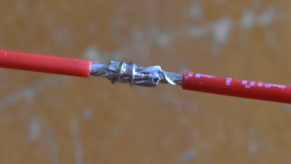

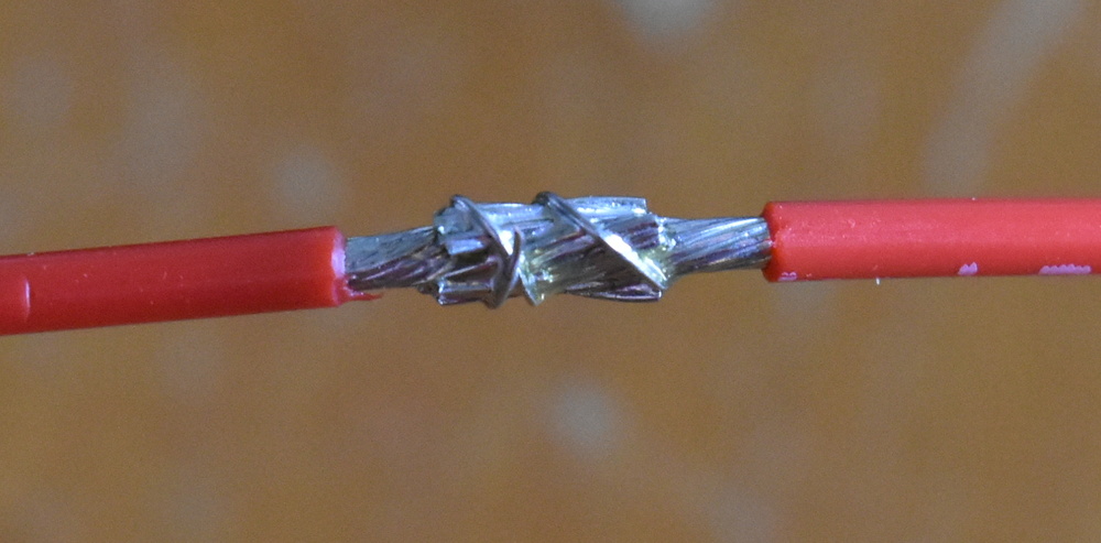

Folks,
Here are my first two solder splices that I plan to put into my airplane. It's 18 AWG wire. Do these look acceptable to you? My tech advisor won't be able to inspect these once I put heat shrink tubing over them so I'm looking for some reassurance here.
[img]cid:ii_iqr27pi90_155fa902b6bade7d[/img]
[img]cid:ii_iqr27pim1_155fa902b6bade7d[/img]
​[img]cid:ii_155fa90551d47825[/img][img]cid:ii_155fa9052360161a[/img]
    -- Art Z.

The soldering looks fine to me, but I'd run my fingers around all the joints to feel for sharp points & edges. Anything you can snag your finger on is likely to eventually poke through the heat shrink. You can snip off any high points with a pair of flush-cutting 'dikes' (diagonal cutters).

Squeeze with pliers any wires that do not lay flat. Wrap with tape first to prevent wires from poking through heat shrink. The heat shrink should be long enough to extend 1/2" beyond the solder-stiffened wire. If the splices are subject to vibration, support the wire on each side of the spice with clamps or ties. Two layers of heat shrink will give additional support and protection.

I think they're fine. Just make sure there are no
sharp whiskers standing off the joints that might
poke through the shrink. I would not wrap with tape
but you could consider a short piece of shrink over
the joint only, then a second that extends 1/2" either
side of the joint cover.
What kind of solder are you using?

I'm not sure what you call that splice. It looks like you pushed the
wires together then wrapped it with a piece of solid wire then soldered it.
I like the Western Union splice for inline soldered splices. The splice
is mechanically strong even without solder. They really won't come apart
under a pull. They are fairly compact and uniform. Best of all they're
pretty easy to do even in a tight space.
The Western Union (or Lineman's Splice) will work with solid or stranded
wire and it seems to be a favorite with serious wiring folks.Bill Putney - WB6RFW

I think what he did is described in the Connection book. Reality is, that most of the old school 'make a mechanically strong joint then solder it' philosophy is really massive overkill. The only real advantage is keeping the joint area stable while the solder cools.
Try just overlapping 2 wires in parallel about a half inch & solder. Then try to pull them apart. If you soldered the joint properly, the insulation will fail before you can separate the wires.

Not a recommended "type" of splice, but, if it never is under tension, and a couple layers heat shrink, should be OK.
Like others have suggested the famous Western Union splice is top of the list for best methods.
Dave

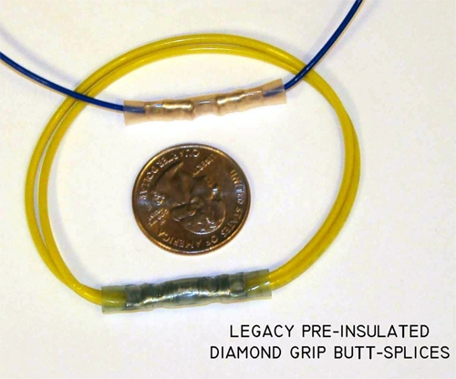

The 'western union' splice has a rich
place in history. A time when thousands
of miles of wire were being strung between
poles . . . first for the telegraph then
for telephone and power distribution. It
had the advantage of placing the touching
surfaces of the two conductors under tension
that was a natural consequence of suspension
on poles. That tension translated into a
lot of pressure which went to the electrical
integrity of the join . . . solder was sometimes
added to add environmental integrity by
encapsulating the joint.
Unless you're suspending wires over substantial
spans, there's no value added for fabricating
that kind of joint. But for many decades, gas-tight,
insulation supporting spicing techniques became
the technique of choice
[img]cid:.0[/img]
But back about 1975, I think it was a company
called RayChem who offered a series of devices
to attach wires but with solder only . . .
no mashing necessary.
http://tinyurl.com/ju4gvvg
Like the open-barrel, sheet-metal pins in
Mate-n-Lok/Molex connectors, this new idea raised
some eyebrows . . . but the technique proved
quite effective for wires not suspended between
telegraph poles.
The joining technology is simple . . . lap
soldered joints covered in some form heat
shrink. I used to sell solder-sleeves. I sold
off my residual inventory a couple years ago
but I still have a few hundred such devices
in my skunk-werks parts drawers.
Unfortunately, these devices, like the various
PIDG devices, have range limits for the number
and sizes of wires they'll effectively join.
But taking clue from the soldered and protected
lap joint offered by RayChem, I crafted this
article that recycled the idea in another market.
http://tinyurl.com/gwx3q9t
There's no good reason that this simple joining
technique cannot be put to good use on our
airplanes. NASA uses Solder Sleeves. A little
solder and heat-shrink offers an opportunity
to do shade-tree clones.
The only thing I would suggest for Art's
craftsmanship
[img]cid:.1[/img]
is to simply lay the two stripped ends parallel
to each other without 'interleaving' the strands.

Will do, Bob. I probably spent as long trying to get the strands to interleave nicely that everything else combined. I'm not happy with how it worked since there are lots of sharp ends sticking up.
Thank you, everybody!

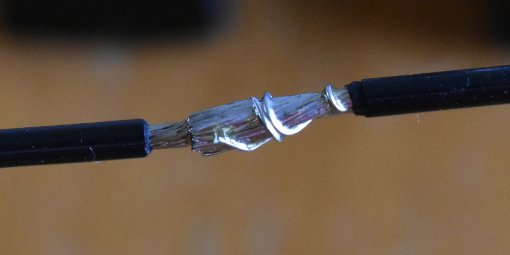

Once again, thank you for your advice. I passed a minor milestone in my airplane project on Monday evening, building the first wiring components. I cut off the two splices that I showed you earlier, where I had interleaved the strands. I redid them from scratch. See photos at the bottom of this page on my blog: https://cheerfulcurmudgeon.com/2016/07/19/physical-electrical-considerations-when-mounting-avionics/

I redid them from scratch. See photos at the bottom of this page on my blog:Â https://cheerfulcurmudgeon.com/2016/07/19/physical-electrical-considerations-when-mounting-avionics/
Look'n good! Know what you mean about the heat . . .
