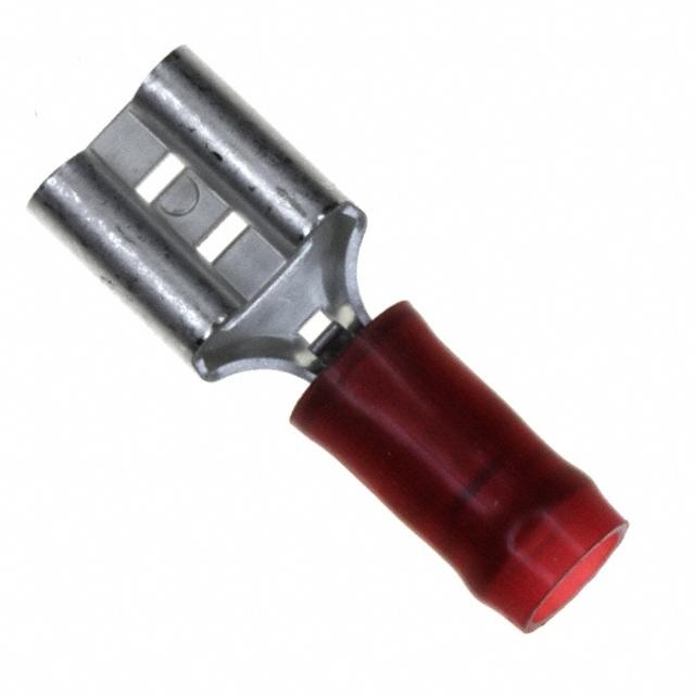

Moving from the middle of the wire to the end... I want FastOn terminals. Since I am soldering other stuff, I have no qualms about soldering here, too. Is this the right part?
[img]cid:ii_iquwkxke0_156086a60c5b11fd[/img]
Do I crimp then solder then cover with heat shrink? Which crimper tool? Or should I do something else entirely?
Is 0.250 inch the right size or should I wait until I buy my fuse blocks and switches to be sure?

A concern with terminals, whether crimped or soldered, is the wire breaking from vibration. Most people crimp terminals because it does not make the wire stiff, which will lead to eventual breaking. However, a terminal can be soldered as long as the solder does not wick under the wire insulation. The terminal should clamp around the wire insulation. Heat shrink may be added for more support.
Joe Gores

.250 is the 95% common choice but
why not these terminals?
[img]cid:.1[/img]
You can find them on Digikey at http://tinyurl.com/hkws5dw
These are the premium fast-on parts.
The terminals you've cited can be installed with the
B&C open barrel crimp tool http://tinyurl.com/hxa9wey
This article speaks to the technique for using the two-crimp
tool on sheet metal pins http://tinyurl.com/9c444zm
