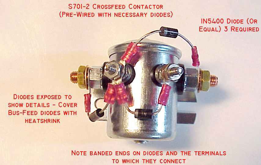

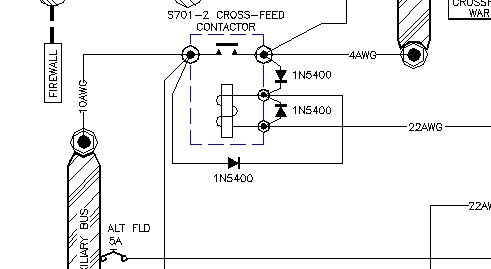

At 05:20 PM 7/14/2016, you wrote:
Do the banded ends of the diodes connect to the positive side of the coils? If so, OK. I can not tell from the picture.
The S701-1 and -2 contactors START with the same,
4-terminal, off-the-shelf device. When used as a
S702-2, bus tie contactor the schematic looks like this
excerpt from Z-14. TWO diodes provide power to
energize the contactor from either bus . . . this
insures that you can get the cold bus connected to
the hot one no matter which is which. The THIRD
diode is the legacy coil suppression device.
[img]cid:.0[/img]
A photo of the as-aSsembled product from B&C
looks like this:
[img]cid:.1[/img]

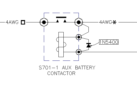

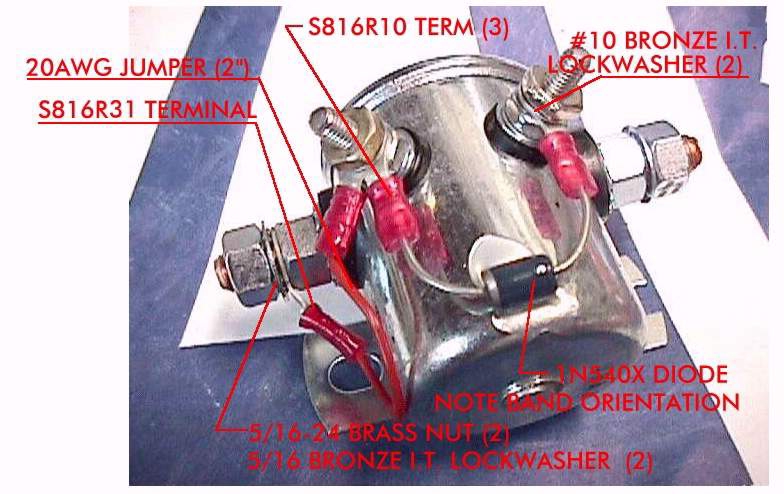

The S701-1 contactor is for more rudimentary tasks
like battery contactors. Here you only need the coil
suppression diode and the schematic looks like this:
[img]cid:.2[/img]
And the finished product looks like this
[img]cid:.3[/img]
